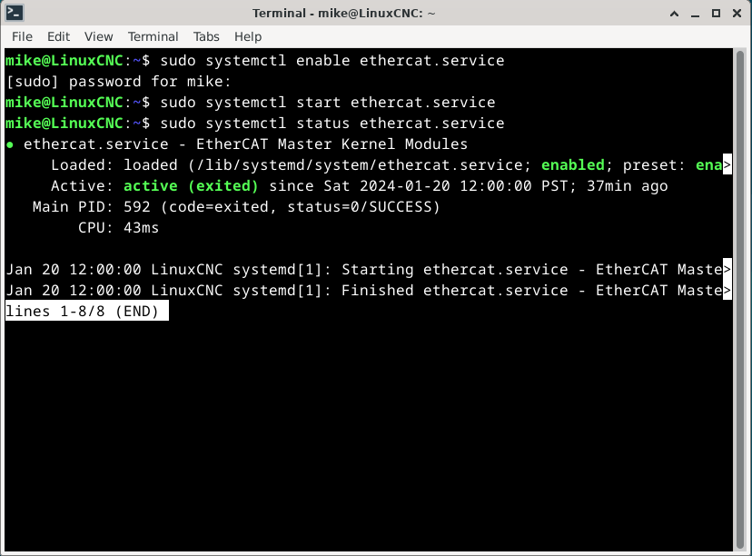

2a) I believe Ethercat is running. Here is a picture.

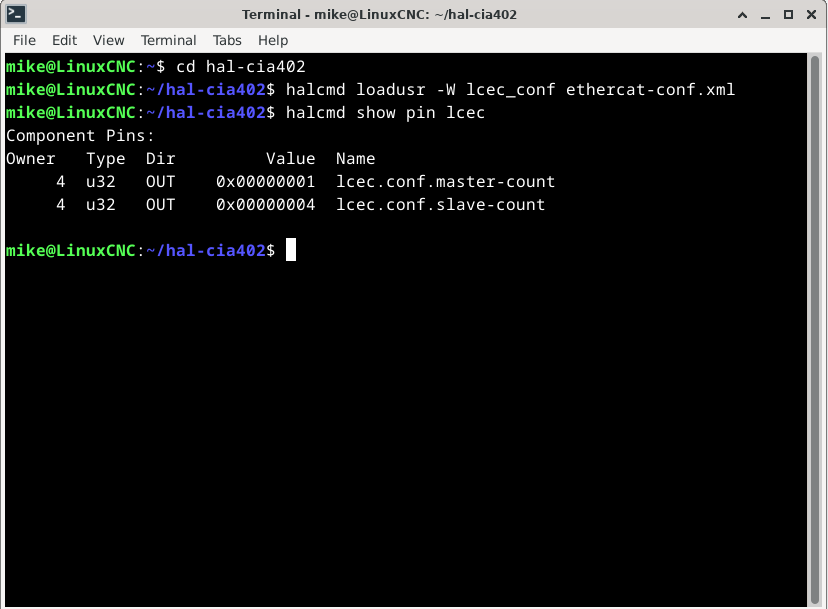

3) Then I followed these steps:cd ~/dev
git clone github.com/dbraun1981/hal-cia402
cd hal-cia402
sudo halcompile --install cia402.comp
Which I tested with the following results

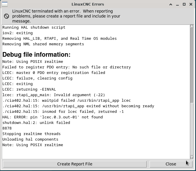

5) I opened LinuxCNC and chose the cia402 configuration, which led to the following error report (attached as linuxcnc1.txt)

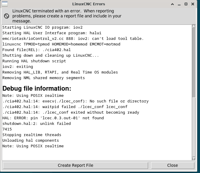

6) I took a shot at fixing a problem by changing line 14 of cia402.hal from
loadusr -W ./lcec_conf ethercat-conf.xml
to
loadusr -W lcec_conf ethercat-conf.xml
which generated the following error report (attached as linuxcnc2.txt)
