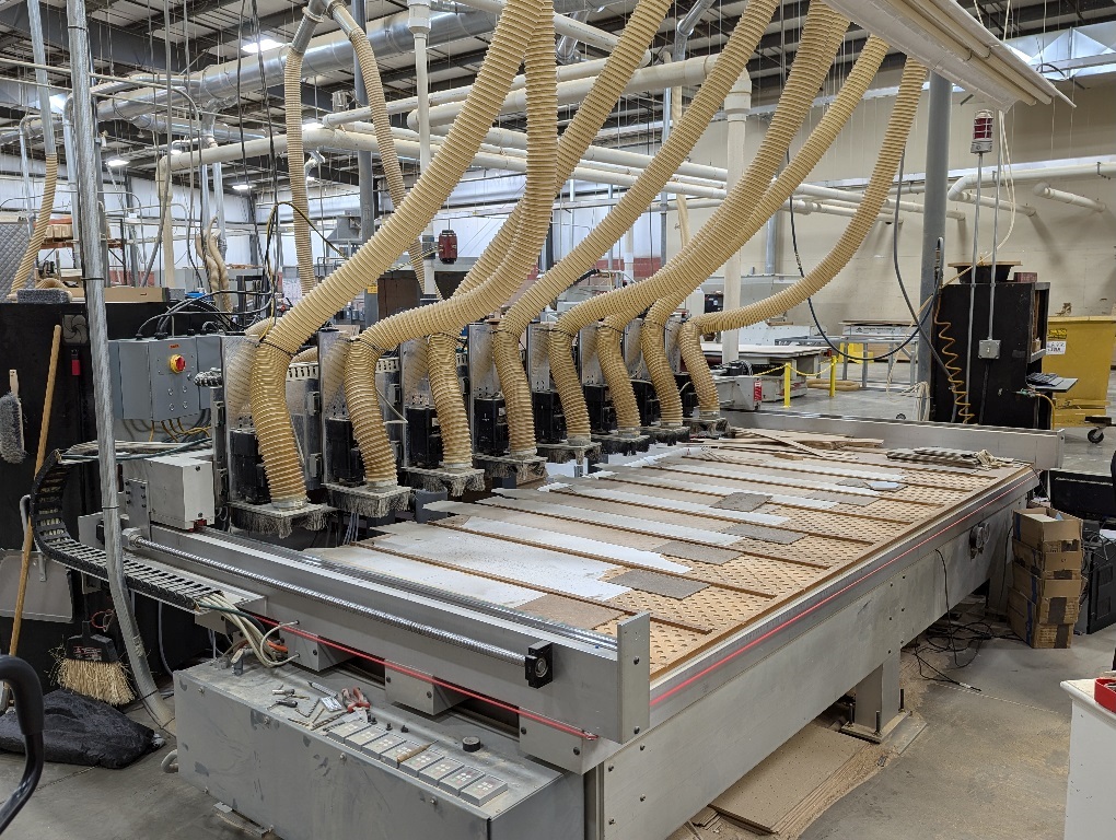

The oddest machine I have under Linuxcnc control is an 8 spindle gang router with 8 separate Z-axis and spindles mounted on a 12ft long gantry (11 joints of movement).

- Todd Zuercher
- Posts: 4794
- Thank you received: 1482
22 Aug 2024 14:09 - 22 Aug 2024 14:18 #308428
Replied by Todd Zuercher on topic What's the Oddest Machine You Have Powered with LinuxCNC
Last edit: 22 Aug 2024 14:18 by Todd Zuercher. Reason: Had a bit of trouble getting the picture to work right.
The following user(s) said Thank You: RotarySMP, tommylight, pommen, rodw, my1987toyota, spumco

23 Aug 2024 03:33 #308446
by mighty_mick
Replied by mighty_mick on topic What's the Oddest Machine You Have Powered with LinuxCNC
Hi Todd, can you explain what does this machine do? I didnt understand.

26 Aug 2024 08:19 - 26 Aug 2024 08:32 #308702
It is used for decorative wood carving (signs, plaques...). Carving 8 pieces at a time. Originally it only had a single Z axis. with a hand screw for fine adjustment of each spindle height. This was difficult to maintain and adjust the Z depth between each spindle for varying material thicknesses or when changing tools. So I recently rebuilt the machine with a separate closed loop stepper motor, ball screw and linear guides on each spindle. I also replaced the old single servo, 12ft torque tube, rack and pinion drive system for the Y axis with new larger linear ways, two ball screws and 2 servos. Then after doing all of that work I found out that the majority of the slop in the old system wasn't due to compliance in the old drive train, but fex in the bridge. So I stiffened the bridge, and it is greatly improved. (The X also got new ways, and replaced a belt driven lead screw with a direct drive ball screw and added tool touch probe and probing routine.)

26 Aug 2024 12:53 #308723
Coincidentally that machine was also the very first machine I ever setup/retrofitted to run Linuxcnc (EMC2 at the time) and it has been running it the longest. But back then it started out as a simple 3 axis control with 3 step/dir commanded servos using software stepgens and no control of the VFDs. (The operator had to manually start/stop the spindles/VFDs.)
Then few years later I added a Mesa 5i25/7i85S combo, to add encoder feedback to close the position loop in Linuxcnc and fast hardware step-generation. Soon after that I used Mb2hal, to add control of the 8 spindle VFDs to Linuxcnc.
I have nearly a 20yr history with this machine since we bought it new, with more than half of those years running EMC2/Linuxcnc.
