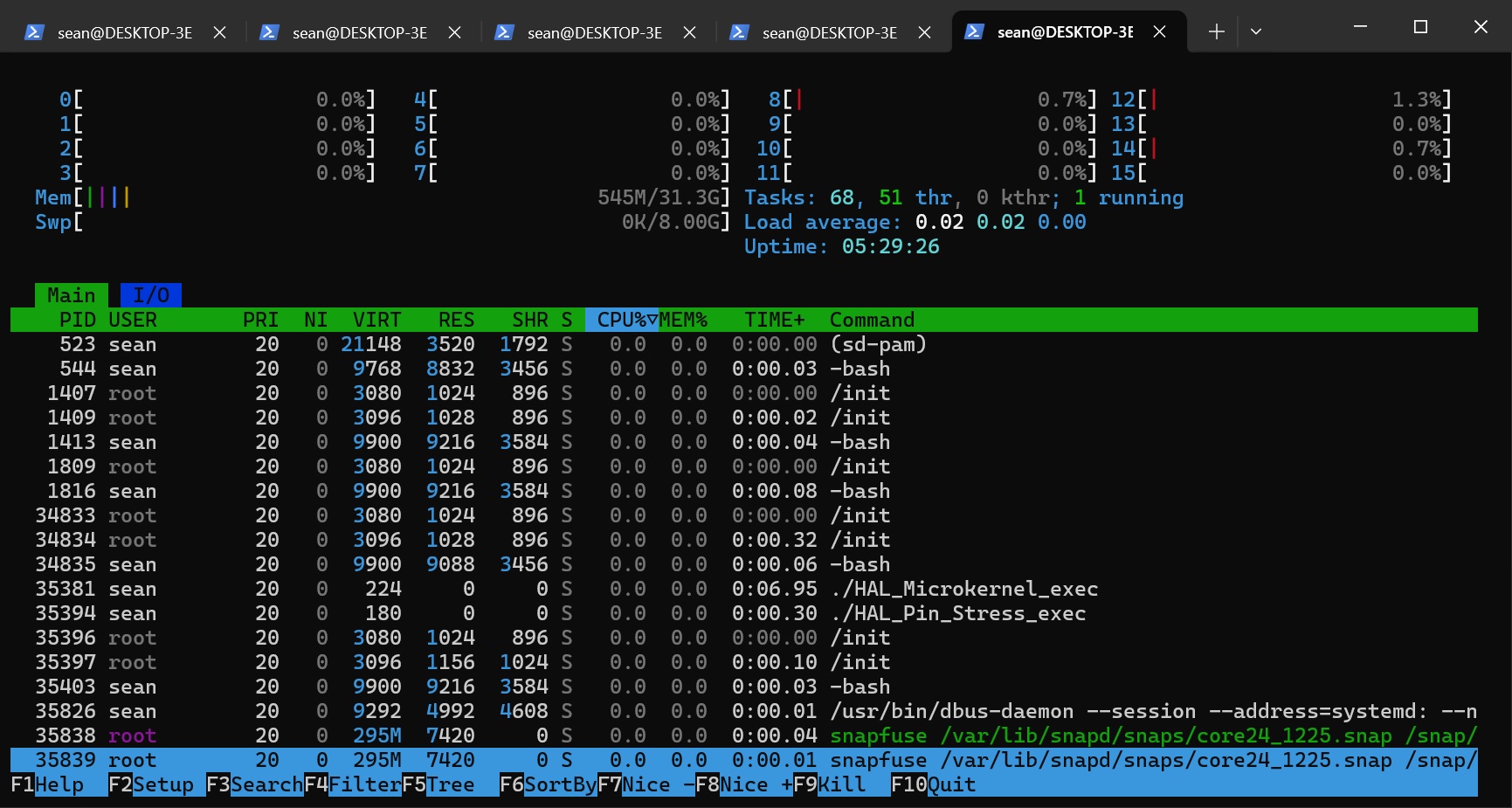

Heads up this is ALPHA only CODE !!!!! ALPHA !!!!!!!!!! . I sat down this morning and rewrote my initial post. I was tired so here is the edited post containing all my thoughts. NO WARRANTY OR FITNESS IS IMPLIED OR GIVEN USE AT YOUR OWN RISK !!!!! AiLang & Microkernel Architecture for LinuxCNC – License Grant & Technical OverviewBackground & Motivation
What is Ailang ?
Ailang is a bijective x86 direct to assembler compiled language. It emits elf files directly, does not depend on LLVM GCC CLANG etc.
github.com/AiLang-Author/AiLang
github.com/AiLang-Author/CoreUtils-
I originally built AiLang for my internal AGI and LLM research—it was designed for low-level systems programming. The problem it solves for LinuxCNC is simple: writing complex HAL components in C with the current RTAPI is a nightmare. You can't use normal control structures (while, sleep, delay, etc.) or blocking calls without risking realtime violations or outright kernel crashes. Anything beyond trivial I/O explodes into hundreds or thousands of lines of manual state counters, one-shot flags, hand-rolled timers, and flood-controlled error messages.The toolchanger.comp I had to write is the perfect example. Here's what that looks like in practice:Old way (classic .comp):
AiLang was designed from day one with explicit, verbose syntax that's unambiguous for both humans and LLMs—no operator precedence mysteries, no implicit type coercion, no hidden control flow. Every operation is a named function call or a parenthesized infix expression, which means code generation is deterministic and debuggable. That verbosity is the entire point: when an LLM seesAdd(a, b)
or(a + b)
, there's zero ambiguity about what's happening. When you're debugging a toolchanger at 2 AM, that clarity matters. The compiler generates native x86-64 assembly with zero runtime overhead—no interpreter, no VM, no garbage collection. Early benchmarks show AiLang-compiled utilities outperforming GNU coreutils in typical use cases (100-5000 line files, the sweet spot for source code and config files), and this is before any serious optimization work or SSE vectorization. The toolchanger microkernel compiles to an 18 kB binary that runs for days without issues.
Microkernel Architecture for Hal Components The solution: move everything that isn't cycle-critical into normal Linux userspace processes, leaving only a tiny shim in the realtime thread. Here's what's actually running on my bench right now:
HAL_Microkernel daemon (~600 lines AiLang → ~18 kB binary)

- Microkernel daemon: stable under load, runs for days without issues
- Toolchanger logic: Tech Demonstrator, full bidirectional cycles with fault injection pass in simulation
- Realtime shim: alpha testing (~150 lines C, nearly complete)
- Hardware validation: Next step is testing on actual machine hardware
- Known limitations: Pin collision detection not yet implemented (coming soon)
I have attached a zip file with my current working code, the ailang compiler is very easy to use. If you have any questions post them up this is the first public disclosure of the language I have made. Feedback welcome.
