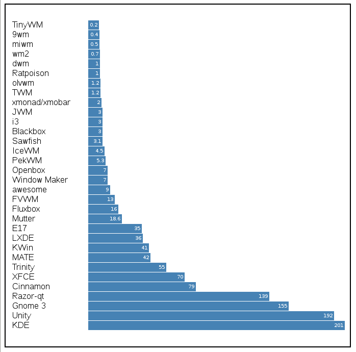

11 Nov 2014 15:38 - 11 Nov 2014 16:48 #53007 by ArcEye
Replied by ArcEye on topic Changing Desktop Manager in Debian Wheezy
When I log off and try and login with LXDE it want's a password but I've not set one for it. I can't even login to my XFCE with my password so I rebooted.
I always use a password login, if you had it set for auto login, I imagine that does not persist across window managers.
If you can't log in even with the correct password you probably need to reset it
After XFCE loaded I got and Error GDBus.Error:org.freedesktop.PolicyKit1.Error.Failed: An authentication agent already exists for the given subject.
JT
Caused probably by an interaction between the 2 installed wm's
I have never had it, but have never gone back to xfce after installing lxde.
This covers the error message and getting rid of it.
www.blackmoreops.com/2013/11/19/fix-gdbu...i-lmde-debian-linux/
I experimented with a few other WM's yesterday, but aside from iceWM, which still has a bug which prevents display of Qt5 apps, I still prefer lxde.
This is a chart of the relevant memory usage for all the main WM's
regards
Last edit: 11 Nov 2014 16:48 by ArcEye.
