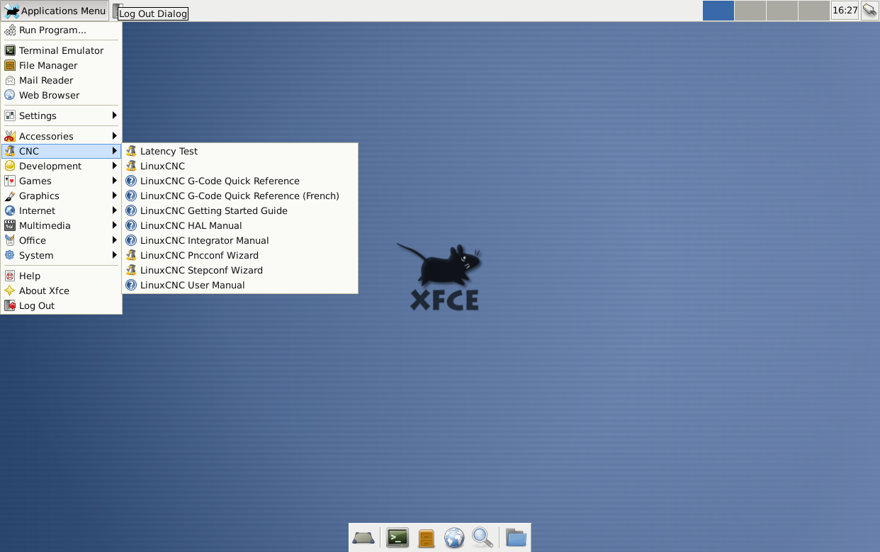

Today I decided to update with a fresh install but I couldnt get Linuxcnc to work. I have been running Linuxcnc on Lucid for years now without any issues.
First I tried live-cd and i noticed that latency values did not change (everything 0). I taught it was because I was running liveCD so I installed Linux on HDD but the same issue appears. If I try to run linuxcnc (even on a sim machine) it will say USRMOT: ERROR: command timeout.
Did i miss something?

The problem was that I had the CMOS date set to 2099.
I also had to remove loadrt probe_parport from the old configuration

I just installed from 2.7 wheezy and I can not find LinuxCNC anywhere. They OP system installed great, but I can not find the machine controller

Yeah installed off the ISO, its not there. I downloaded again to make sure something was not corrupted and I am trying again.

something screwed up the first time its running now.
Replied by Jake on topic Fresh install linuxcnc-2.7-wheezy does not work
