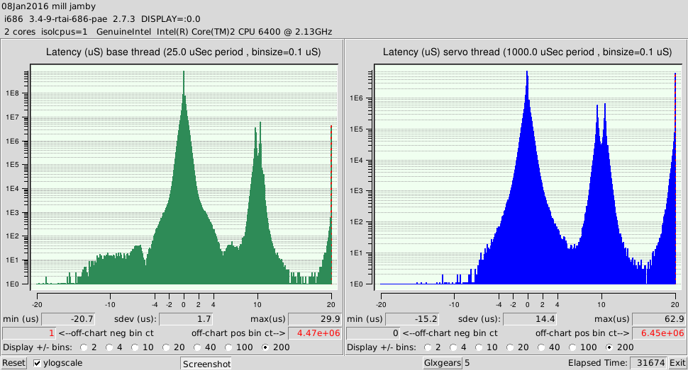

Hey,
Computer: Dell Optiplex 745 no video card.
Linuxcnc: 2.7.3 wheezy from CD
Cards: 5i25 to 7i77 external power from computer to 7i77 leds lit.
Dmesg:
bottom of which says:
[ 166.939516] RTAPI: ERROR: Unexpected realtime delay on task 1
[ 166.939519] This Message will only display once per session.
[ 166.939520] Run the Latency Test and resolve before continuing.
[ 166.939637]
[ 166.939638] In recent history there were
[ 166.939639] 78048, 31920, 62728, 62752, and 63168
[ 166.939640] elapsed clocks between calls to the motion controller.
[ 166.939644] This time, there were 65624 which is so anomalously
[ 166.939645] large that it probably signifies a problem with your
[ 166.939661] realtime configuration. For the rest of this run of
[ 166.939662] LinuxCNC, this message will be suppressed.
[ 166.939663]
[ 166.940687] hm2/hm2_5i25.0: Smart Serial port 0: DoIt not cleared from previous servo thread. Servo thread rate probably too fast. This message will not be repeated, but the hm2_5i25.0.sserial.0.fault-count pin will indicate if this is happening frequently.
[ 166.941461] hm2/hm2_5i25.0: Smart Serial Comms Error: There have been more than 1 errors in 10 thread executions at least 200 times. See other error messages for details.
[ 166.941465] hm2/hm2_5i25.0: ***Smart Serial Port 0 will be stopped***
This happens as soon as I select the config file and press OK
Sorry but I don't know what to make of this error
Base Jitter was set to 30,000 in PNCconf.
Photo of latency
Hal and Ini files
Any Help Appreciated.

Replied by PCW on topic RTAPI: ERROR: Unexpected realtime delay on task 1
Your servo thread is way too fast
A typical servo thread rate for a velocity mode servo drive is 1 KHz (= 1000000 ns)

Replied by jamby on topic RTAPI: ERROR: Unexpected realtime delay on task 1
PCW
Did as you said. Now it works.
Thank you
Jim
