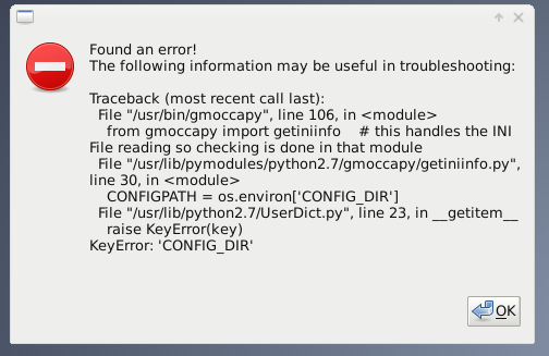

It would appear to me that you are missing an environment variable that tells LCNC where to look for your config files. So set an environment variable called CONFIG_DIR
Without it, by default, its probably trying to look in your home directory somewhere for a non-existent directory

Does axis run?
Replied by bevins on topic gmoccapy won't run
Hi I'm new to linuxcnc and have it running on a thumb drive.
When I try to run gmoccapy I get the error I have attached a screen shot of.
Any help would be appreciated

Thanks for your reply, as I'm new to this I don't know exactly were to post these things yet.
I'll try to look for the CONFIG-DIR and see whats up.
