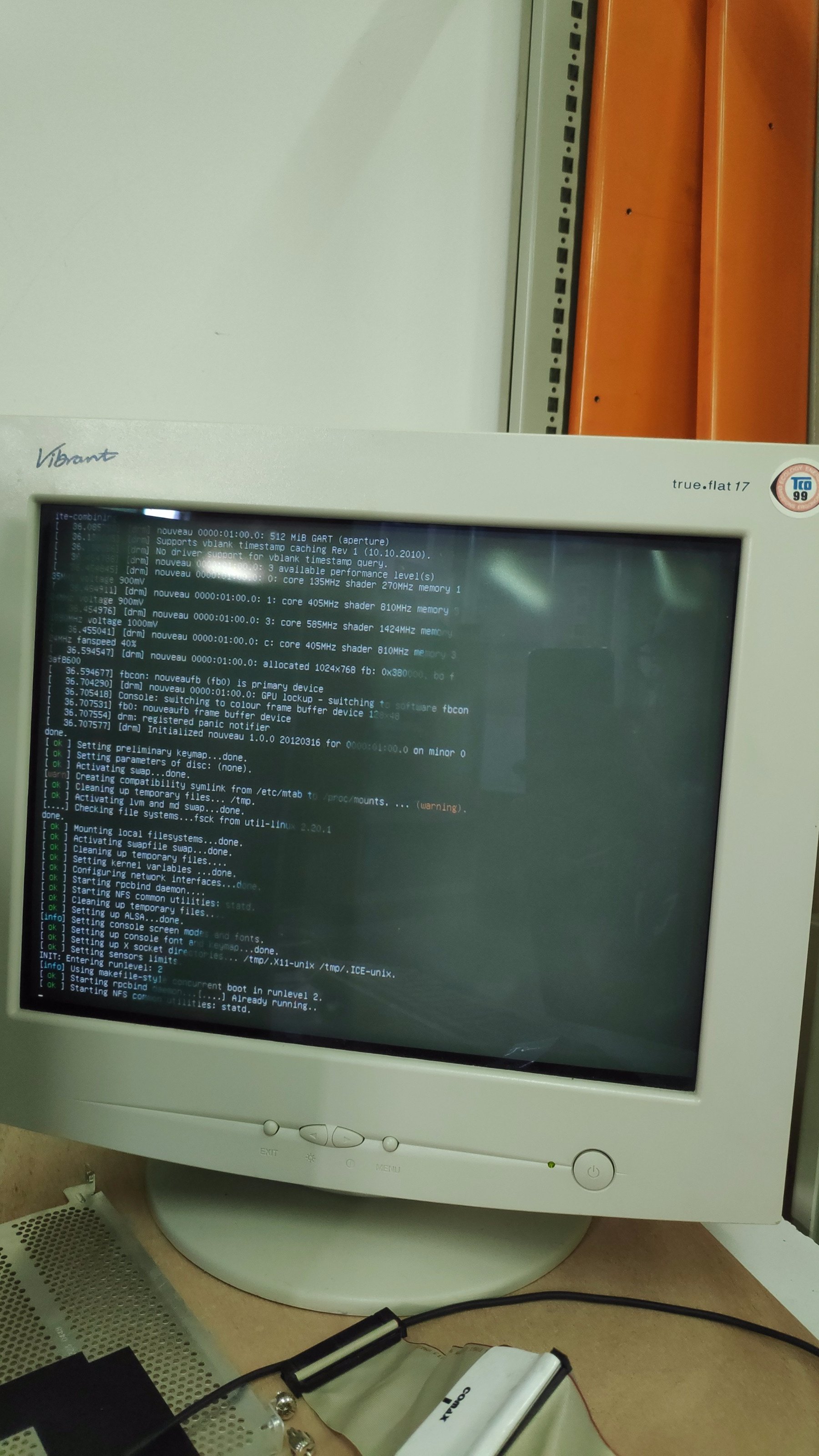

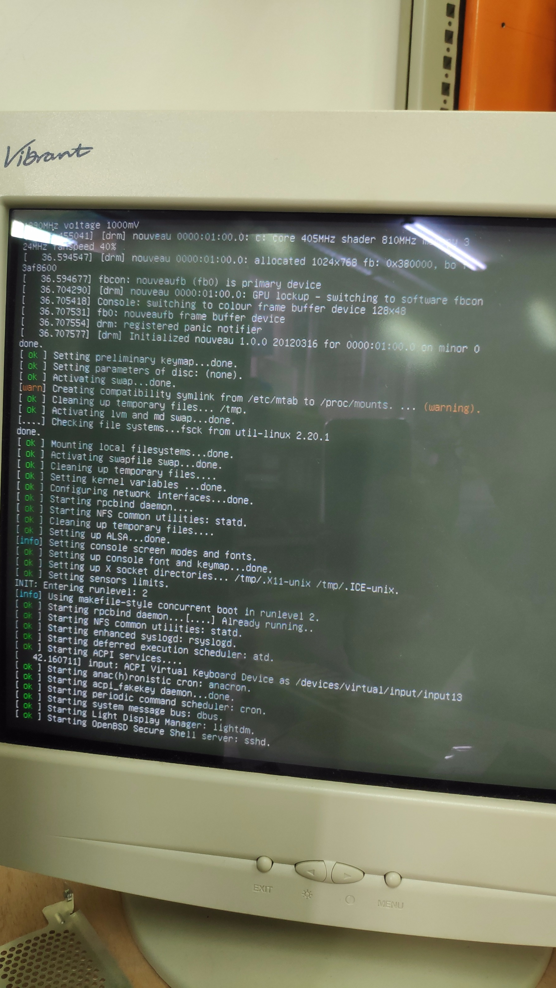

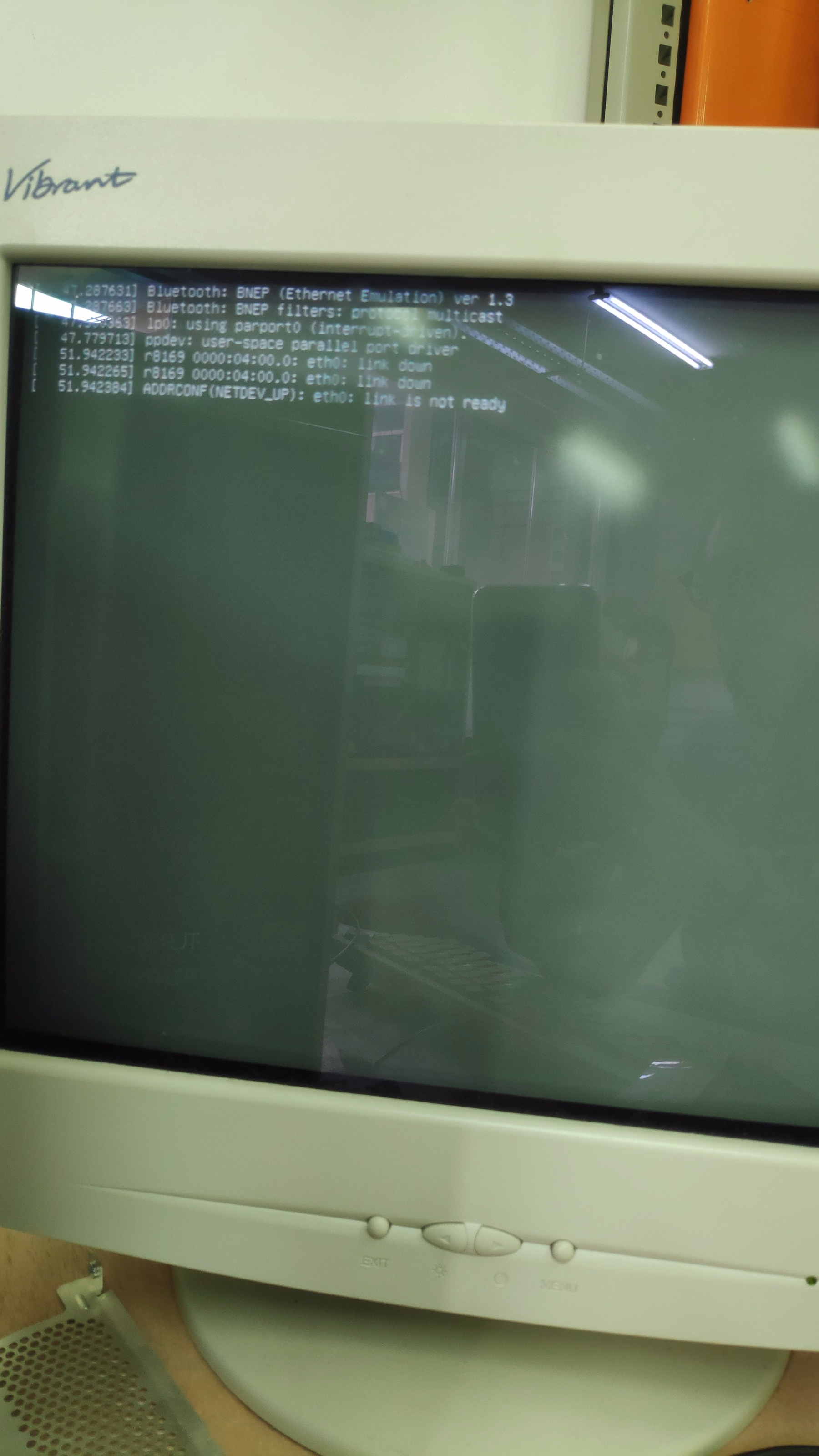

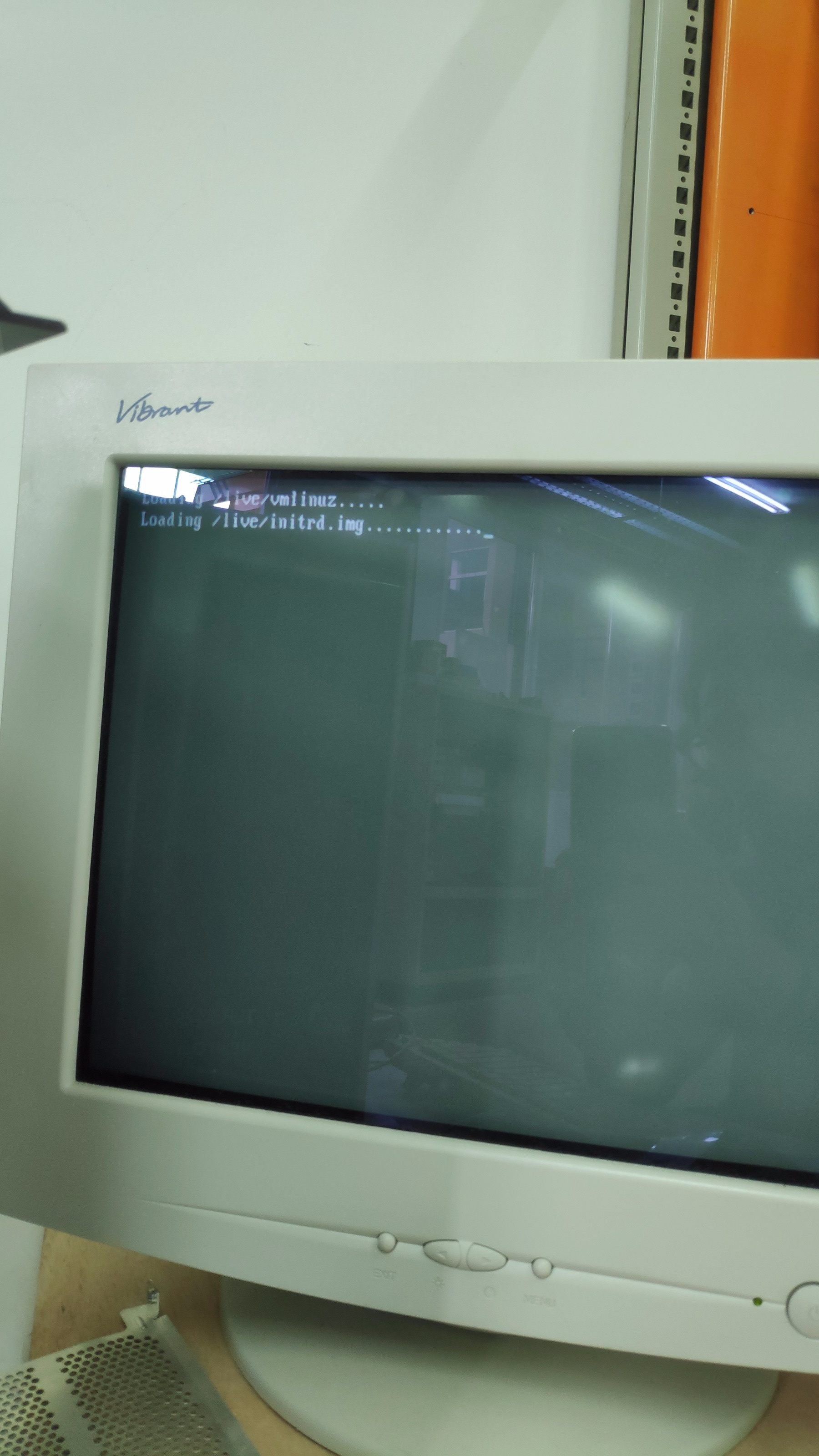

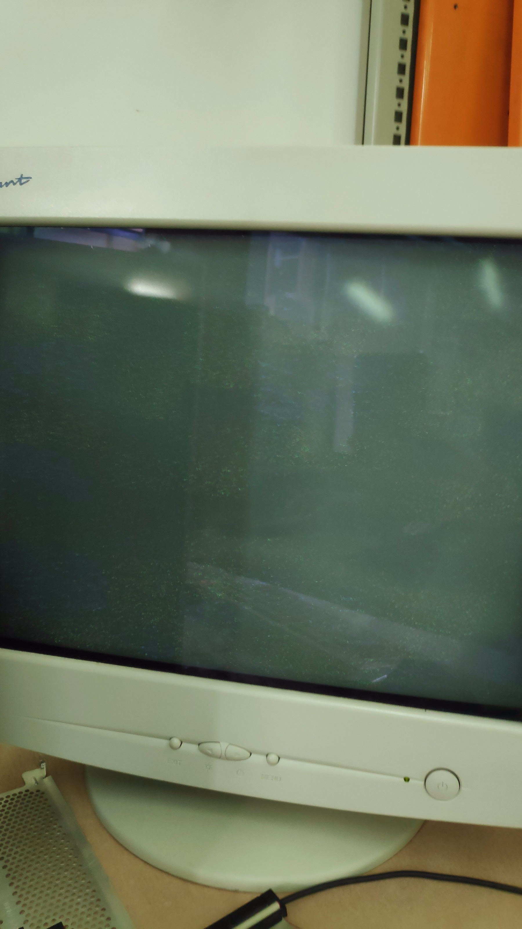

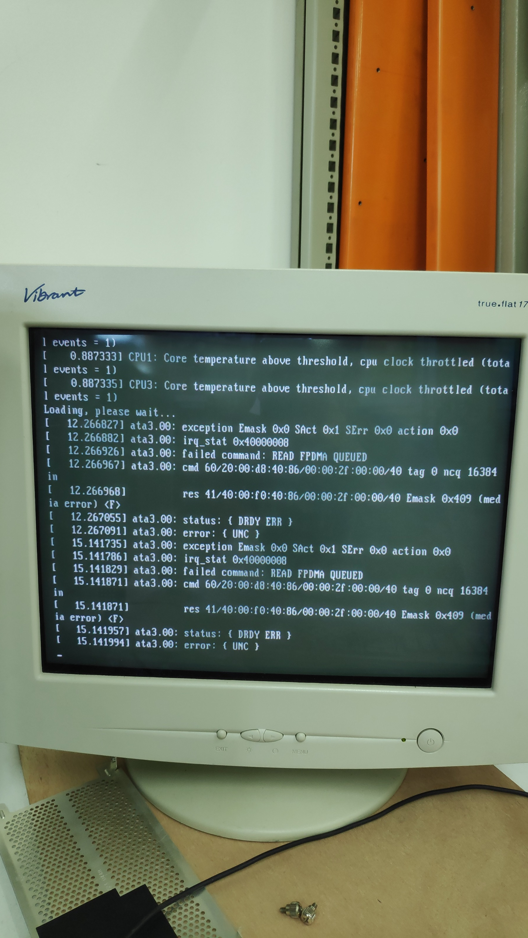

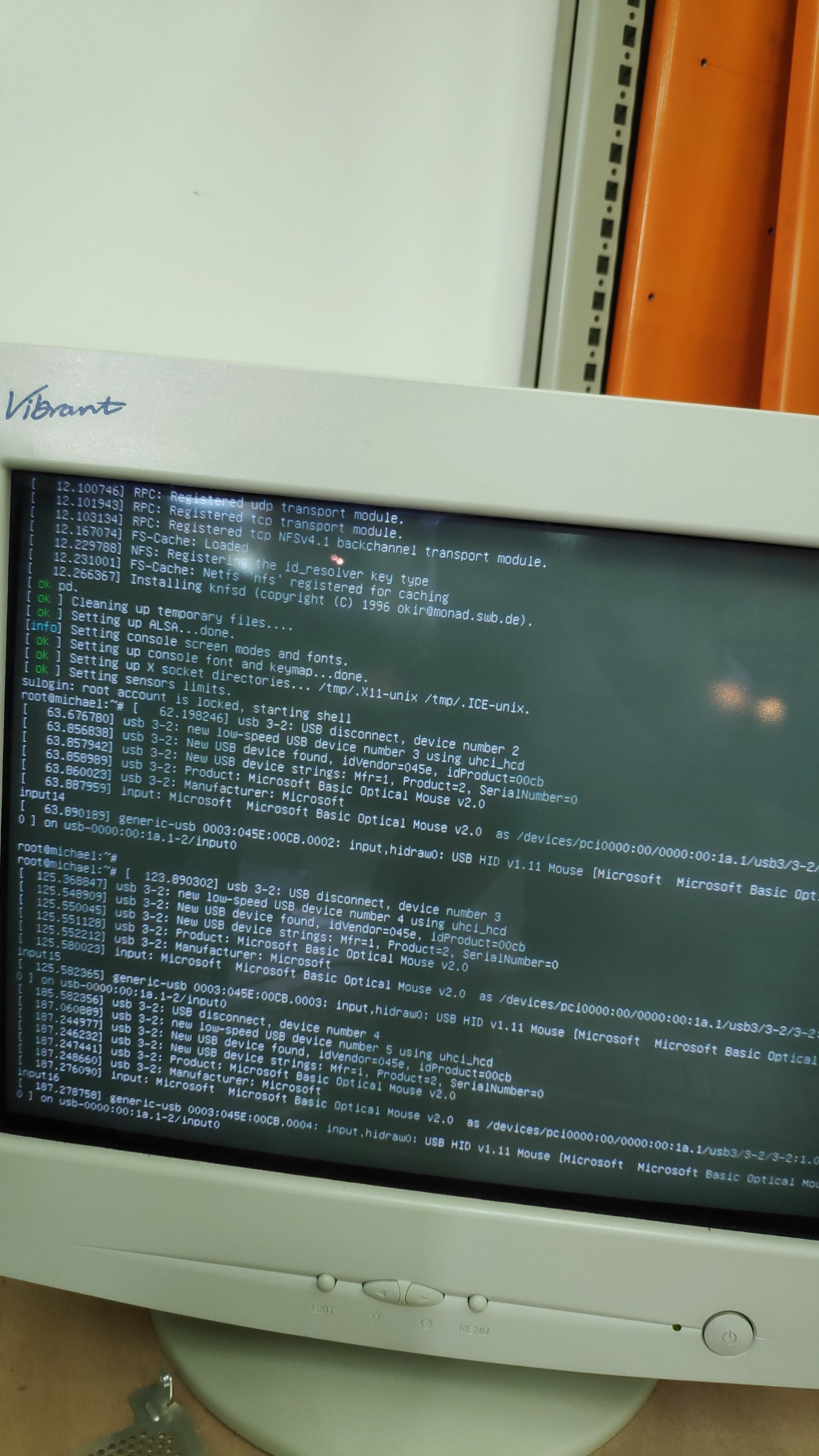

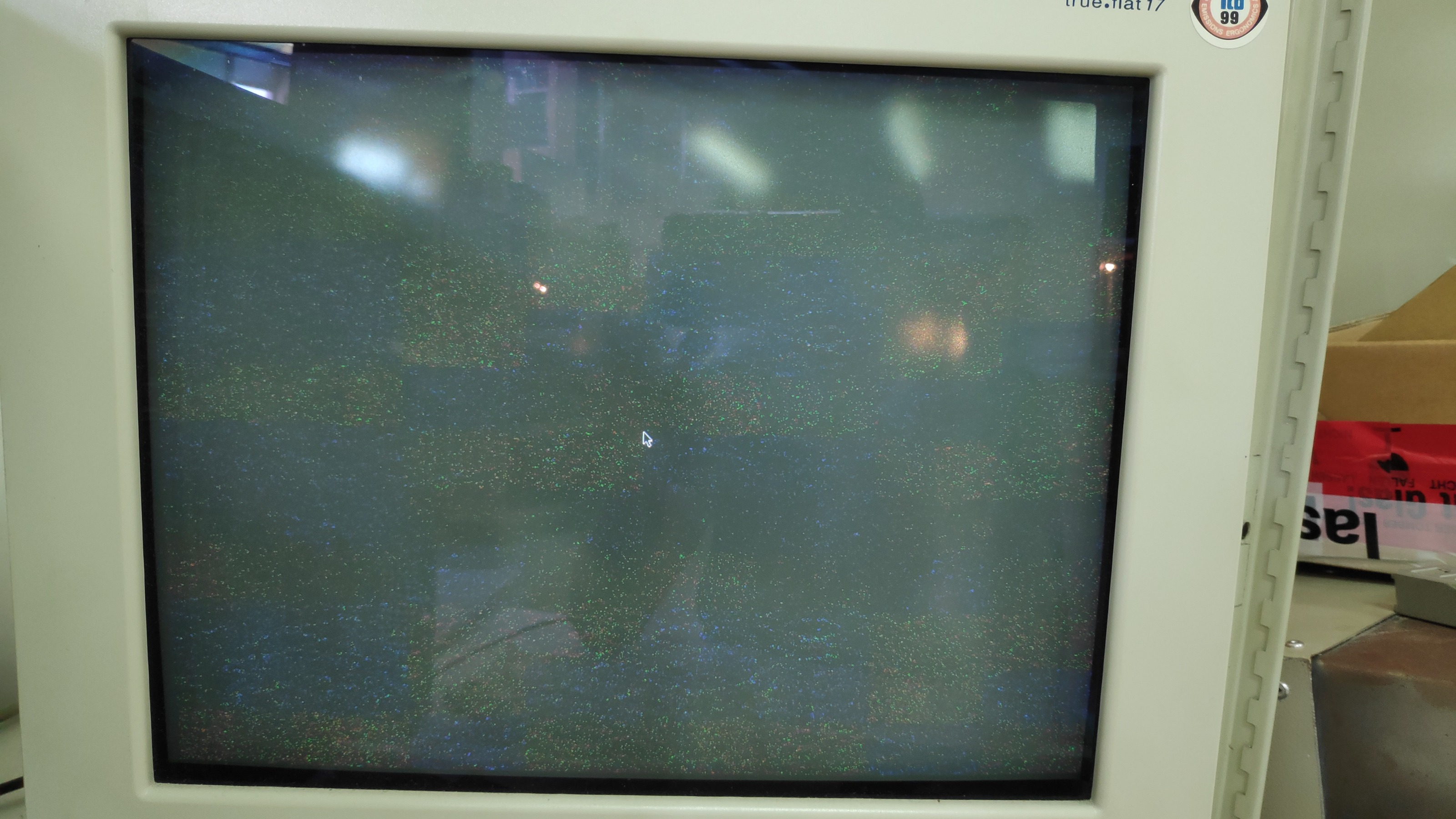

Well the story is as follows. Downloaded the iso image for Debian wheezy version of Linuxcnc, put it on dvd with intention of installing it to a newer pc (i3 530 @2.9Gh, HDD wd6400ars, 4GB ram, gt250 gs 1GB). Installation went on just fine and then it just won't open. I read that maybe that maybe partitioning as ext3 manually instead of ext4 might solve the problem, tried it, didn't work. I read that changing sata mode from ide to ahci might work, didnt.
I redid the process with the same results. Because writing every message that popped up would be painful I attached several photos of the system starting up and how it results in a pixelated crash. Has anyone encountered something similar?

Tried live version results in the same screen. Attached are photos of boot sequence

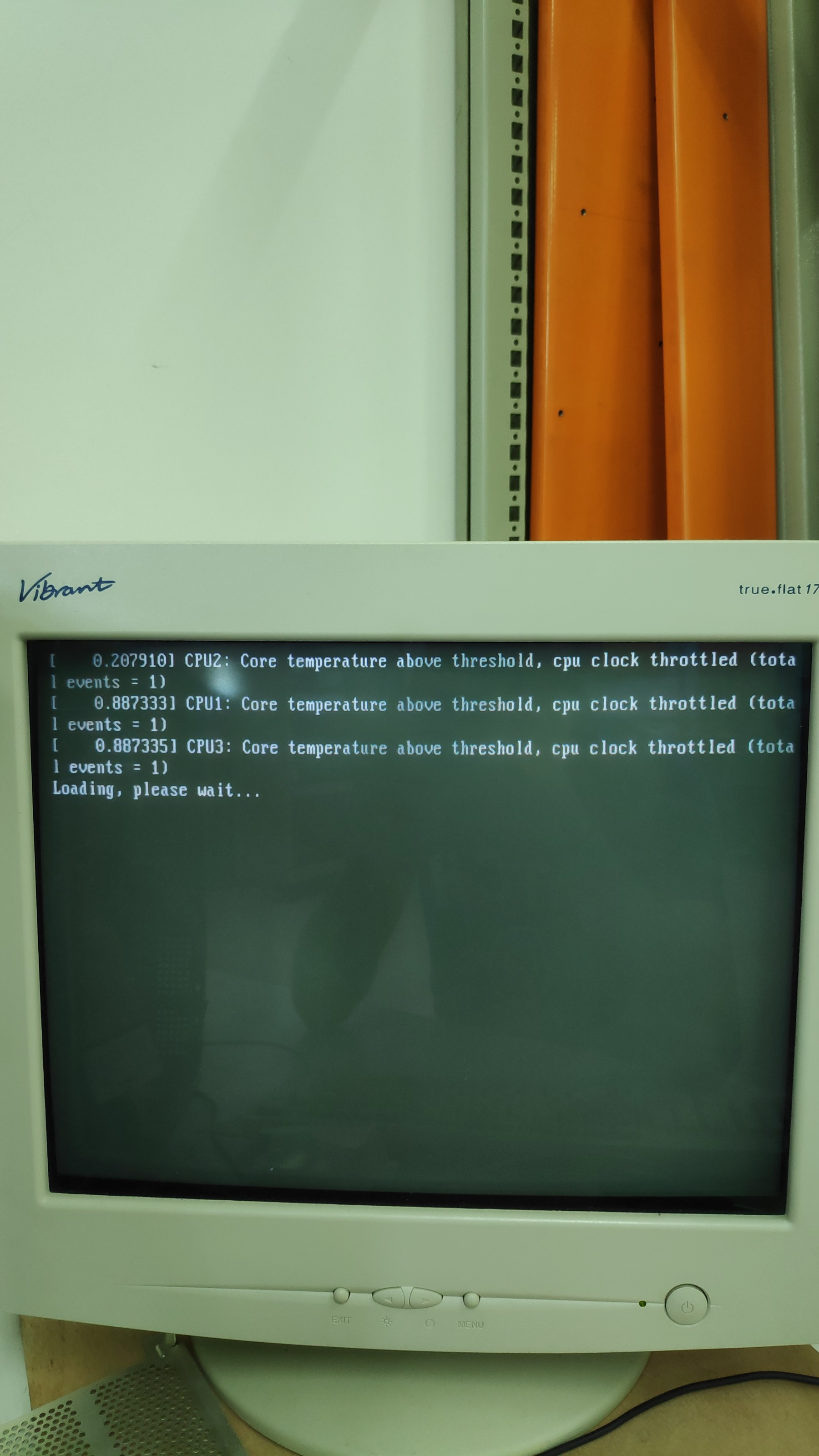

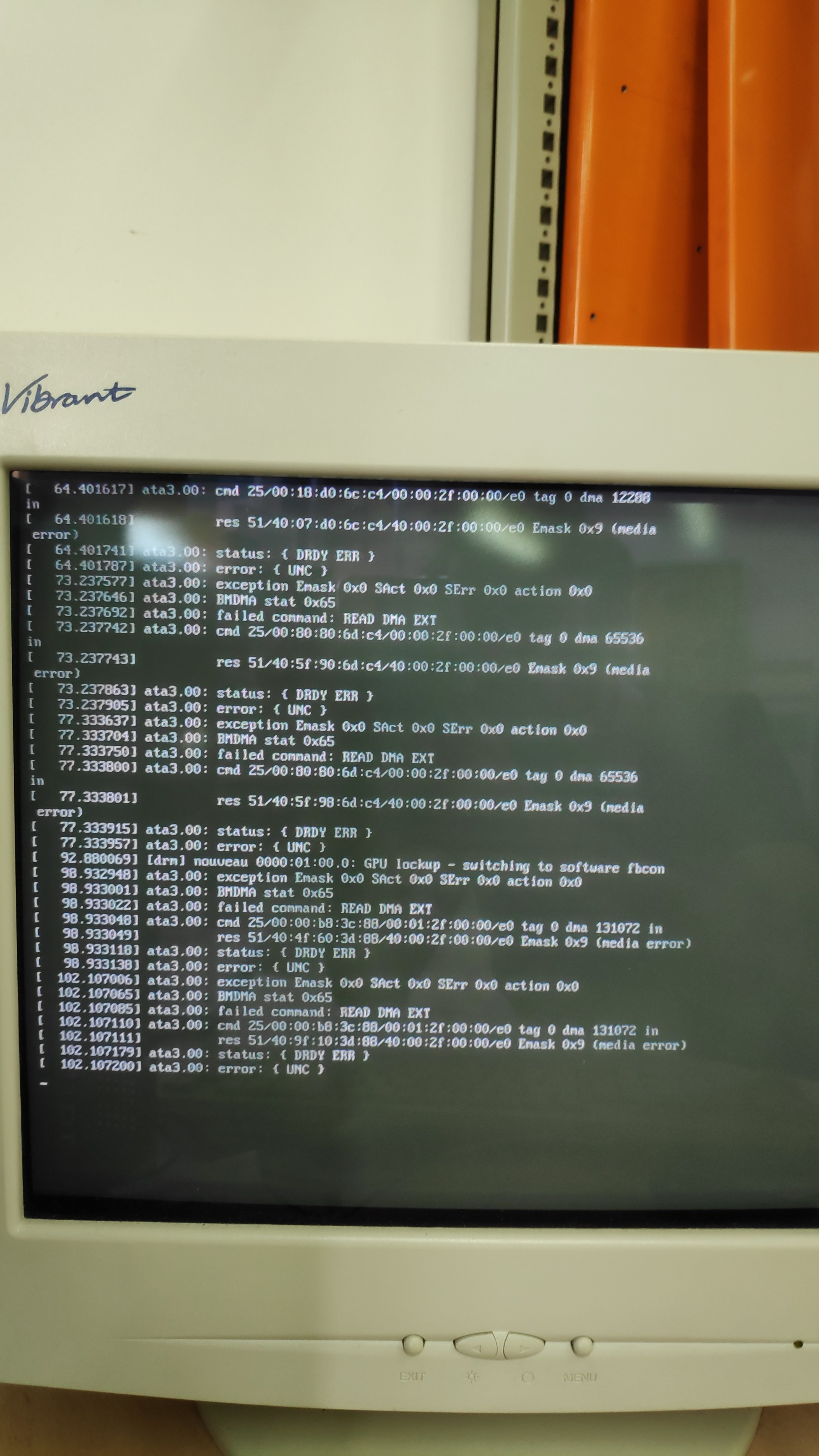

You have some more pressing issues with that PC.
Your processors are getting way to hot so they are throttling down to protect them from burning , so check the fan and if the fan is spinning you will have to remove the cooler and clean it and reseat it.
Also the DMA is having problems all over, that might be from the processor refusing to procces information due to overheating, but those two issues together point to a possible problem with power supply/ VRM. Check for blown up capacitor heads.
In any case, do not use that PC to control any big or expensive machine.

Today was quite a day. I tried to resolve the hardware issues. At first i changed paste of CPU which hadn't been changed for at least 5 years cause it was like concrete, to resolve the overheating issue, and i think it was a hit. Tried Debian wheezy live version got the same pixelated screen. Then i changed sata HDD because there was am indication of it being damaged, got the same screen. My last chance of a usable pc was a GPU problem. Downgraded to a Geforce 6600 LE, but long story short, 4 hours now, after 5 reboots and everything runs smoothly, memtest came up clean.
