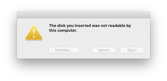

i flashed the Buster ISO to a USB flash drive on my Mac using Etcher. This always worked flawlessly for Raspi Buster images. But whenever i tried it with the LinuxCNC ISO i get the error message after finishing that the disk is not readable. I also tried to prepare the flash drive on my LinuxCNC Wheezy computer (instructions from the documentation) the result is the same. I tried to boot the flash drive from my iMac, the LinuxCNC computer in my workshop and from a quite new Win 10 PC. All with the same result, stating that the flash drive is not readable.
Any ideas what could be wrong here?

First of all not being able to read the USB stick after flashing is not unusual due to the image being a hybrid ISO.
Not being able to boot is not good. First thing I would check is that the download is good by checking the md5sum, google is a good resource to find out how to do that for your particular platform. If that fails the only recourse is to redownload the image and try again.

I would point the finger at etcher. The most reliable tool for creating boot images is win32diskimager on windows.
You really need to use a different burning program to eliminate it as being the problem.

As a general advice, use USB 2 ports on the PC or laptop to write inages/ISO, some USB flash drive controllers fail miserably on USB 3 when writing to them.

- just checked: checksum is okay, download should than be okay as well.
- don't want to be agnostic on this, but: Etcher always worked for me with many Raspi images. But i'll give the Win32diskimager a try
- can somebody please confirm that his download of the ISO worked without problems?
- Downloaded the ISO on MacOS and Linux and flashed it on different USB flash drives - both are showing the same problem.

Like I said previously after writing the imge to a USB stick it wont be recognised by the OS, this is not an issue.
With all things being well it will boot.
If there is an issue it wont boot.

Don't know if it really is an issue with Etcher (which i personally don't believe) but using Win32Diskimager on a different machine did the trick at the first try.
Buster Live is running right now in my workshop.
This being said i can proof by myself that the ISO is working properly.

The thing is win32diskimager is simple and doesn't try to be smart. You give it a input file and an output device and it will write to input file to the output device byte by byte.
Just out of interest were you trying to write the image to the raw device or a partition on the device.
In Linux that would be (raw device):
/dev/sdg
Instead of (a partition on the deivce):
/dev/sdg1
There's no point in trying to partition a flash drive your going to write an image to as everything, even the partition table is overwritten.
I've seen one utility that will mount the image file and partition the drive you want to boot from and copy the files over. This is not want you want. I know it sound a little confusing but that's just the way it is.
