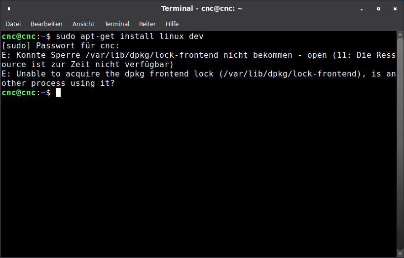

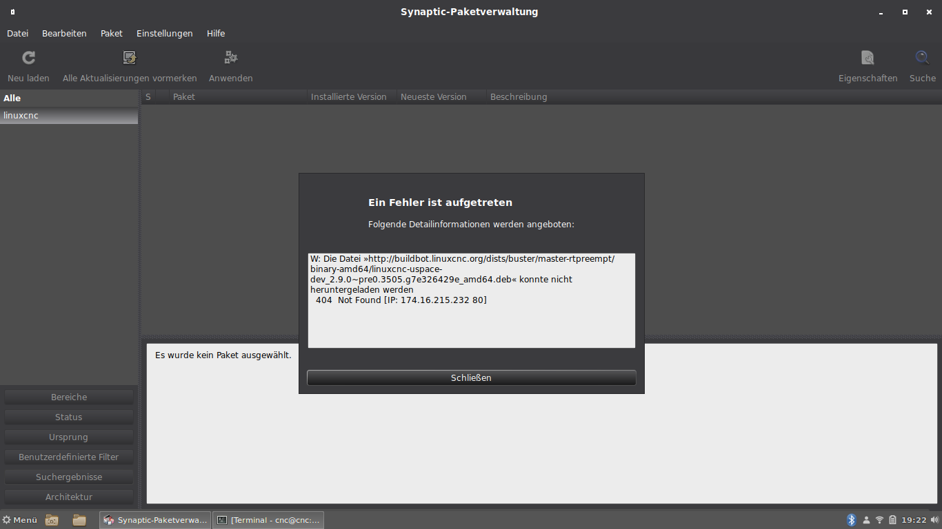

Hello dear Linuxcnc community. I have a problem with halcompile. I dont have this component installed and tried both with Terminal,
and Synaptic Manager - no luck. I attached Printscreens with error messages. Do you have any ideas what it could be?
Thank you,

sudo apt-get install linuxcnc-uspace-dev
and the Synaptic has to be closed before using the terminal to install stuff.
