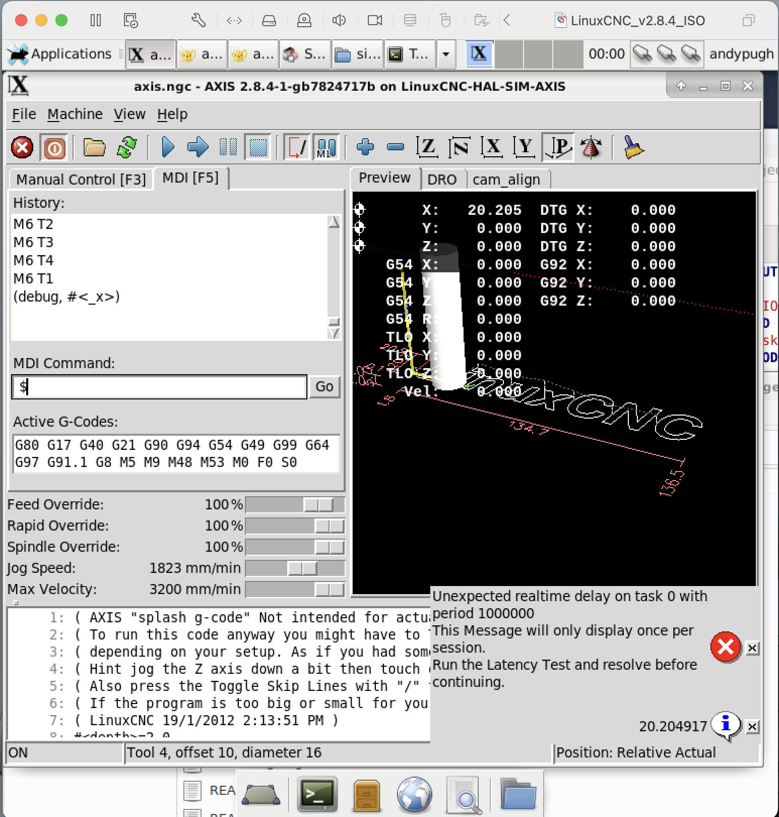

23 Nov 2022 00:01 #257407
Replied by andypugh on topic Can LinuxCNC be installed on a USB drive and used on a MacBook?
- Jayne01
- Posts: 3
23 Nov 2022 01:43 #257417
by Jayne01
Replied by Jayne01 on topic Can LinuxCNC be installed on a USB drive and used on a MacBook?
I will have a look at both the mint iso and also using VMware fusion. I have never used VMware before, will it allow installing the iso on an external drive? The drive on my laptop doesn’t have a lot of space left on it and I would prefer to fiddle with linuxcnc on an external drive anyway without disturbing the main internal drive. I won’t get a chance to try anything until next week though.
24 Nov 2022 19:28 #257574
With VMWare the virtual HDs of the guest machines are just ordinary files, and can be anywhere in your file system.
