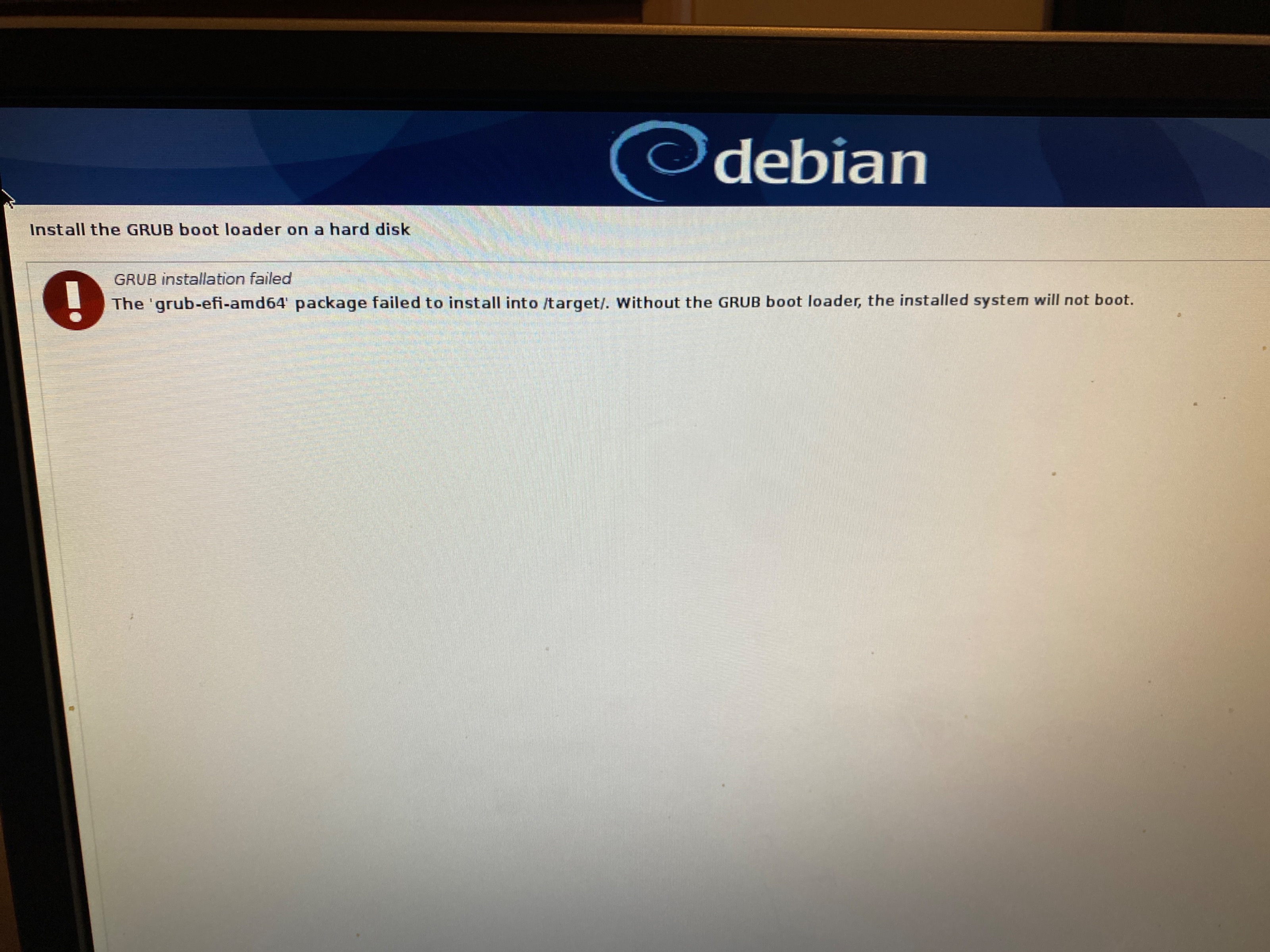

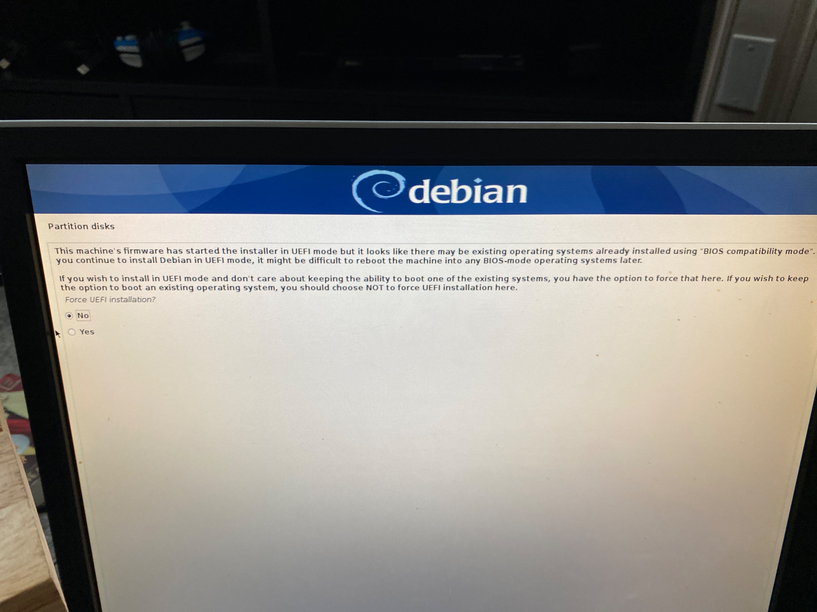

I’m having issues with the options and picking which ones to pick while installing, particularly partitioning. Would I be able to have someone help me with the options.

02 Dec 2022 13:43 #258353
Replied by Todd Zuercher on topic Installing Linuxcnc from usb to ssd
The simplest way and the one usually recommended for Linux novices is to simply install everything in a single partition (choose guided in the installation menu, and leave every thing as default.)

02 Dec 2022 14:47 #258364
That may depend on your PC. Some computers BIOS (BIOS is technically the wrong term) have UEFI poorly implemented and give problems with using it. Personally I've not had a problem with it, but I've not installed Linux on many newer computers that support UEFI. The ones that I've tried worked without issue. Most older computers will require using BIOS or "Legacy Mode" (what some computers call the BIOS mode.) Which you should choose when installing will depend on your motherboard and its boot settings.

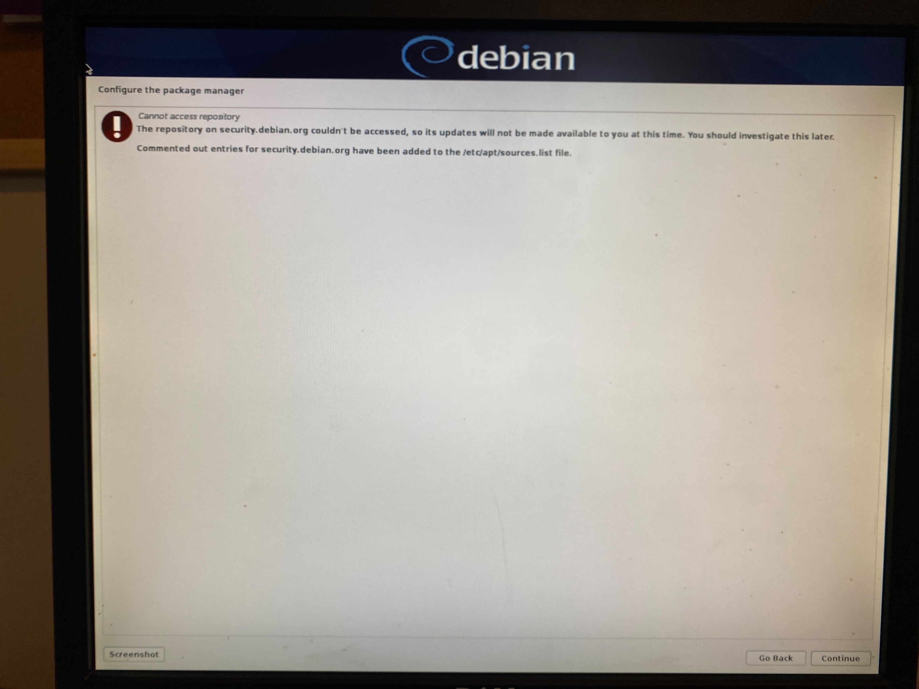

04 Dec 2022 14:46 #258528
Replied by tommylight on topic Installing Linuxcnc from usb to ssd
Just a warning, press continue.

04 Dec 2022 14:52 - 04 Dec 2022 14:53 #258530
by Aldenflorio
Replied by Aldenflorio on topic Installing Linuxcnc from usb to ssd
It’s hooked up via Ethernet
