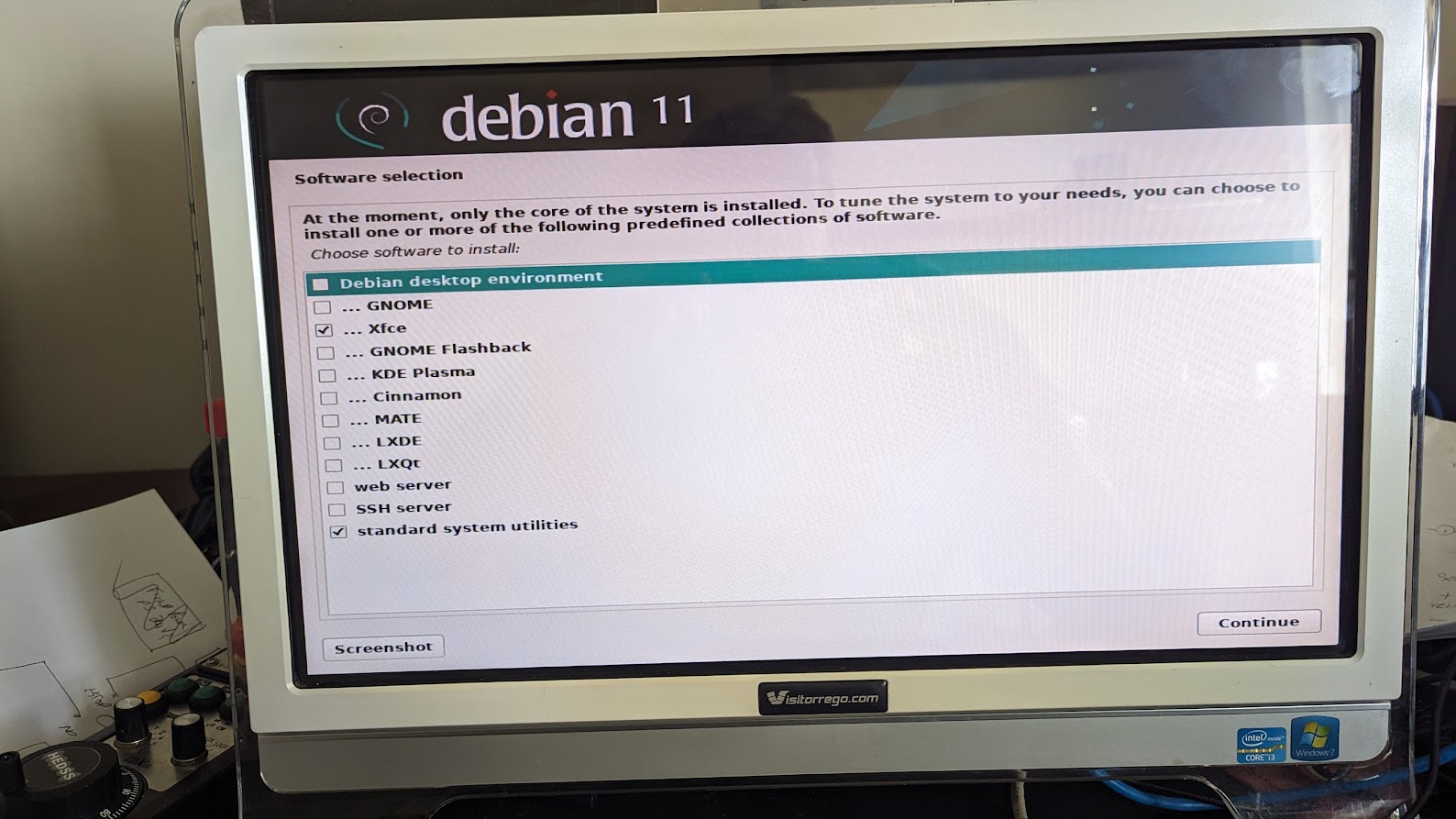

Installing Linuxcnc and Debian Bookworm on problematic hardware (eg. Realtek NIC was created by rodw
Running Debian Bookworm or Bullseye with some hardware (notably PC’s with Realtek network interfaces) has proved problematic as a new type of latency emerged. Network Latency between the PC and motion hardware. If the network becomes too slow, there is insufficient time for Linuxcnc to get things done and mesa network hardware shuts down after issuing an error finishing read. Ethercat drives with slaves disappearing intermittently are also likely to be caused by this issue. Previously stable hardware has become problematic due to this problem.The issue occurs on some hardware with any version of debian from kernel 5.10 (Bullseye) and above through to the latest kernel 6.1.
These are the versions of Debian to support modern hardware. Installing Bookworm is an attractive method to get Linuxcnc installed as it is deployed as a Debian package on this Debian version.
There are two issues involved here.
1. A problematic PREEMPT_RT realtime kernel deployed with Debian that adds to network latency.
2. A confusing set of realtek network drivers in Debian and a mismatch between the default driver and the hardware.
Resolving the first issue used to require compiling the Linux kernel but now a prebuilt .deb of the kernel and the headers. These have been built using the pristine source of the 6.1 kernel from kernel.org so it's not affected by Debian’s kernel patches.
Realtek drivers.
Debian has 3 Realtek drivers in Debian:
The default r8169 driver used with all realtek hardware by default
The r8168-dkms driver that covers a large range of NIC’s (ref: packages.debian.org/bookworm/r8168-dkms)
The r8125-dkms driver that supports the new 2.5 gb NIC’s found on the Odroid H2+/H3/H3+ pcs and an increasing number of other PC’s (ref: packages.debian.org/bookworm/r8125-dkms)
dkms drivers are compiled from source on installation and need the linux-headers. These contain all the C header files to allow building software against the kernel. The default r8169 has no installable driver. To reinstall it, you need to purge any dkms drivers you have installed (eg sudo apt purge r81XX-dkms)
So it sounds pretty simple right? We just need to install our custom kernel which is likely to be cdimage.debian.org/cdimage/unofficial/no...mware/weekly-builds/ for any PC that does not have Realtek drivers) and install the correct driver for a Realtek NIC.
Note that it's not necessary to reinstall Debian if you are afflicted with this problem, you can just update to our custom 6.1 kernel and its headers on the link below and optionally install the correct Realtek driver.
The next post will work through a step by step approach on how to install bookworm that contains the linuxcnc packages.
Start by downloading the Bookworm non-free version from the weekly builds here
Usually you will want the amd64 version and I usually select the cd version making sure that the PC is connected to a wired network during installation. Burn it to a USB stick and install it in the usual way but be sure you select the XFCE gui. This is mandatory to ensure xorg elements linuxcnc needs exist.
Then we’ll meet up on the next post and get on with it.

Lets start:download linux-headers and linux-image from here
drive.google.com/drive/folders/10uwGg5Rv...LtQ8BZhM3At_gODk16naNote that pressing (tab) above lets linux autocomplete the line for you to save typing
Make the new 6.1 kernel the default. Eg move to the first entry.
reboot and check our kernel loadedand save the name of the NIC you will use for your mesa card (enp2s0 for us)
Check the device specsNote the driver is r8169 but the hardware is rtl8168e
So debian is using the wrong driver. install the correct driver
First check that we are not going to look in CD or DVD drives for softwareComment out any lines beginning with CD or DVD with a #
Save and:Once rebooted, open a terminal and:note driver is now correctly listed as r8168
So Our job is done! time to configure the wifi at top right and set up the NIC interface for Mesa
