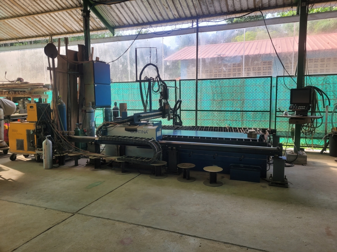

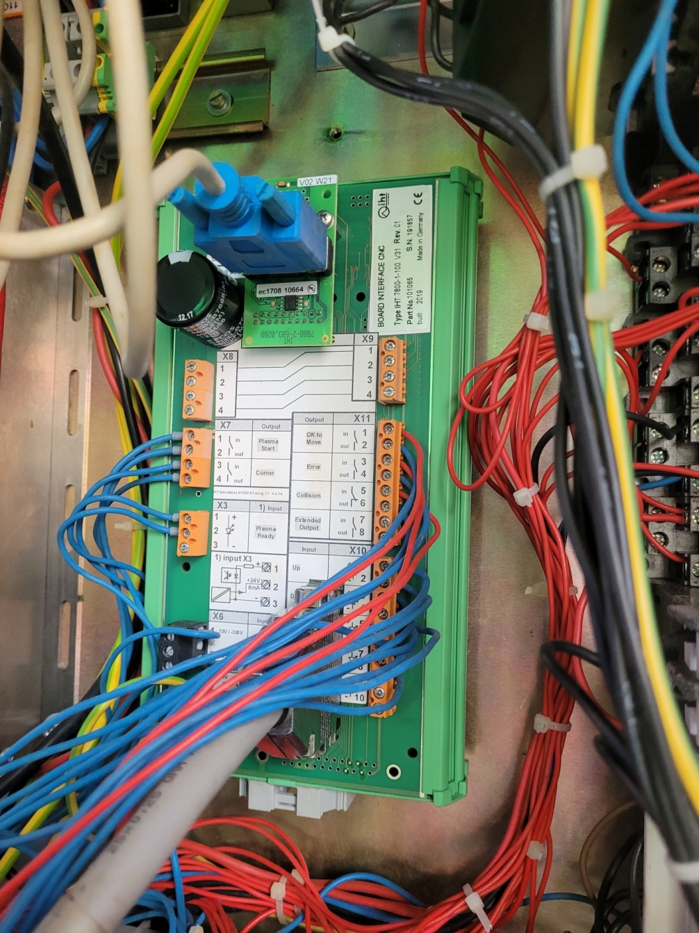

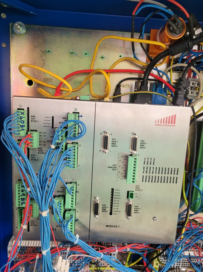

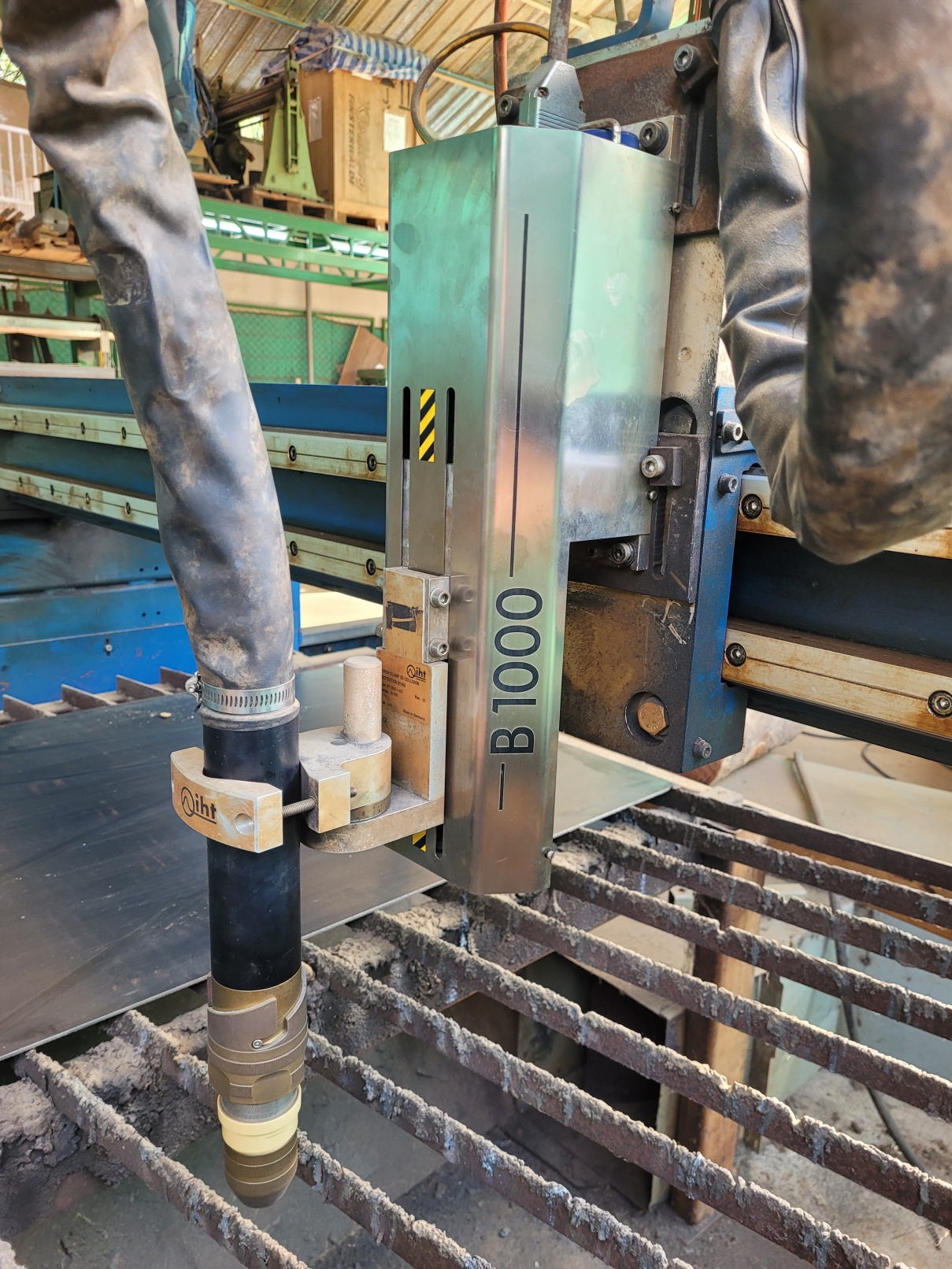

Ok busy day today here are some basic pictures.We also found a way to twist the damaged software and we are able to cut how ever with more time and effort. But the pressure is now off and I can spend much more time to go through the linux cnc soft ware. Again the machine went through a retrofit in 2016 hence the hardware should be not complete outdated.
1. Which version of linux cnc should I download. Please advice a complete package including the OS and Kernel.
2. I want to install it along the windows 7 as some configuration files from the old cnc control might be needed. Is that possible?
3. Do you think any of the existing hard ware could be used by linux cnc?
- Posts: 12158
- Thank you received: 4150
15 May 2024 12:15 #300675
Replied by rodw on topic Retrofit cnc plasma help needed desperately
The 2.9.2 ISO on the downloads page includes everything you need. A few people have retofitted similar sized machines with QTplasmac.
It is possible to install linux onto an existing windows HDD and you can access the windows drive from Linux and select the OS from the GRUB boot menu.
I had a PC set up like ths until I did something silly and broke Windows Totally.
I have two Dual boot PC's with seperate drives for Linux and Windows which I boot from the BIOS boot menu. No sharing. One of the Windows partitions broke. The other one is still OK. I use Linux for everything now.
Another alternative might be to use seperate PC's and map shares across the network using SAMBA. This works nicely for file sharing... but not trivial to set up (Although Win7 should be easier than Win 10/11 which disabled some required policies)

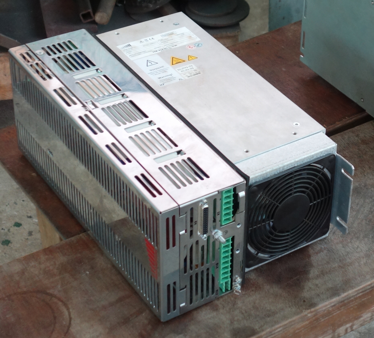

- Posts: 4819
- Thank you received: 2176
15 May 2024 12:36 #300676
Replied by Aciera on topic Retrofit cnc plasma help needed desperately
Most important thing would be to know what command interface the motor drives are using. Analog voltage and step/direction should be fine anything else would be most likely problematic.

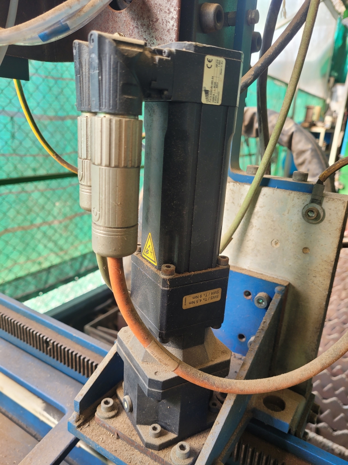

16 May 2024 12:25 #300734
by CNC-Martin
Replied by CNC-Martin on topic Retrofit cnc plasma help needed desperately
@ rodw. Thank you I will do it asap. And yes I also use Linux since 2009. Such a relief. 2 Lap top dual boot. I am definitely not a computer geek but the change was worth the effort. Deskt. Mint una XFCE lean easy great.
@ Acira yes indeed I attached the SDI Interface manual. (Copy rights should not be a problem the company does not exist anymore) As I understood there is a plug with analog inputs. But I also would agree to change the servo as I don t know where I get it fixed or get a replacement. Which servos you would recomend?
- RDA
- Posts: 157
- Thank you received: 43
16 May 2024 13:07 - 16 May 2024 13:07 #300737
by RDA
Replied by RDA on topic Retrofit cnc plasma help needed desperately
I took a Quick Look a the “manual”. It has no info about what the analog inputs can be used for, a vague mention about some (probably proprietary) bus system and no mentions about how to set any parameters.
I would probably scrap the idea of using the existing motors and just replace them. I might be wrong but that manual does not really help at all.

- Posts: 4819
16 May 2024 13:47 #300742
Yes, looks like the drives and motors need to be replaced. I have not had to replace motors on any of my projects, I've heard good things about DELTA Drives but others will have more hands on experience with that.

16 May 2024 14:22 #300750
by CNC-Martin
Went through some of the details in your Messer Project and as far as I understood is that pretty much non of my existing equipment is usable.
Question
You used the old dc motors but you changed the encoder is that right? I have still the old dc motors. If I could understand which encoder and how to fit it onto the old dc motors I would have the same situation as you - Gecko dc servo drive Mesa card, and Z drive ...we will see. Could you please comment that.
Question
