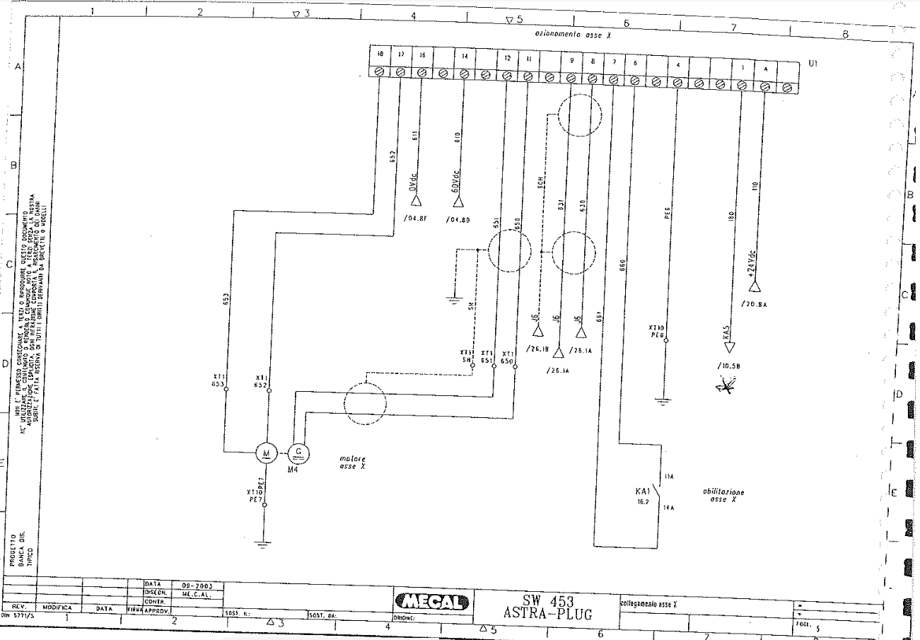

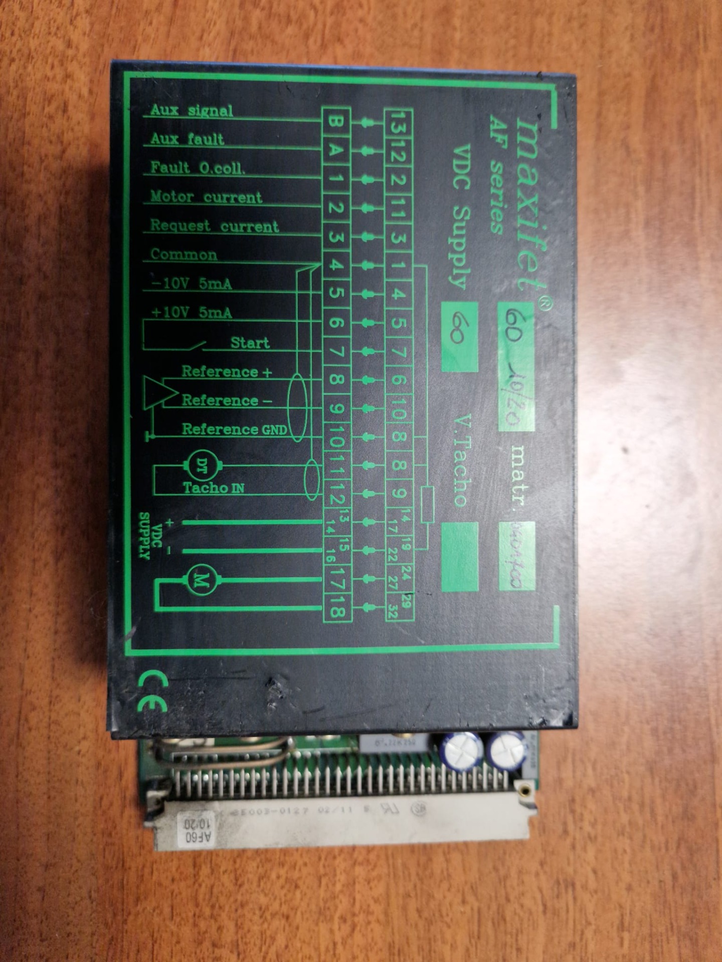

Hello everyone, I'm going straight to the point hehe, I have in my possession a Maxifet AF series 60 10/20 driver and the respective motor that drives it, this is a DC driver and apparently the motor is connected in speed mode since it has a tachometer. It is connected to the driver, I would like to recover this driver but I can't find any datasheet on the internet, I have been reading some threads here in the forum about DC drivers and something very common is the analog +/- 10V data interface that the driver housing says. If this is the case, first I would like some advice on which control cards to use. I was thinking of using a 7i33TA. I imagine that this can be used with any card with a 50-pin control connector. If someone could point out one, preferably Ethernet, I don't know if there is one. Mesa card, with at least an analog output +/- 10V, I know that 7i96 has an analog output, I'm not sure if it's -10V and I think it is designed for spindle control, this output could be used to control one axis since I only need one axis
Anyway, if anyone has any information about this driver that they can provide and a combination of board cards to control it, thank you in advance, I leave a photo of the driver and a brief diagram of the pins that are used in the machine where it is installed, greetings

Mesa boards and combos that work for analog +-10V drives, all 25 pin ones
7i97T
7i92TM + 7i77 <<< notice the M, it can be directly plugged into 7i77
7i92TM + 7i83 + 7i85 <<< notice the M, it can be directly plugged into 7i85
7i96S + 7i83 + 7i85 <<< needs a DB25 to IDC26 cable very cheap at Mesa shop
7i76E + 7i83 + 7i85 <<< needs a DB25 to IDC26 cable very cheap at Mesa shop
There are also other boards, but the 7i96S combo can be easily found, the first two should be available as it was noted by PCW, might also be sold out.

It's possible to use a 7I33 and a 7I96 with a
cable adapter from 7I96 P1 to the 7I33
There's even thread on the forum about this:
forum.linuxcnc.org/10-advanced-configura...sa-7i96s-pwm-outputs
(got to the end)
Note that that is for a 7I96, not 7I96S but the same firmware can be made for the 7I96S
Using the 7I96S spindle interface for an analog servo is probably not worth the trouble for
a couple of reasons:
1. You need a +10 and -10 supply (these are not common)
This limit is because the absolute maximum voltage from
SPINDLE- to SPINDLE+ is 20V
2. The spindle output only has about a 100Hz bandwidth which
will make tuning/performance an issue
If you only need one encoder, a 7I96S+7I83 might be the most direct way
