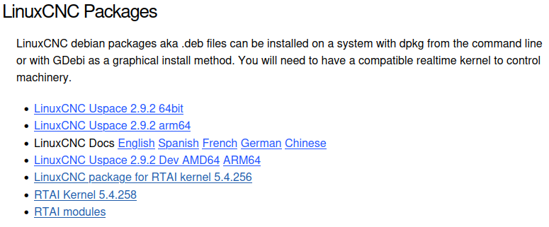

I installed a generic Debian 12 then installed
www.linuxcnc.org/dists/bookworm/2.9-rt/b...xcnc_2.9.2_amd64.deb
www.linuxcnc.org/dists/bookworm/base/bin...ai-amd64-2_amd64.deb
www.linuxcnc.org/dists/bookworm/base/bin...xcnc-delta_amd64.deb
When I try and run LinuxCNC the config picker just freezes up. Latency is crazy good...
When I try and run the testsuite I get
Anyone have an idea what I missed?

john@rtai:/usr/realtime-5.4.258-rtai-amd64/testsuite$ pwd
john@rtai:/usr/realtime-5.4.258-rtai-amd64/testsuite$ sudo /usr/realtime-5.4.258-rtai-amd64/testsuite/display
[sudo] password for john:
CANNOT FIND MAILBOX
john@rtai:/usr/realtime-5.4.258-rtai-amd64/testsuite$ sudo /usr/realtime-5.4.258-rtai-amd64/testsuite/latency
CANNOT CREATE MAILBOX
john@rtai:/usr/realtime-5.4.258-rtai-amd64/testsuite$ sudo /usr/realtime-5.4.258-rtai-amd64/testsuite/run
.runinfo is /usr/realtime-5.4.258-rtai-amd64/testsuite/.runinfo
RTAI loaded.
Unloading modules...
Running rmmod on /usr/realtime-5.4.258-rtai-amd64/testsuite/.runinfo...
rmmod: ERROR: Module rtai_msg is not currently loaded
rmmod: ERROR: Module rtai_mbx is not currently loaded
rmmod: ERROR: Module rtai_sched is in use by: rtapi
rmmod: ERROR: Module rtai_hal is in use by: rtapi rtai_sched
All RTAI modules unloaded.
Running insmod on /usr/realtime-5.4.258-rtai-amd64/testsuite/.runinfo...
insmod: ERROR: could not insert module /usr/realtime-5.4.258-rtai-amd64/modules/rtai_hal.ko: File exists
Error inserting rtai_hal.ko
CANNOT FIND MAILBOX
Cleaning up...
Error removing rtai_msg.koAnyone have an idea what I missed?

Try
halrun -U
then try to run the included parallel port configuration
mind the upper case U
halrun -U

This is what I get:
JT
john@rtai:/usr/realtime-5.4.258-rtai-amd64/testsuite$ halrun -U
ERROR: Can't remove RTAI modules, kill the following process(es) first
USER PID ACCESS COMMAND
/dev/rtai_shm: john 1106 ....m halcmdJT

Rebooting and just running halrun from a terminal I get an error with motmod:
JT
john@rtai:~$ halrun
halcmd: loadrt trivkins coordinates=XYZ
halcmd: loadrt motmod base_period_nsec=100000 servo_period_nsec=1000000 num_joints=3
insmod: ERROR: could not insert module /usr/realtime-5.4.258-rtai-amd64/modules/linuxcnc/motmod.ko: Unknown symbol in module
<stdin>:2: exit value: 1
<stdin>:2: insmod for motmod failed, returned -1
See the output of 'dmesg' for more information.
halcmd: JT

Ran modinfo and it seems it has dependencies
There's a whole lot of modules that need loading before motmod
sudo modinfo /usr/realtime-5.4.258-rtai-amd64/modules/linuxcnc/motmod.ko
[sudo] password for rmurphy:
filename: /usr/realtime-5.4.258-rtai-amd64/modules/linuxcnc/motmod.ko
license: GPL
description: Motion Controller for EMC
author: Matt Shaver/John Kasunich
depends: homecomp,tpmod,hal_lib,millturn,rtapi,rtai_math
vermagic: 5.4.258-rtai-amd64 SMP mod_unload
parm: key:shared memory key (int)
parm: base_period_nsec:fastest thread period (nsecs) (long)
parm: base_thread_fp:floating point in base thread? (int)
parm: servo_period_nsec:servo thread period (nsecs) (long)
parm: traj_period_nsec:trajectory planner period (nsecs) (long)
parm: num_spindles:number of spindles (int)
parm: num_joints:number of joints used in kinematics (int)
parm: num_extrajoints:number of extra joints (not used in kinematics) (int)
parm: num_dio:number of digital inputs/outputs (int)
parm: names_din:names of digital inputs (array of charp)
parm: names_dout:names of digital outputs (array of charp)
parm: num_aio:number of analog inputs/outputs (int)
parm: names_ain:names of analog inputs (array of charp)
parm: names_aout:names of analog outputs (array of charp)
parm: num_misc_error:number of misc error inputs (int)
parm: names_misc_errors:names of errors (array of charp)
parm: unlock_joints_mask:mask to select joints for unlock pins (int)There's a whole lot of modules that need loading before motmod

Hmm, I think the startup scrip does some magic but it freezes on me and does not print anything to the terminal.

Interesting a Stepconf sim started up and ran then Firefox crashed then the sim crashed with this:

- Posts: 19904
29 Jun 2024 12:35 #304039
Replied by andypugh on topic Debian 12 RTAI
You should have matching 5.4.258 linux-image, linux-headers and RTAI modules from here:
www.linuxcnc.org/dists/bookworm/base/binary-amd64/
And then the linuxcnc deb from here: www.linuxcnc.org/dists/bookworm/2.9-rt/binary-amd64/
If that works then it looks like the docs need updating. If that doesn't work then it looks like I need to dig deeper.
The following user(s) said Thank You: JT
