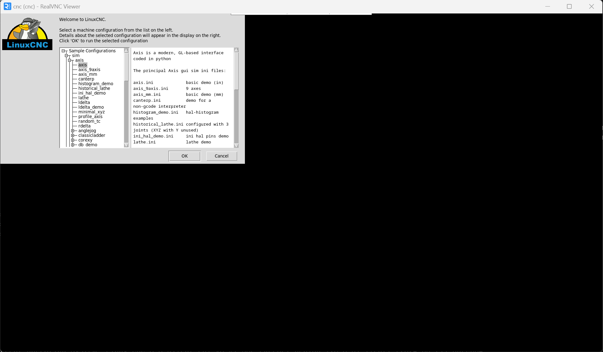

I just followed linuxcnc.org/docs/stable/html/getting-st...th_preempt_rt_kernel and installed Raspbian bookworm Lite on a Raspberry 3B, and installed the Preempt-RT Kernel, and then installed LinuxCNC using the install script.
I have no desktop environment and want to run only the LinuxCNC application using the X11 server, without any other bloat.
Now, after installing xorg, i can successfully run LinuxCNC using
Now, the terminal of the rpi turns into a black window, that renders LinuxCNC fullscreen, without a desktop environment. (Screenshot in Attachments)
However, when I select any config (e.g. sim->axis->axis) and click ok, the window closes and the normal EMC2 splash screen appears for a few seconds, like it should, and then it just closes without any message and the X11 server stops.
Following is the command line output:
And here is the same command with a script that just echos "hi":

So, as you can see, command line output is printed directly and LinuxCNC does not produce any.
How can I diagnose this issue? If LinuxCNC stops without any command line output, can I find a log file somewhere? Or can I enable some debug features?

Alright, I found the solution already.
Firstly:
I was able to get debug information out of LinuxCNC by having xinit instead loading a script, that calls LinuxCNC and redirects its output to a file.
Secondly:
It turned out LinuxCNC cannot run as root, however xinit must run as root, which means the script needed to use "sudo -u cnc linuxcnc" to run it as a normal user even though xinit runs it as root.
And thirdly:
There was also an issue where it did not load forever and apparently it was waiting for user input in the console, which was not visible.
In the end it turned out it's a lot easier to run "sudo xinit" in one terminal, to run the xorg server, and in another terminal run linuxcnc manually, thereby not having an issue with root and you can also do user input.
I cannot attach a Screenshot here but it works now and I have LinuxCNC running fullscreen on a Raspberry PI, without a desktop environment.
