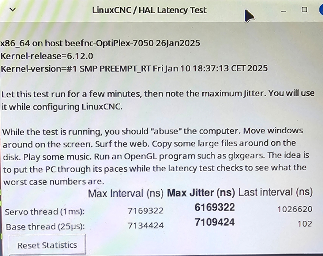

Kernel 6.12 with PREEMPT_RT patches enabled - yet POSIX non-realtime (LM22.1) was created by Beef
I've tried both RIP and building into a .deb and installing, but both ways it appears that it doesn't recognize the kernel has PREEMPT_RT enabled.
I have kernel 6.12.9 (although latency-test displays 6.12.0 for some reason?) and went through the menu config to set it for fully pre-emptable kernel and build it.
I'm on Linux Mint 22.1 and I can run simulations just fine in both RIP and the installed versions, but I run a mesa card and require HOSTMOT2 functioning properly which is where the issue arises.
Running latency-test results in some crazy huge numbers and it specifies POSIX non-realtime in the terminal.
I'm not sure if there's an additional step that I've missed to ensure LCNC "sees" the kernel has the patch enabled - perhaps the string has changed? I tried searching the forum and only came across RPI results but not x86.

Editing the above message appears to break it so replying instead - running uname -r it appears I have a skill issue and it returns 6.12.0, which is what I clearly accidentally had built. There may be issues in 6.12.0 that were resolved by 6.12.9 that resolve this, so a quick rebuild (well, not quick it takes forever) and I'll report back.

Thanks, that patch file was exactly what I needed for it to work properly - I had rebuilt it at the same time and it worked without issues.

The patch brings back the indicator (/sys/kernel/realtime) that LinuxCNC uses to check if the OS is realtime. This is a part of the realtime patches that didn't become mainline.
