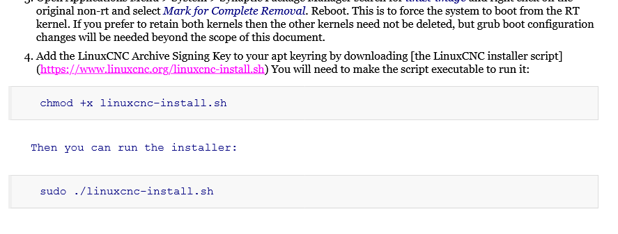

If i click on the link for the linuxcnc-install.sh file it doesnt download anything. So where exactly do I get the script? Iam probably just to stupid to understand it.

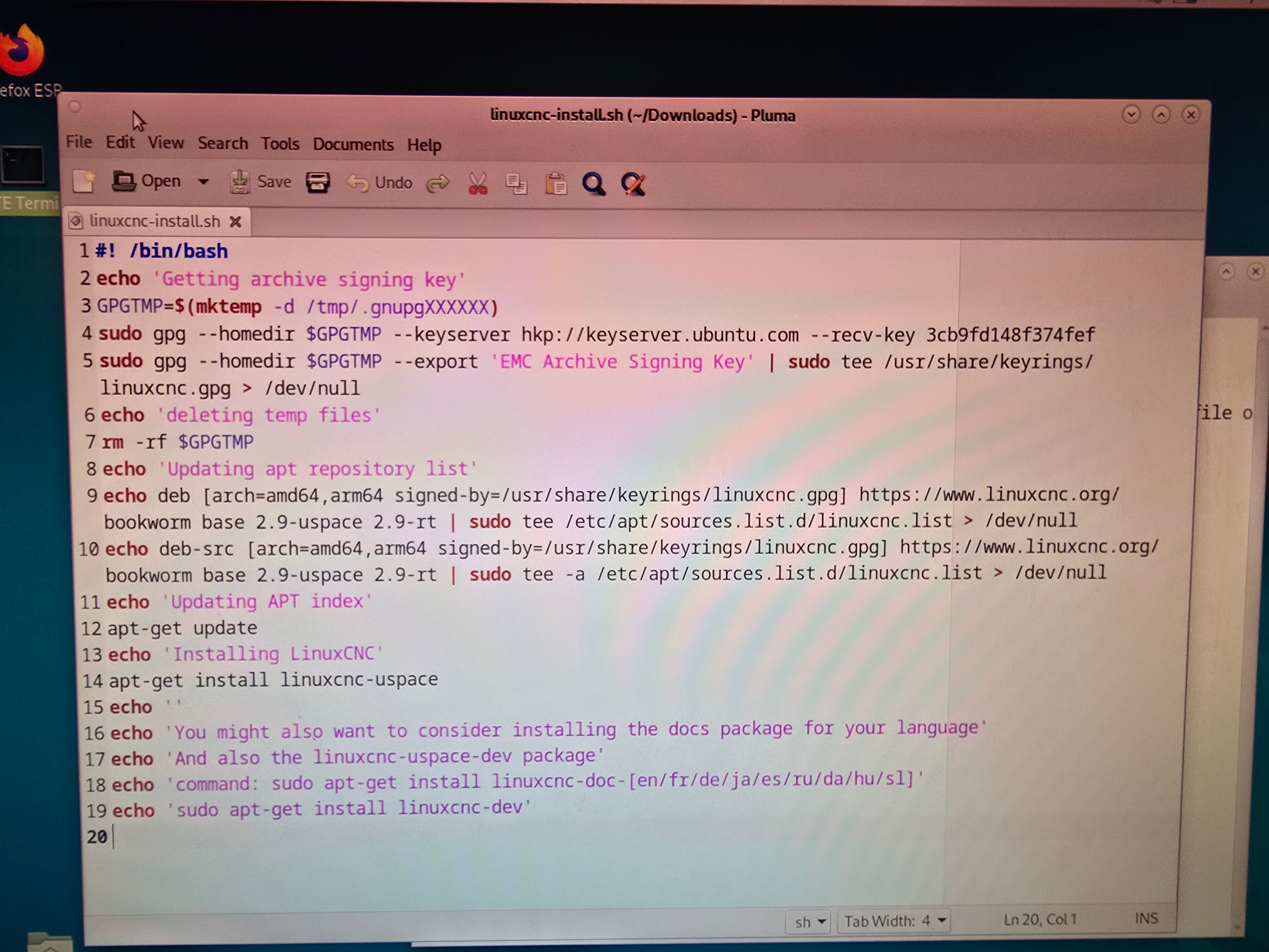

Also chmod +x linuxcnc-install.sh doesnt work. I have even tried opening an txt.file and naming it linuxcnc.install.sh with the script from the browser. But still nothing.

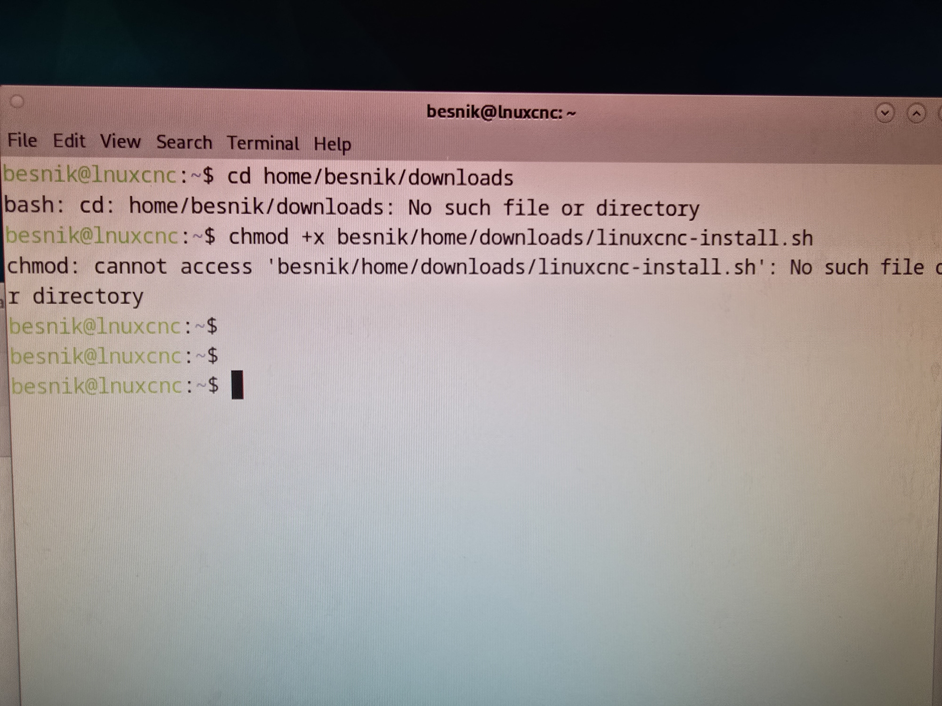

$ chmod +x besnik/home/Downloads/linuxcnc-install.sh
Or better yet
$ cd besnik/home/Downloads/
$ chmod +x linuxcnc-install.sh
Always says No such file or directory.
Does anyone have an idea what I am missing I can already deel its something easy to fix I just dont see it. Kinda embarrassing asking for help

You had the directory tree order wrong. You typed "cd home/besnik/downloads/" and it needs to be "cd besnik/home/Downloads/". Also Linux is case sensitive so the capitol leter "D" is also important.

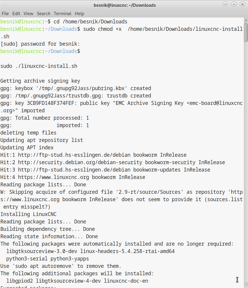

home and besnik are in the wrong places again and Downloads starts with upper case D. Linux is case sensitive so D and d are not the same.
Copy and paste from here:
cd /home/besnik/Downloadssudo chmod +x /home/besnik/Downloads/linuxcnc-install.sh./linuxcnc-install.sh

It definetly did something this time. Thanks for youre help guys. I was ready to just go back to Estlcam and windows haha.
If I go to Applications -> CNC there are only two options there is Documentation and G-Code Quick Reference. There is no LinuxCNC application does that mean somthing went wrong with the installation? I did a restart same thing.
