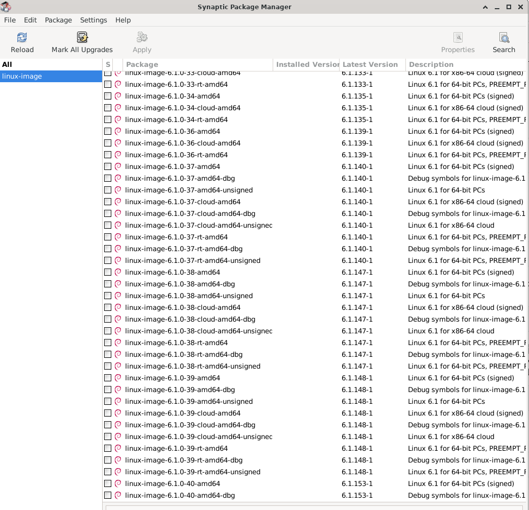

Hello,
I've been trying unsuccessfully all weekend to get the latest Debian Bookworm with the latest Linuxcnc preempt-rt up and running. Since I have little experience with Linux, I'm reaching my limits.
I downloaded and installed Debian Bookworm 12.13. Now I wanted to follow these instructions linuxcnc.org/docs/html/getting-started/g...th_preempt_rt_kernel , point 7 (with preempt-RT kernel). Would that be correct so far?
At point 3, Open Applications Menu > System > Synaptic Package Manager, search for linux-image, right-click on the original non-rt, and select Mark for Complete Removal, I don't know which original non-rt I have to select. I have attached a screenshot.
Otherwise, please attach Linux terminal commands so I can quickly achieve my goal.
Greetings from Germany and many thanks.

1) Why Bookworm and not Trixie?
2) Why not just install from the ISO image?
It looks like the automatic updater has not updated the manual page to reflect anything since 2.9.4.
You can see what the page is meant to currently say here:
github.com/LinuxCNC/linuxcnc/blob/master...etting-linuxcnc.adoc

You should be able to install a previous Bookworm ISO, then update the LinuxCNC version (this should actually be automatic).
The 2.9.4 ISO will definitely be Bookworm as it precedes the Trixie release.
www.linuxcnc.org/iso/
Then use the Synapric package manager to update LinuxCNC.

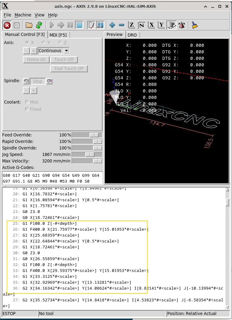

There i still a but... if you have a look at the attached photo why do i have no mm after my coordinates or depth? Ist the axis_mm from the sim

Parametric gcode, numbers are at the top.

So is it normal? As i remember from my old PC there were mm shown... and G21 is mm, right?

Normal gcode-
Parametric gcode
G17 G90 G64 P0.001 M3
G21
G0 Z0.1000
F5000.0000
F5000.0000
G0 X115.8525 Y150.0000
F5000.0000
G1 Z-10.0000
X111.6756
X109.9170 Z-9.5877
X109.6238 Z-9.2348
X109.3307 Z-9.1373
X108.5979 Z-9.3725
X105.9599 Z-9.6471
X105.6668 Z-9.9799
X105.3737 Z-10.0000
X80.9722Parametric gcode
#<xscale> = 1.0
#<yscale> = 1.0
#<zscale> = 1.0
#<fscale> = 10000.0
#<toolno> = 1
#<rpm> = 1600
N30 G21
N40G90
G64P.1
N50T#<toolno>M6
N60M8
N70S#<rpm>M3
N90G0Z[#<zscale>*10.]
N80G0X[#<xscale>*53.]Y[#<yscale>*-56.128]
N100G1Z[#<zscale>*-25.372]F[#<fscale>*100]
N110G1Z[#<zscale>*-27.372]F[#<fscale>*225]
N120Y[#<yscale>*-56.12]Z[#<zscale>*-27.725]
N130Y[#<yscale>*-56.105]Z[#<zscale>*-27.894]
N140Y[#<yscale>*-56.06]Z[#<zscale>*-28.152]
N150Y[#<yscale>*-56.051]Z[#<zscale>*-28.184]
N160Y[#<yscale>*-55.992]Z[#<zscale>*-28.405]
N170Y[#<yscale>*-55.902]Z[#<zscale>*-28.651]
N180Y[#<yscale>*-55.792]Z[#<zscale>*-28.888]
N190Y[#<yscale>*-55.661]Z[#<zscale>*-29.115]
N200Y[#<yscale>*-55.511]Z[#<zscale>*-29.329]
N210Y[#<yscale>*-55.343]Z[#<zscale>*-29.53]Please Log in or Create an account to join the conversation.
