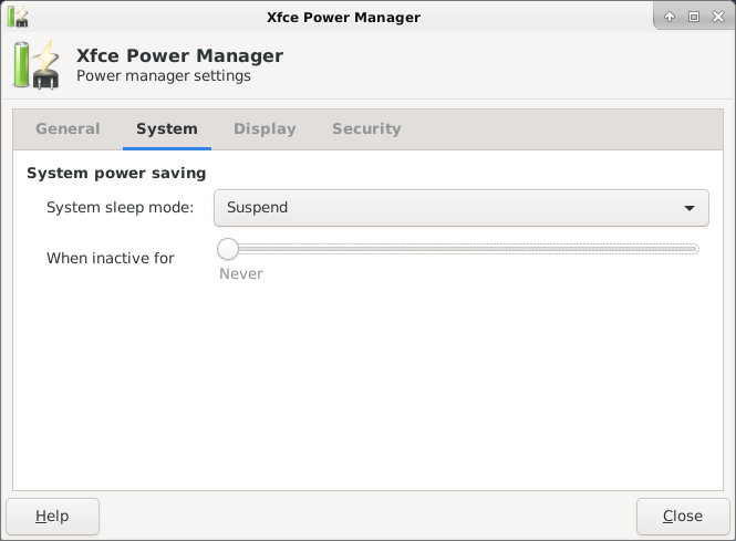

Every few years I upgrade something on my stepper controlled knee-mill. I usually get sucked into upgrading linuxcnc at the same time. I just upgraded the stepper motors and put a new controller on. The new controller is using Mesa 5i25 and 7i76 cards with Gecko drivers. I was running linuxcnc 2.9.4 and decided to upgrade to 2.9.8. Rather than upgrade I did a new install with 2.9.8 (Debian trixie).
After install, and working though several problems, I have linuxcnc 2.9.8 working well with a Pncconf configuration. But, I am having great trouble with the computer logging out every 30-60 minutes. A very bad thing for a machine controller. I suspect this is in the XFCE environment but can not find a solution via Internet searching.
I did find, through searching, and have implemented the following changes:
I changed /etc/ligntdm/ligntdm.conf to implement auto login by un-commenting
autologin-user-[my user name : hugh]
autologin-user-timeout = 0
In the XFCE settings I disabled Lock Screen [disable "Lock screen when idle"] and disabled Screen Saver.
To prevent logout from /etc/syslogout I put an empty file as "$HOME/.nosyslogout"
In XFCE setting, under Power Management, assured the "Suspend When Inactive for" was set to never.
I did try, I believe, disabling the Display Power Management toggle in the setting menu. This caused a broken system. When a login was done the machine thought awhile then returned to the login screen. I could not figure out how to fix this via the terminal so had to re-install linuxcnc. I re-installed once without re-formatting the /home directory but the login loop was still present. Another re-install with re-formatting all partitions brought me back to zero. I'm trying to not repeat this error.
The computer now starts up without requiring a login, that's fine. It works for 30-60 minutes and then logs me out. The result of the logout was a new login screen (user: & password). After the above changes, auto login, it automatically logs me back in. But for both of these, any running applications, like linuxcnc, are killed with the logout/login.
What am I missing? Is there a simple fix or should I step back to linuxcnc 2.9.4 and see if it still works?

This may not work for you, but I discovered that I had to leave all Power Management stuff ON, but set times to zero. If I turned off Power Management I still got screen blanks, auto-logouts, and all the other nonsense.

18 Mar 2026 15:27 #344465
by currinh
Replied by currinh on topic Trouble with XFCE (trixie) timed logouts
I have it running well with linuxcnc 2.9.4. Don't really want to over write that. But, I'll put a different hard drive in and load up 2.9.8 to see if this works.
I tried turning off Power Management in the settings menu which gave the original problem, auto login/logout loop. Where do you "set times to zero"? Is that in the window just below the Power Management slider/button? If via setting parameters in a config file or via terminal command where and how?

I just open power management under 'settings' menu and set all timing sliders to zero.
