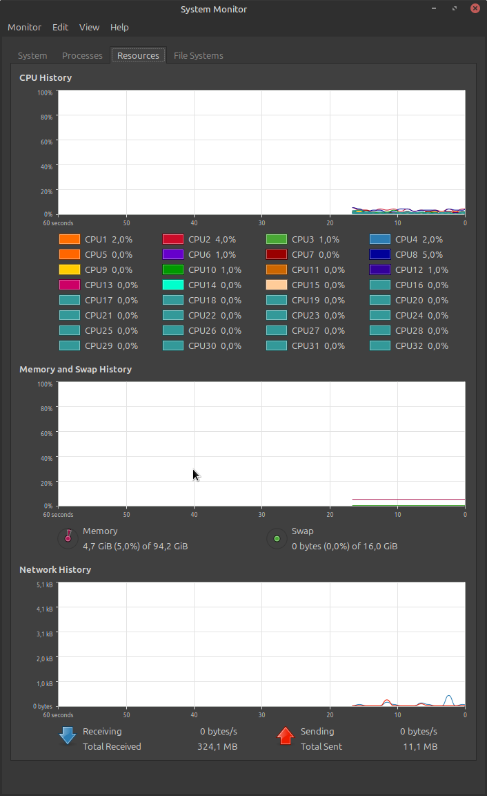

28 Jul 2026 20:37 #348154 by tommylight
Replied by tommylight on topic installing of linxcnc
It is a good idea to manually partitioning and don't use swap partitions (Modern computers with at least few GB of RAM not need swap.)
After you are done counting the CPU's, see lower on the right side, 16GB of swap space on a PC with 96GB of RAM memory. On laptops with 16GB of RAM i do 32GB of swap always.
Although you are correct that usually it is not needed, if you do need it and do not have it the PC will slow to a crawl.
28 Jul 2026 22:31 #348156 by tuxcnc
Replied by tuxcnc on topic installing of linxcnc
It's not like that...
The more memory, the more Linux reserves for disk buffers, which does not mean that it needs that much, or that it actually uses that much.
With 8 GB RAM, the Linux installer creates a 1 GB swap partition, which won't help anyway.
If you really need swap space, you can use a file instead of a separate partition.
The problem is basically that modern Linux stores the existence of the swap partition in multiple places, not just in the /etc/fstab file as it used to be, which results in the system failing to boot when the swap partition is deleted...
28 Jul 2026 23:00 - 28 Jul 2026 23:27 #348158 by NWE
Replied by NWE on topic installing of linxcnc
Sure you can delete your swap space and most stuff will just work. Some apps won't. SSD space is so much cheaper than 10yr. ago, do your pc a favor and allow at least 1GB swap space if you have to cut it short.
Long ago I read swap kills SSDs so I carefully removed swap from all my linux os. After a long time I learned some of my mysterious linux troubles were swap related (because I used no swap space). It seems most stuff just works without swap, but it hurts stability a little, even if you have more RAM than you'll ever use. Also, nowadays the OS and SSDs are designed in ways so swap is not so hard on SSDs.
Nowadays I  make sure to provide swap space bigger than my RAM. Like 64GB RAM and 90GB swap. This allows hibernation to work. Then I completely disable hibernation because I don't like it. go figure.
