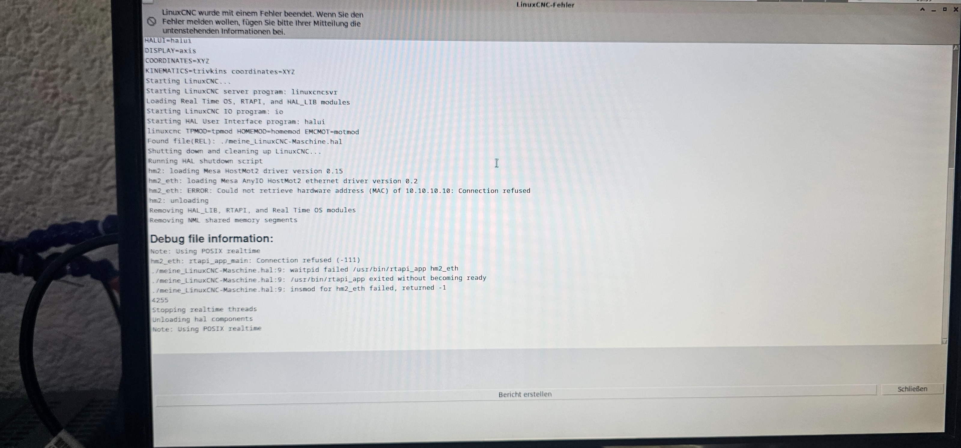

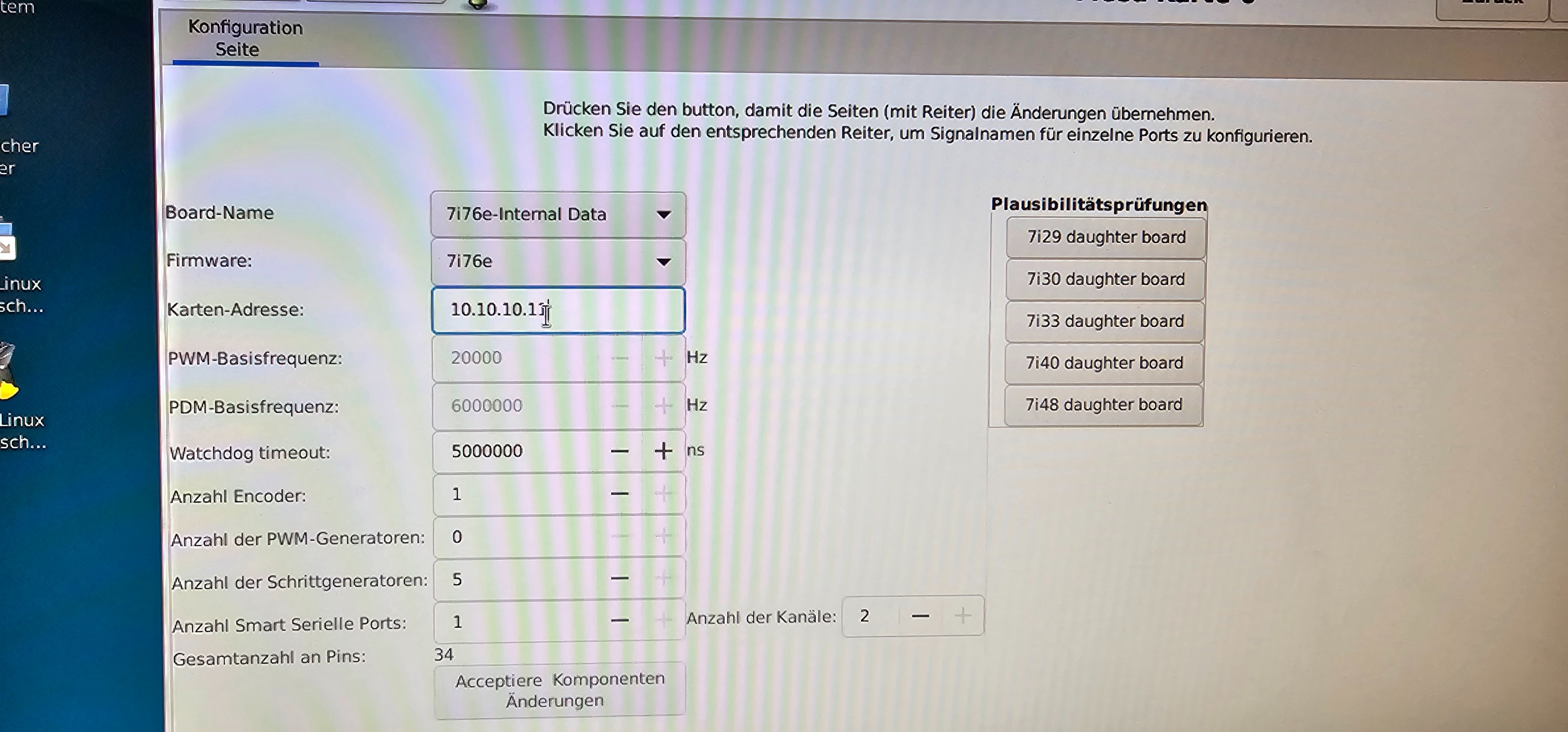

i am currently trying to setup my Mesa 7i95T but so far i hit a wall.
Problem is even after following a video to set it up via pncconf using the 7i76e, i get no working results.
The video i am reffering to :
Check the images to what im reffering to.
Perhaps there are files out for the 7i95T.

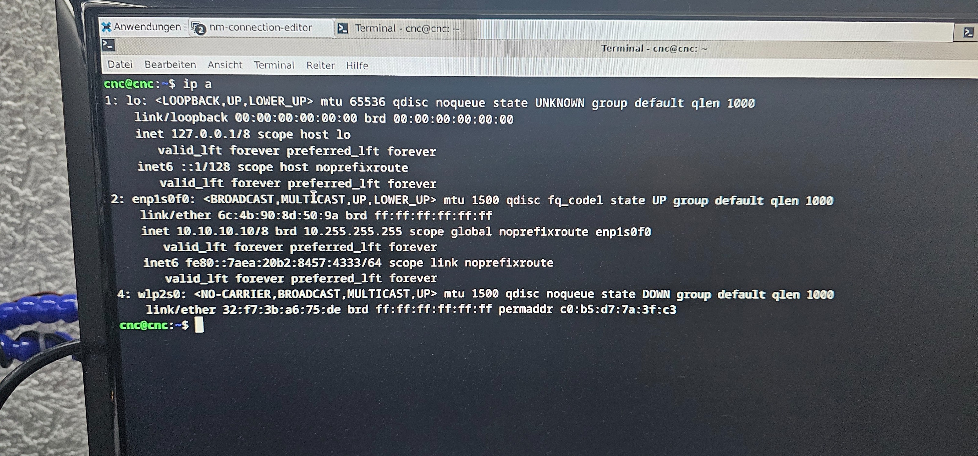

The error shows a basic communication issue.
1. Is the 7I95T jumpered for a 10.10.10.10 IP address
2. What does the command:
ip a
(typed in a terminal window) return?
ip a

Replied by tommylight on topic Setting up a Mesa 7i95T
Your PC has the wrong IP address of 10.10.10.10, it should be 10.10.10.11 or 10.10.10.111

1. Yes its set to that ( had that problem in the past but the forum helped with that)
2. Check the picture pls.

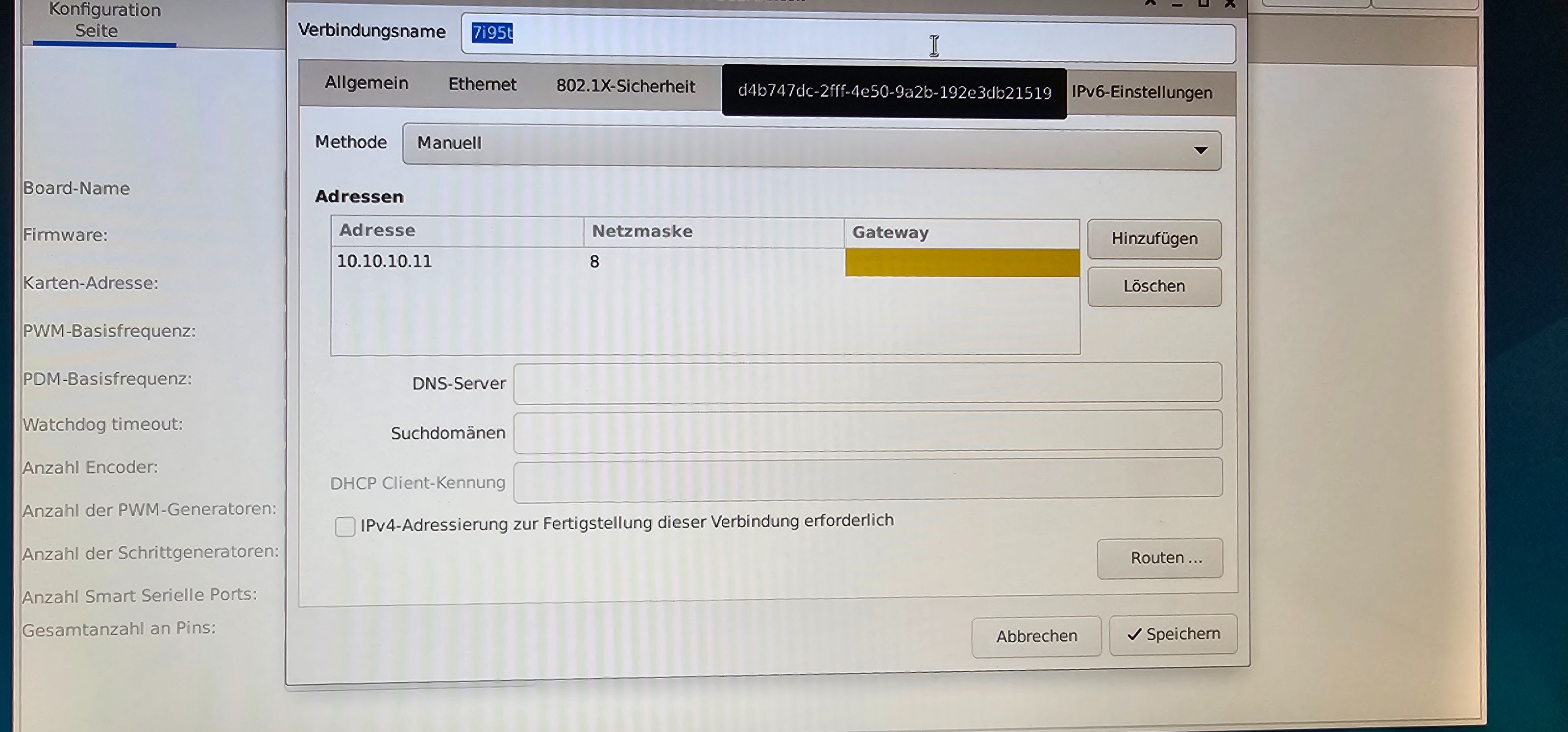

where do you mean that? @tommylight
In the networkmanager on the ethernet conection ?
Whatever you used to set the IP to 10.10.10.10 , use that and edit the last number to 11

I asume like this ?
- Posts: 21984
- Thank you received: 7483
18 Nov 2025 16:28 #338631
Left picture NO, back to 10 <<< that is the Mesa card address
Right picture YES, that is the network card address inside your PC
Disconnect and connect the cable again for it to work.

ok that worked.

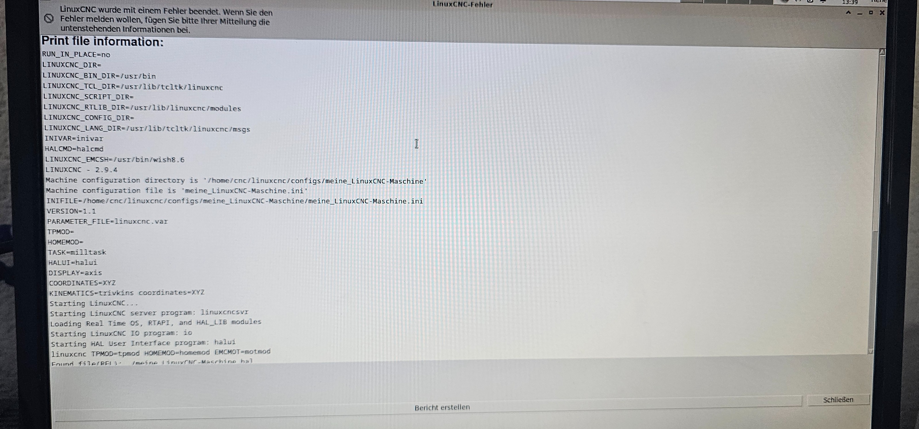

But it gives me a different error now, i do understand what it wants from me but thats it (total beginner here Sorry)
Debug file information:
Note: Using POSIX realtime
./Sindre_Mill.hal:86: Signal 'x-pos-fb' can not add OUT pin 'hm2_7i95.0.encoder.00.position', it already has OUT pin 'hm2_7i95.0.stepgen.00.position-fb'
7346
File is attached
if there is any other file you kneed let me know

Replied by PCW on topic Setting up a Mesa 7i95T
Are you intending on using encoder feedback?
If not (and this is an open loop step/dir system), you should not connect
the encoder pins ( like hm2_7i95.0.encoder.00.position ) to the axis feedback
signals (like x-pos-fb )
And vice versa, if you ARE intending to use encoder feedback, you should not connect
the steogen pins ( like hm2_7i95.0.stepgen.00.position ) to the axis feedback
