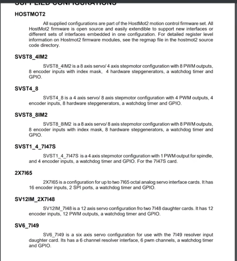

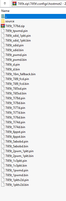

OK got the file but it tells me a whole lot of nothing i understand.
From what i understand so far is that there are bin files that are pre configured for the board.
Like in the second Picture attached.
In the first picture are what seems to me are such files which are provided by mesa.
Which basicly does nothing for me because i cant look into them or research which does what.
Trying my best to understand and get a hang of things.

Unless you have an added parallel daughtercard, it's unlikely you need
to change the installed firmware.
Since you are using pncconf that does not directly support the 7I95/7I95T
the list of pin names is useful since in has the names of the isolated inputs
like:
hm2_7i95.0.inmux.00.input-00
and isolated outputs like:
hm2_7i95.0.ssr.00.out-00
are there.
If you do not want to add these by hand to a pncconf created configuration
you could use mesact instead of pncconf, since mesact supports the 7I95/7i95T
directly
