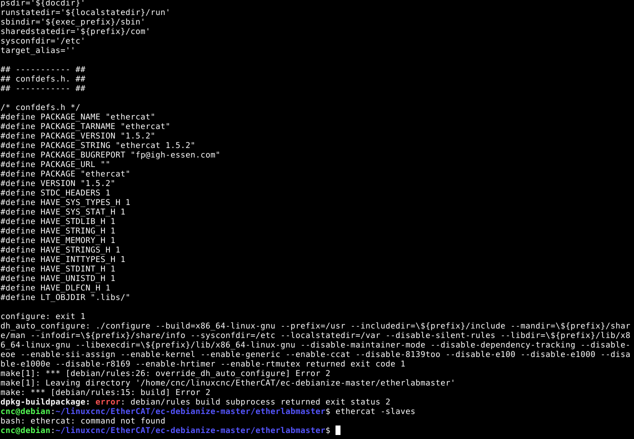

Hi all after installing a 2.8.2 linuxcnc distribution I'm having difficulties with ec-debianize .
As ar as dependencies go I have : mercurial, mercurial-common, mercurial-extension-utils, arch-test, dkms an quilt .
In /etc/mercurial/hgrc I added
[extensions]
mq =
And the net result o my effort is this :
Last time I got lucky and had absolutely no issues with that .
Any Ideas how I can get that going ?

The ec-debianize installation is a bit dated becasue the ether lab code base has migrated to gitlab. Mercurial is not required. Thy are now maintaining an unofficial repository so I Was able to install etherlab master from it. you can try this ( did it using the new linuxcnc debian repo now in debian maste unstable but buster is supported.:
open a terminal
sudo apt install geany curl
sudo geany /etc/apt/sources.list
insert this line at the end of the file
deb [allow-insecure=yes] https://download.opensuse.org/repositories/home:/bone11111:/branches:/science:/EtherLab/Debian_10/ ./
Save and close geany
enter these two commands to create a security key
KEYRING=/usr/share/keyrings/ethercat.gpg
curl -fsSL https://download.opensuse.org/repositories/home:/bone11111:/branches:/science:/EtherLab/Debian_10/Release.key | gpg --dearmor | sudo tee "$KEYRING" >/dev/null
sudo apt update
sudo apt install -y linux-headers-rt-amd64
sudo apt install ethercat-dkms libethercat libethercat-dev ethercat-master
ip a (and save MAC address of the NIC used for ethercat)
sudo geany /etc/ethercat.conf
set your Master0 device to your MAC address and device modules to generic
MASTER0_DEVICE="xx:aa:yy:zz:bb:cc"
DEVICE_MODULES="generic"
save and close geany
sudo systemctl enable ethercat.service
sudo systemctl start ethercat.service
sudo systemctl status ethercat.service
sudo chmod 666 /dev/EtherCAT0
Ethercat should be running. If the above command is not found, you have a problem
You can list the slaves if you type
ethercat slaves
