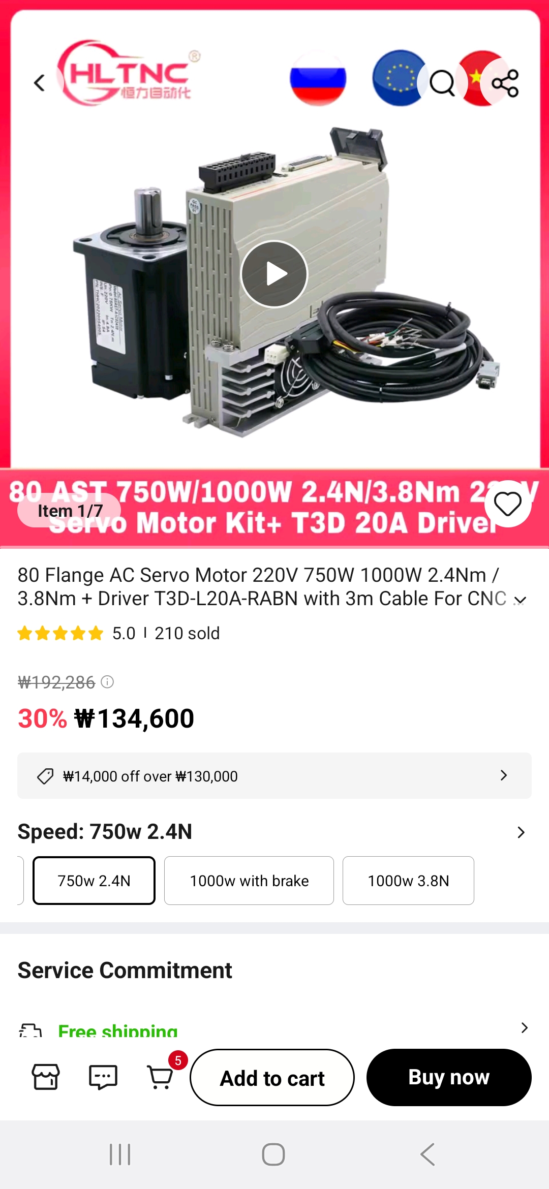

by Reyes
Hltnc servo motor was created by Reyes
- Todd Zuercher
- Posts: 4782
- Thank you received: 1472
05 Aug 2025 15:42 #332902
Replied by Todd Zuercher on topic Hltnc servo motor
Almost certainly, provided it is capable of accepting either analog velocity or torque commands, or digital positioning commands (step/dir or quadrature.) or can do EtherCAT.
- Posts: 18083
- Thank you received: 5316
05 Aug 2025 18:27 #332909
Replied by PCW on topic Hltnc servo motor
That particular drive (80 AST ...) does not seem to be EtherCAT
but they may have an EtherCAT model.
