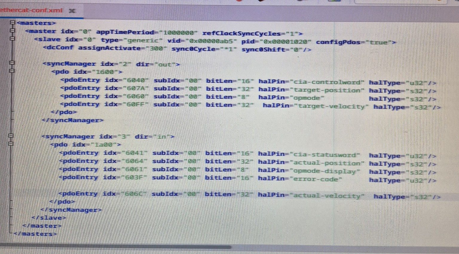

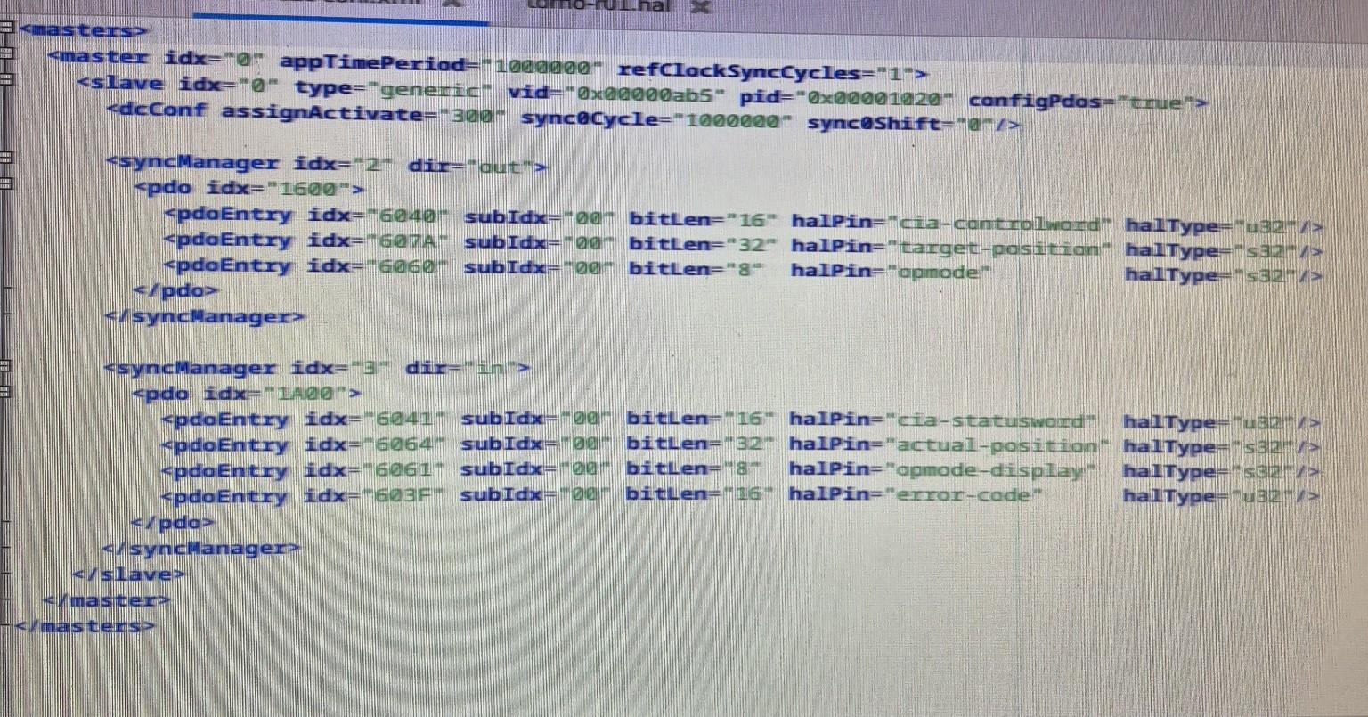

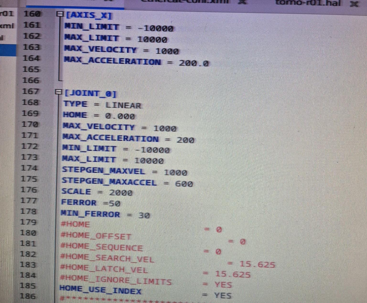

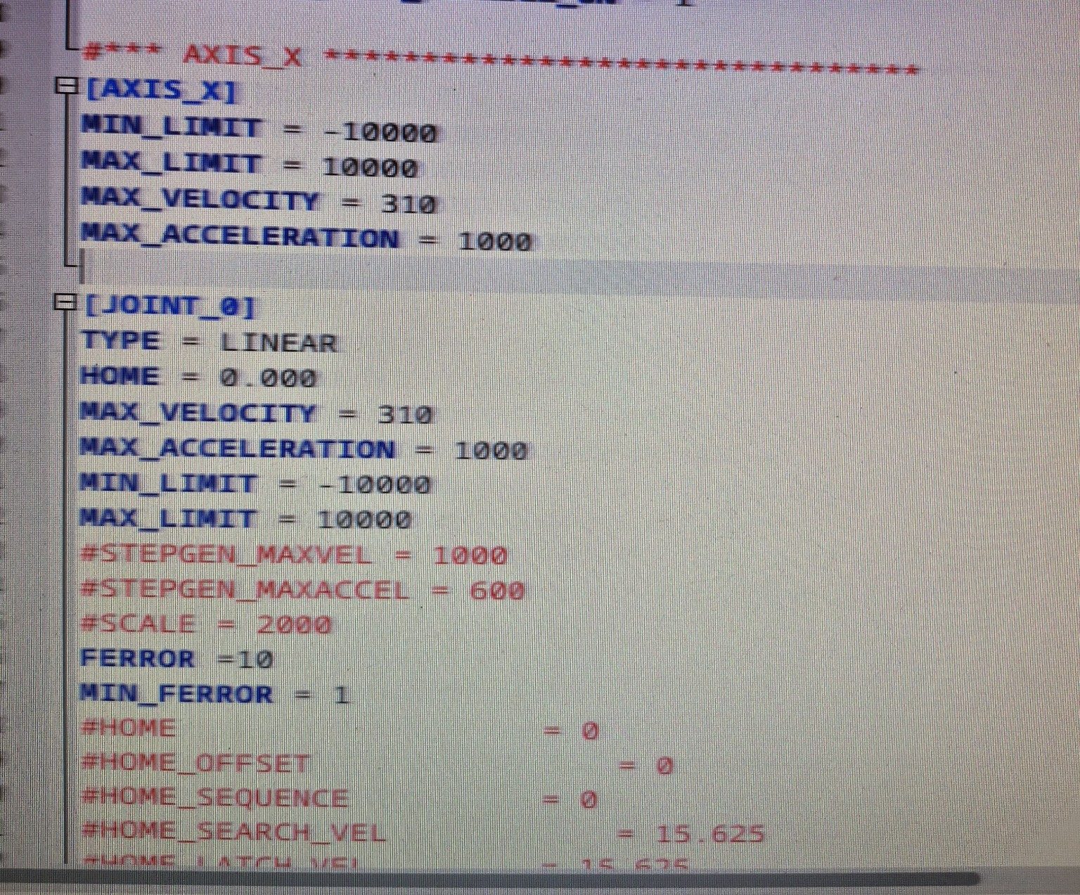

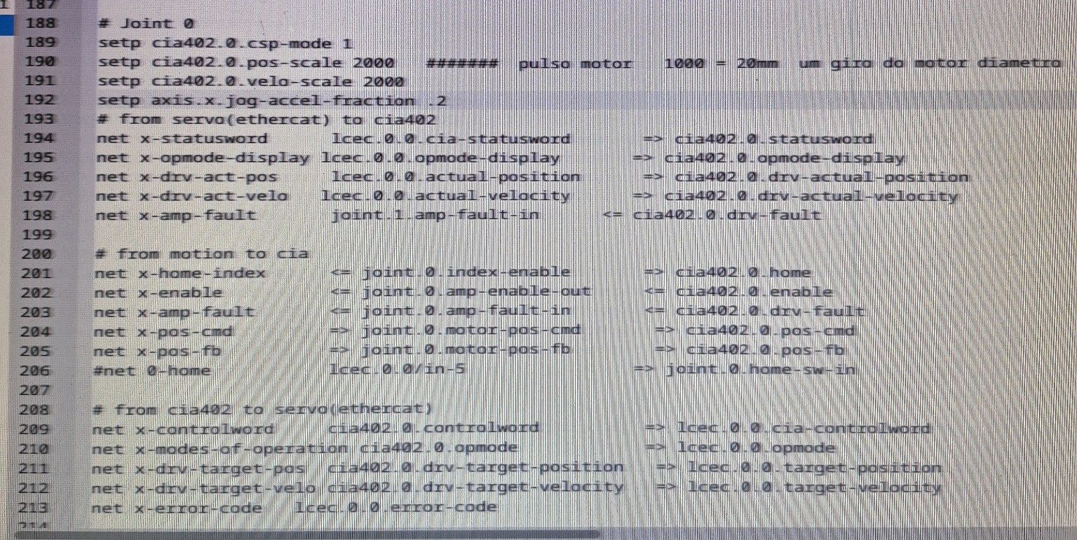

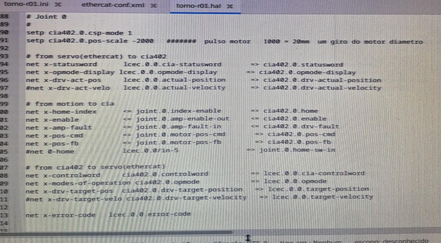

1 month 1 week ago - 1 month 1 week ago #349896
by leandrocontarini
Replied by leandrocontarini on topic XML Settings for EC1-57E
Last edit: 1 month 1 week ago by leandrocontarini.
- leandrocontarini
- Posts: 15
1 month 4 days ago #349995
by leandrocontarini
I managed to get it working. Here are the files.
