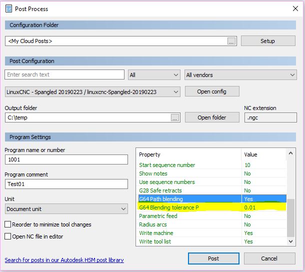

, here is a copy of the Fusion 360 Post Processor, which I have modified as follows:
1) Added G64 to G Code preamble - can be enabled or disabled from the Fusion 360 Post Process dialogue as shown below.
2) Added the P value for G64 - this can also be modified from within the dialogue.
3) Added DEBUG command into tool comment during tool change so notification box pops up on the screen prompting for the tool to be used.
Let me know if this is useful and if you have any comments. In the thread mentioned above, it was suggested that a different P value would be useful for roughing/adaptive moves, which makes sense, however this is more challenging to code - particularly as I'm not a developer - it took me a while to work out what's going on in the post to get this much done!
All modified or added lines have been commented with //Spangled - search for these to check what I've done.
As usual, you test this file at your risk - it's not my fault if your machine crashes or your house catches fire etc. Check the output before running it on a physical machine!

This is excellent, Spangled. I'm currently working off of your post and trying to add to it so that any operations with an explicitly specified smoothing factor will add a G64 with the operations "smoothingFilterTolerance" variable as the P value.
That'd be a perfect setup, overall G64 P0.010 or so for roughing (in Inches) so fast roughing doesn't get too crazy, and then a per-operation specific G64 P0.00n to dial in where precise motion is needed.
BTW I have verified that your post works in HSMWorks as well.

OK all, here's what I ended up doing.
I was going to start with Spangled's post, because I was going to have an overall G64 P0.0x value, combined with a per-operation G64 P0.0x value based on if the operation has a "smoothing" parameter applied.
But then I thought, that's not really what the smoothing is for. What we're really talking about is the overall tolerance of the operation, and a lot of operations which may need tight tolerance machining at high speeds may not have a Smoothing parameter, or you may not want to use Smoothing just to get your machine to not round corners under acceleration.
So I made it post out a G64 P0.0x block on every operation, which inherits the Tolerance value from that operation. (I am aware that this will actually result in a tolerance zone of double the input tolerance value. I'm fine with that, though it will undoubtedly cause some confusion. Fine for my purposes, I'll just put a conservative tolerance zone in there.)
I'm going to try using it like this for a bit, I haven't used it to run a machine yet, so keep yer finger on the E-stop button until you've run a test program.

98% of what I do is 3d parts in wood, so G64 is on most of the time. Does make me think I should put some code in the post which automatically switches to G61 if the operation tolerance is set below 0.003"/0.08mm or so, since the programmer's intention is to make a part as accurately as possible at that point.
