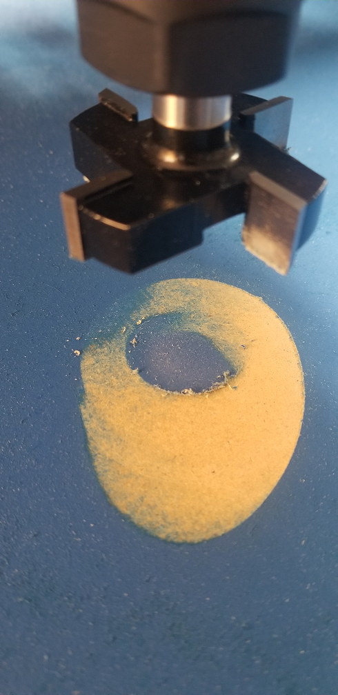

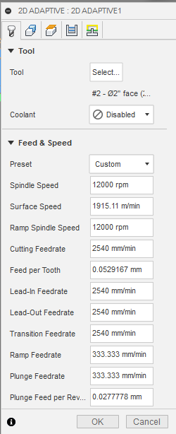

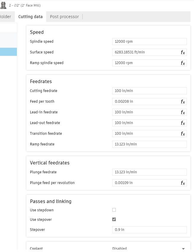

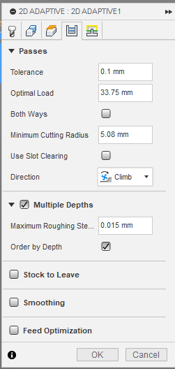

I am not sure what I am doing incorrectly, clearly not understanding settings in F360 for spoilboard surfacing using 2D Adaptive Clearing.
I chose 2D Adaptive Clearing because my spoilboard model in F360 is sized to maximum usable area of DIY PintNC machine, 24"x38"and there is no available X-Y to accommodate overrun of the tool, limit switches would be reached. From hat I gather, the 2D Adaptive Clearing keeps the tool within the confines of the spoilboard dimensional limits.
The tool of choice is a BINSTAK 4-flute, 2" diameter, 1/2" cut length, 1/2" shank, and 2.5" OAL. The bottom-most edge of the flute cutting edge is 1-1/16" below the spindle collet. In F360 it is defined as a Face Mill, tool parameter definition in attachment.
I know the right side of my spoilboard sits higher than the left, maybe 1-1.5mm. I thought about adjusting the difference mechanically but that would require too much machine disassembly, so I am hoping surfacing can rectify the issue even if it means more material needs to be removed on right side.
My issue is shortly after the job starts it would appear cutter is trying to take too much material and the spindle is bottoming out, see attachment. The Bottom Height is from Selected Contour with Offset of -1.0mm. Top Height is Stock Top, Offset of 0mm. The "Passes" Multiple Depth step setting originally started out at 0.1mm, didn't work. Changed to 0.02mm, didn't work. Just tried 0.015mm, didn't work.
Would those with the devine knowledge please review my settings, and if a better solution is warranted, please advise. Thank you.

I would jog to the lowest point, touch-off the tool to zero there, and ask F360 to mill down to zero over the whole area.

I don't think my program is quite correct. Once the level zero iteration completes the drop to next layer cut down doesn't seem to be taking off any material, the flutes appear to be still at level zero and this is true for every successive pass. Could use a review and feedback on the program. Its my first, so I am sure there must be a mistake I am not seeing. Thank you.
Replied by Lethal69GTO on topic Spoilboard Surfacing - 2D Adaptive Clearing - Tool Bottoming Out
Thanks. I gave up with using F360 to define the setup and program, seemed nothing I tried could alleviate boundary issues. So I rolled my own toolpath program cutting left-to-right one direction only and front to back. I set Z touch-off zero to the highest side not wanting to overload the spindle again where it comes to a stop with the thought process to take the high side off first and work its way down to low side elevation. Not using tool table.I would jog to the lowest point, touch-off the tool to zero there, and ask F360 to mill down to zero over the whole area.
This assumes that the tool can physically reach, of course.

After a quick glance I don't see anything horribly wrong with your program.
If you artificially set your Z0 about 25mm above the stock and comment out the M3 then run it, does the DRO display the programmed height at the 2nd pass? i.e. Z-0.064mm?
If it does display the correct Z height, if you've got the means maybe you can stop it and measure if the Z is actually where its supposed to be.
That's a really small distance (about 0.002" I think)... maybe a couple of lost steps or frame flex and the cutter is only making dust?
Have you tried doubling the depth of cut per pass?
PS - This might also be a good time, perhaps once you get through this, to look in to incremental programming and subroutines. Off the top of my head I think this program could be done with about 20 lines of code. You could set up some variables in the program (cutter dia, rpm, travel limits, cut depth, stepover) and have a nice template for spoilboard surfacing that's easy to use for different tools.
