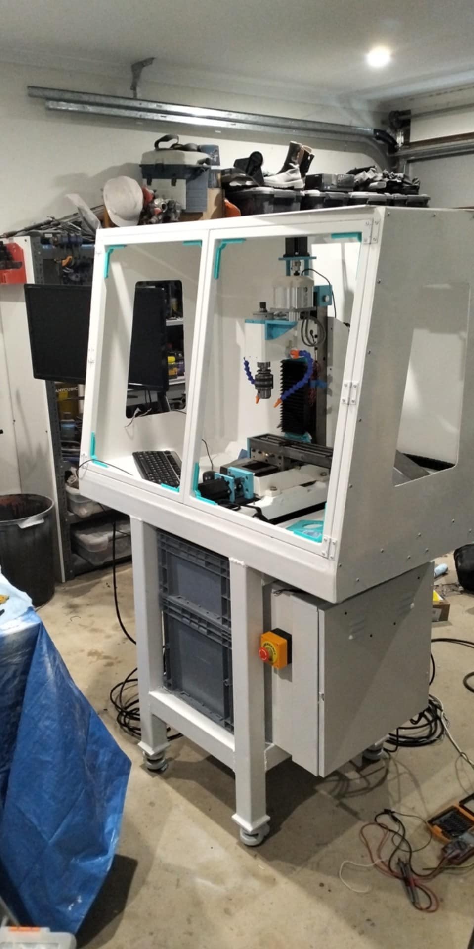

Hey guys,
So most of my machine is running and I'm in the testing phases (Just have a sharpie in the spindle drawing stuff on carboard) before actually cutting anything and I've noticed what when I post my G code from Fusion360 and move the NC code into linuxcnc I get (Unknown G code used).
Now I figured there was un-supported G codes so I checked the list of un-supported G codes and editing them out of the NC and it made no change. But If I delete the entire Top few lines of the NC it then works fine (For simple line sketches haven't tried anything more complicated)

So my question is really, why is this happening? When I was running mach3 I could just drop my NC program in like this and it worked fine, and two is there a way to set up Fusion to post on NC code that WILL run on linuxCNC or will i have to edit each program like this to get it to run?

There is a Linuxcnc post in F360. It may be called EMC. I never had to modify anything.

Yuhp I found it -_- Sorry guys
