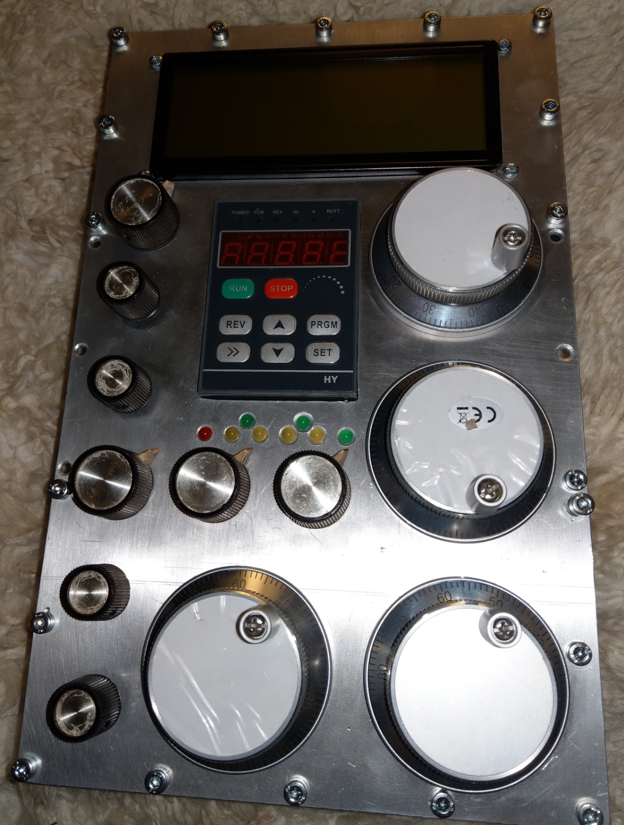

Hi
I have a big hardware (7i73) panel that allows me to do all kind of jogging i need.
I do not use screen based jogging.
I wonder if there is a way to replace that "window" with another. Only in the same mode that it is shown today. I'm thinking to have there some buttons for semiautomatic threading with i have seen at an old felman mill.
Thx

You can replace the jogging button with a logo, gmoccapy has an undocumented option for that.
It is not possible to replace the button with a glade panel, without touching the glade file and eddit the gmccapy.py file.
Norbert
