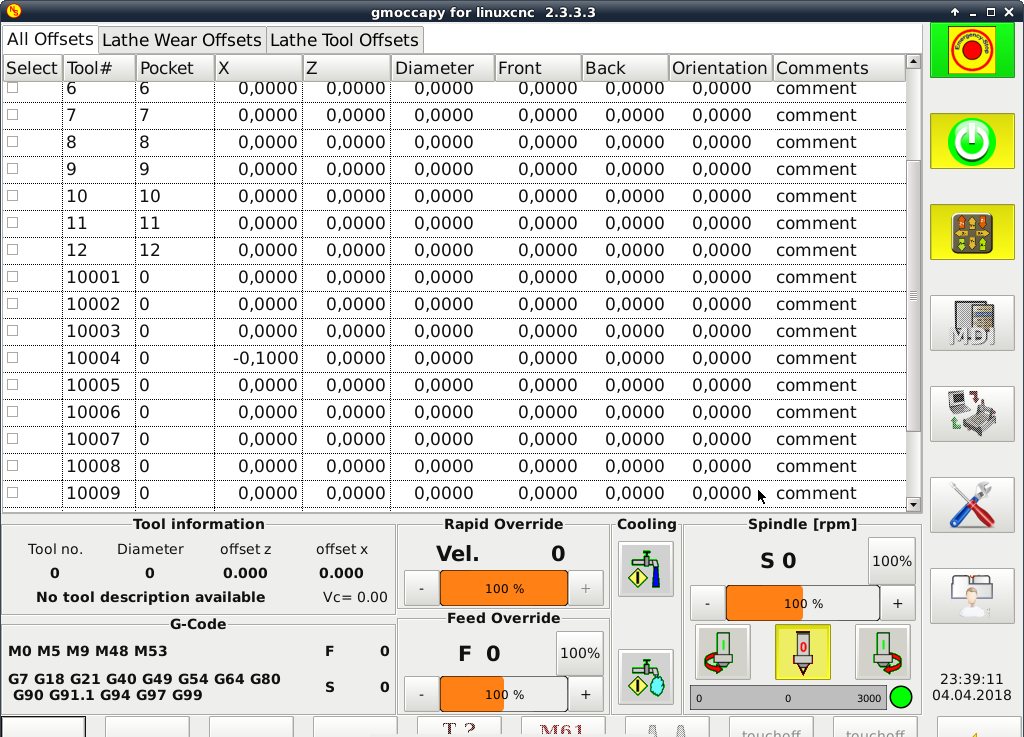

Lathe tool wear was created by dinkata
- Posts: 19902
06 Apr 2018 12:43 - 06 Apr 2018 12:43 #108495
Replied by andypugh on topic Lathe tool wear

- dinkata
- Posts: 101
07 Apr 2018 05:01 #108543
by dinkata
Replied by dinkata on topic Lathe tool wear
Linuxcnc 2.8.... pre .....gmoccapy 2.3.3.3does Gmoccapy do wear-offsets in the UI?
...is it possible to enter into Linuxcnc2.7.12 gmoccapy 1.5.9 ?Take a look at the lathe_fanucy sim config

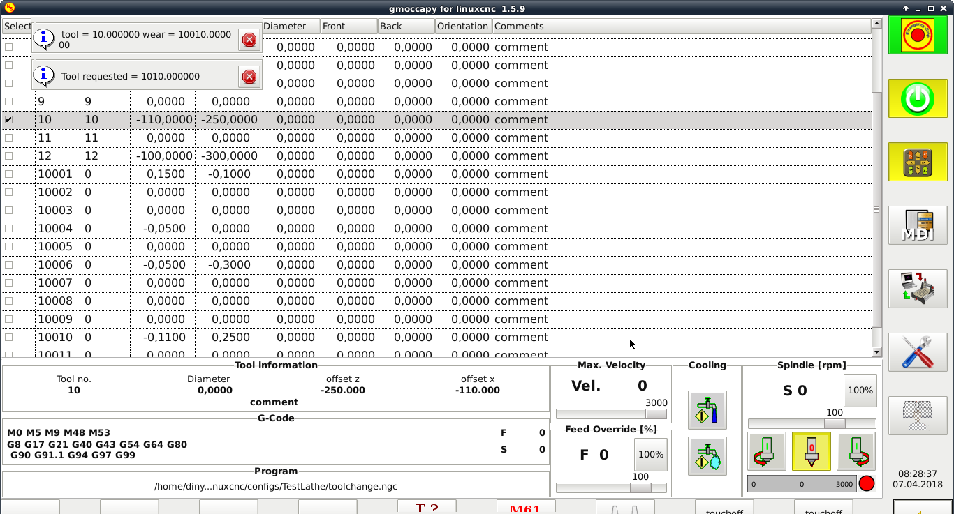

07 Apr 2018 05:38 - 07 Apr 2018 05:42 #108545
by dinkata
M6 T#<tool>
G43 H#<tool> ##### OK
but :
O100 IF [#<wear> GT 10000]
G43.2 H#<wear> ##### ???
..I think it does not work : see picture, 10010 is not show !

- Posts: 19902
07 Apr 2018 10:52 #108551
I don't know how tool handling works in Gmoccapy. It looks like it might have its own (larger) tool table.
If you look at the actual tool.tbl file with a text editor, are the offsets there?
I feel that I might be leading you in the wrong direction here, it is entirely possible that Gmoccapy handles wear offsets at the user-interface level.
