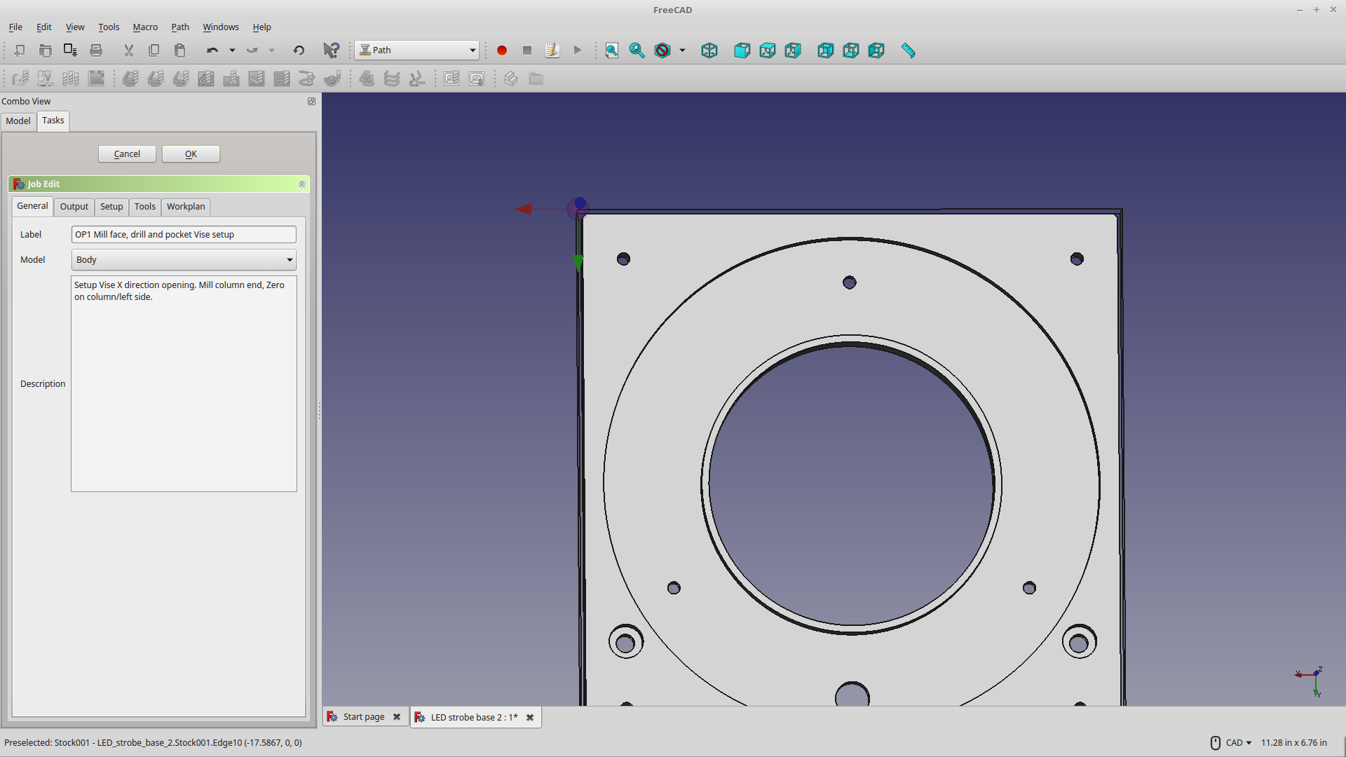

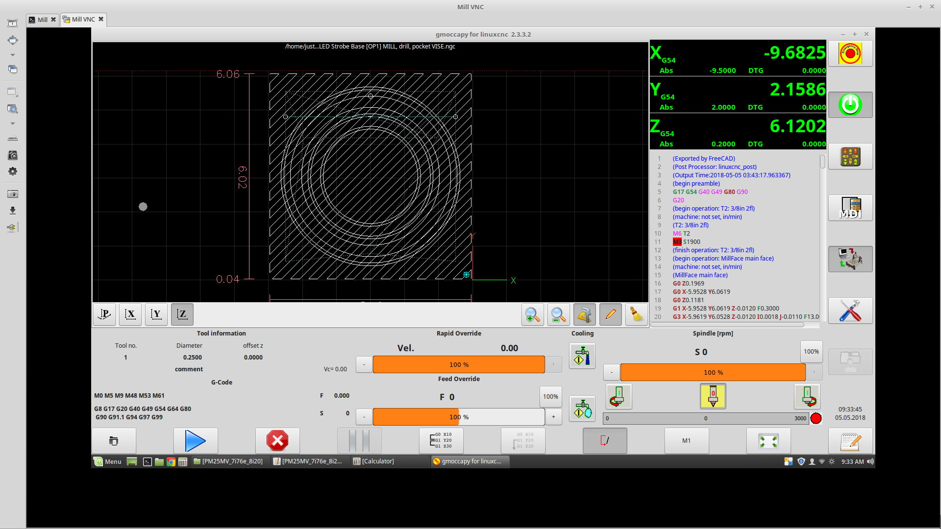

I searched around but couldn't find anything. I can't quite figure out why everything I load into LinuxCNC appears upside down in Gremlin with Gmoccapy. I (almost) always set my origin and zero my mill on the perceived upper left hand corner of the part. Gremlin always shows it as the lower right hand corner. Movements are correct in the fact that if I zero on the positive side then move negative I am moving toward the center of the part, it's just that the XY is viewed in reverse. Z is fine, I doubt it's a machine setup issue since I can move in the correct direction and have ran parts from CAM, just not sure what to do to get the appearance in Gremlin correct.

Gremlin does use the correct coordinate system, Showing X positive to the right, Y positive away from the user and Z positive from the table up. If you are using a different coordinate system, the image may switch around.

I have to orient the part in cam (FreeCAD) the opposite way to get the correct movements. I place the Origin in the far left corner with X+ to the left and Y+ to the right. This would expect the tool to move X- or right to reach the right side of the part where on a mill the table will move X- which is left for the tool to reach the parts right side. So it would probably be correct if this were a Gantry router.
SO I'm not sure If I have to throw an argument at the post processor or what exactly I'm missing.

You can do what you want, but I am pretty sure, that your INI file does not have the limits set correctly, please post your INI.

There's 1 limit on each axis and the soft limits are set to max travel, this works fine. Max travels are extended so I can move the axis the full ways when it's unhomed, that may not be correct.
Replied by blazini36 on topic Gremlin shows incorrect orientation
Not sure what that means. Obviously I'm not sure what I'm doing wrong, or if there's something I can change. So I'm asking for help.You can do what you want, but I am pretty sure, that your INI file does not have the limits set correctly, please post your INI.
Norbert
