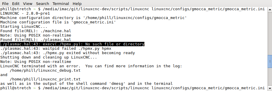

I am getting a twopass error when loading a userspace component from a .tcl HAL file in Gmoccapy.
The same component using the same .tcl HAL file loads fine from Axis.
I tried the last three lines (one at a time) of the .tcl file and the behaviour was identical.
I then tried a .hal HAL file using the last two lines (one at a time) and again the behaviour was identical.
Gmoccapy terminal output:
Warning: Spoiler!

- phillc54
- Posts: 5711
- Thank you received: 2100
03 Oct 2019 01:39 - 03 Oct 2019 01:45 #146937
by phillc54
Replied by phillc54 on topic TWOPASS error (should be User Error)
Last edit: 03 Oct 2019 01:45 by phillc54.
