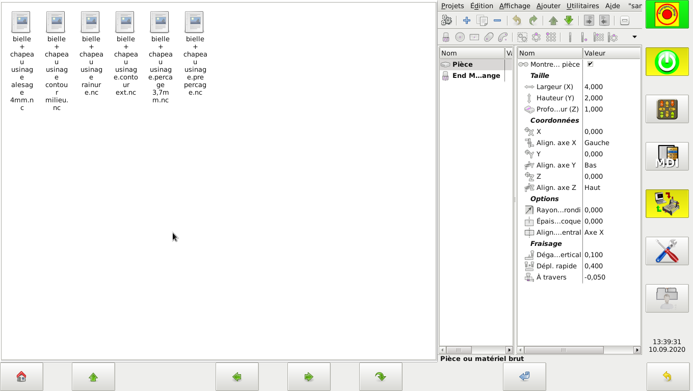

How change "load file" with gmoccapy

10 Sep 2020 12:13 #181617
by bruno2626
How change "load file" with gmoccapy was created by bruno2626

Replied by newbynobi on topic How change "load file" with gmoccapy
You will need to change the coder from the widget iconfileselector.
Or you change you file names. The long beginnings are the same for all files you showed.
Why not order them with directories and make the names shorter?
There is no setting for that purpose.

12 Sep 2020 16:38 #181899
by bruno2626
Replied by bruno2626 on topic How change "load file" with gmoccapy
Thanks newbynobi. I found "iconfileselector" in gmoccapy.py but I don't know how to go further. You have to search in another file?
That's true, my filenames may be unnecessarily long. This is often the case with Cambam too.
Bruno

15 Sep 2020 14:36 #182237
by newbynobi
Hallo Bruno,
the changes must not be done in gmoccapy.py.
You will need to modify iconview.py. The file should be placed in the lib folder in some subfolder.
Norbert
Norbert

19 Sep 2020 19:46 #182777
by bruno2626
Thanks newbynobi,
I couldn't find iconview.py anywhere!
I think I've searched a little bit everywhere, but found nothing.
Bruno
Bruno

26 Oct 2020 16:07 #187324
by chrisfairbrother
Replied by chrisfairbrother on topic How change "load file" with gmoccapy
Hi, I struggle with the file name format as well. Fixer has produced a modified version of iconview.py. The location of the file is explained in the head of the file. I use this modified version in my setup. I can’t tell you the version of linuxcnc I use as I am not at home. Here is the link to fixer’s file
forum.linuxcnc.org/gmoccapy/31746-iconview-filebrowser#82004
Chris
