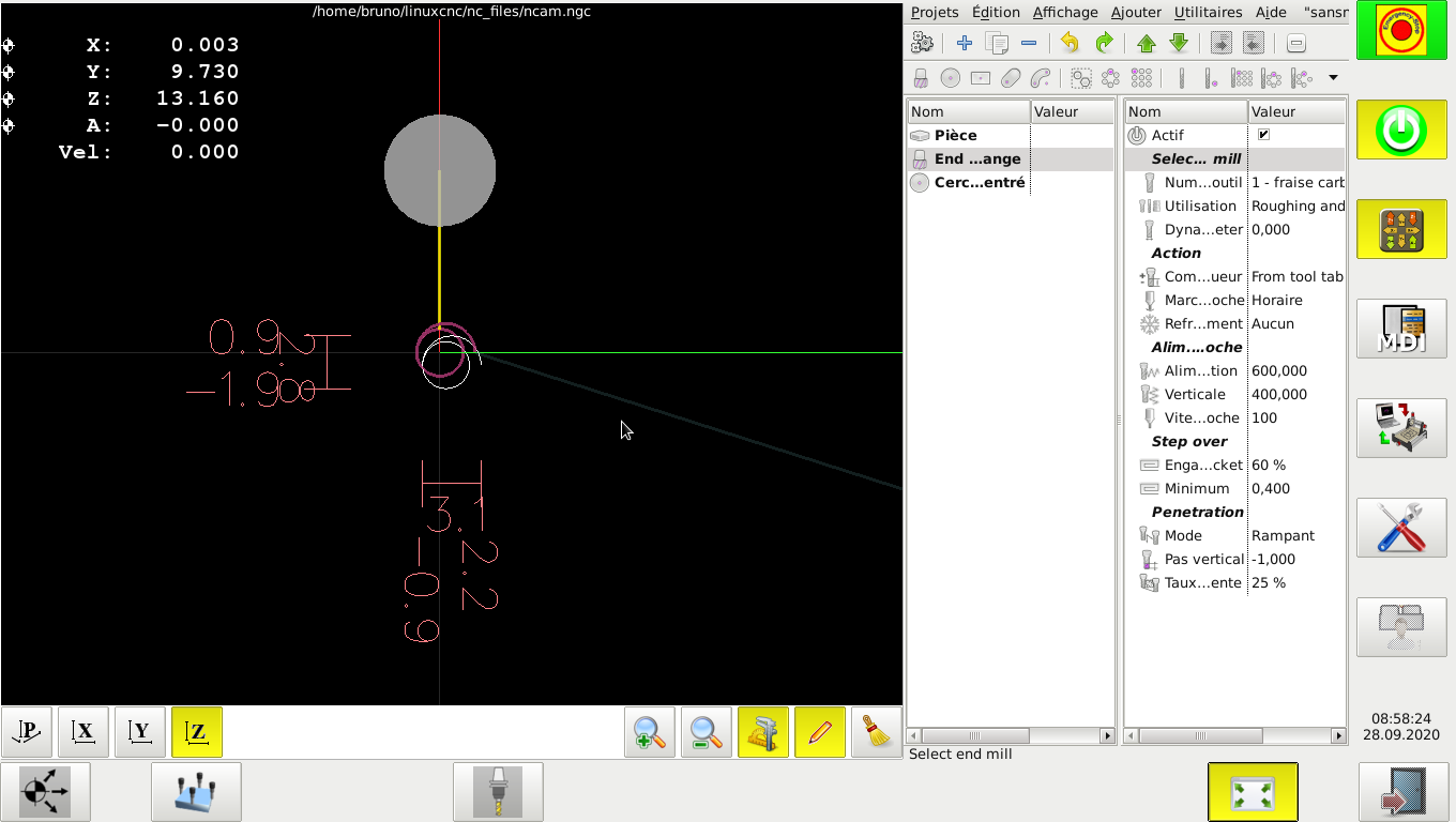

After fixing other problems and upgrading to LCNC 2.8, I come back with my machining limits problem.
Here is what I get (a simple spiral drilling with nativecam normally oriented at x0 y0):
The planned toolpath is shifted by a somewhat random value. The real toolpath is in the right place. I don't have this problem with axis display.

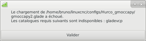

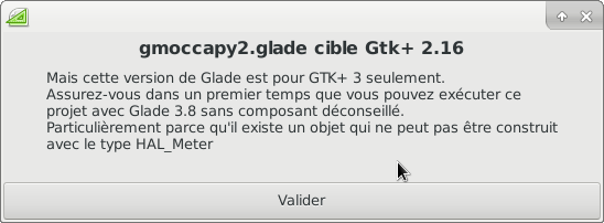

Can this have something to do with a gladevcp problem? This is what I get if I try to open gmoccapy2.glade:

You can not open the glade2 file, cause you have glade3 installed, not glade 2. We are working on a glade3 and python3 release, but this will take some time.
The displacement is know, it is just a grafical issue, due to rounding numbers and inaxecat maths in glemlin view. I looked at this a while ago and was not able to fix it. I will not put any affort in fixing that, because of working on a python3 release together with other developers.
just to check, if your offsets of g54 are at a exact value, like 15.000 or 120.000 the displacement should not be visible. Is that right?
If not, I will need to look at this.
Hope I got your understanding for the inconvinience.

Concerning the x and y shift, it seems to be that, I find in the shift the decimals of g54. However, I don't understand why g54 offsets are included in the calculation of machining limits. For my culture and because I am curious, where is the calculation of these limits done? In which file? This calculation is different with axis?
On the other hand in Z, the limit is sometimes in red, therefore out of the frame, whereas in reality the course is well within the frame and that in manual I can reach these coordinates with a lot of margin.

You need to take G54 offsets to the calculation.
Just imagine you put G54 to Absolut 10 10 10, so you are 10 mm away from Machine limits.
Now try to mill a circle with 100 mm diameter with center to be G54 0 0 0.
This would pass your limits!
I have not found a single file, but a bunch of not documented files. If you like, just begin to look at /lib/python/gladevcp/gremlin.py
As me and other developers are working on the shift to python3, I would not invest any time to fix a cosmetic bug. Gremlin need to be rewrite completely to be adapted to python3, that would hopefully also fix the misbehavior you see.
