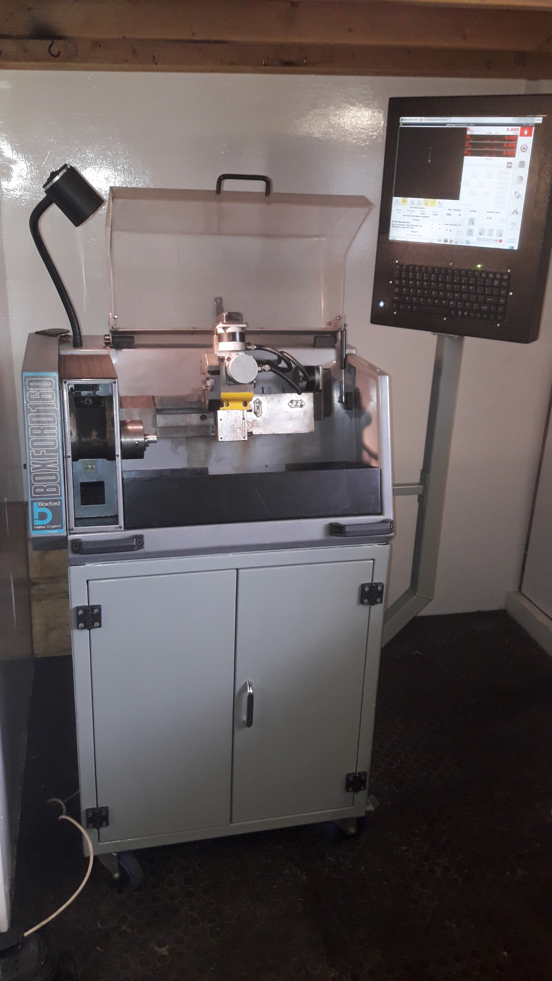

The console I'm working on won't be 'shared' accross differant machines, it will be a design that each machine can use individually. I plan to sell this lathe, then move on to the Milling machine using the console design.
Take a look so far:
Boxford B160TCL
Thanks.
Take a look so far:
Boxford B160TCL
