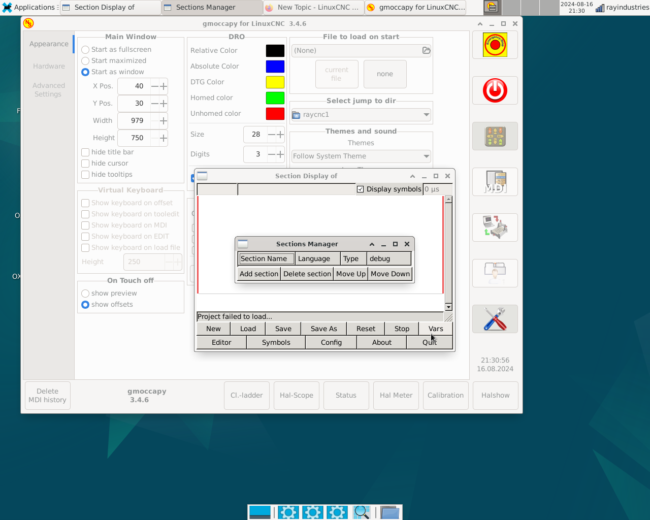

I was configuring a LCNC setup 2.9.2. I used PNC config.
Now, classicladder program is not loading automatically. It can be loaded from LOAD option in classicladder window.
HAL, INI, custom.hal file attached.
What wrong I did?

Try adding this to the bottom of your custom hal file. Make sure you replace <your_file.clp> with the one you want to load on startup:
# Load Classicladder without GUI (can reload LADDER GUI in AXIS GUI
loadusr classicladder --nogui <your_file.clp>

It worked. Many thanks
