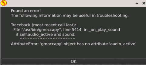

found an error! audio_ative
- Moutomation
- Posts: 154
- Thank you received: 11
03 Sep 2024 04:32 #309256
by Moutomation
found an error! audio_ative was created by Moutomation
- Moutomation
- Posts: 154
03 Sep 2024 06:57 #309267
by Moutomation
Replied by Moutomation on topic found an error! audio_ative
I fixed it by editing the necessary lines.
- Posts: 7368
- Thank you received: 2181
03 Sep 2024 13:04 #309284
Replied by cmorley on topic found an error! audio_ative
What version of linuxcnc and what was your fix?
- Moutomation
- Posts: 154
03 Sep 2024 18:21 #309299
by Moutomation
I am using the image shared by Rodw for Raspberry Pi 5 in the ethercat installation topic.
- Moutomation
- Posts: 154
03 Sep 2024 18:23 #309300
by Moutomation
I deleted the lines related to the sound that gave the error and now it does not give any error.
- Posts: 4819
- Thank you received: 2176
04 Sep 2024 06:24 #309340
Replied by Aciera on topic found an error! audio_ative
Not sure which version your image uses but there was a fix for this in gmoccapy that seems to have missed the release of 2.9.2:
github.com/LinuxCNC/linuxcnc/commit/760f...de07ea08b3f00b09b57f
