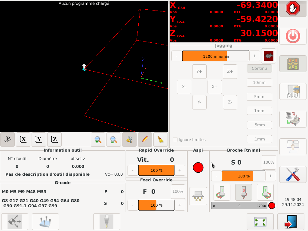

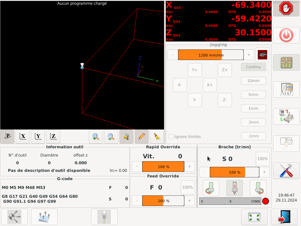

I like my linuxcnc machine to be ready automatically. The session opens automatically and launches a little script that waits a few seconds, launches my linuxcnc config and offers to shut down the system when I leave the linuxcnc interface.
This script works very well, even on another machine at work. But I'm having a little problem with a custom embedded tab in place of the cooling buttons I use to control my dust collector.
When I run my config by hand, it usually displays correctly, but with autostart, my button is missing. Even without using my little script or extending the delay.
It's a LinuxCNC ISO that's a bit old (maybe two years) but updated, so maybe that's the problem, because at work, on a machine where I've used a more recent ISO, I don't have any problems.
My current LinuxCNC version: 2.9.3
GMOCCAPY: 3.4.8
I've attached my script, my ini file and two screenshots
It's quite strange. But it doesn't matter.
I'm curious to know what could be the problem.

I use :Then I saved the output in the attached file.
This is an error related to the toggle.1 function in the HAL file for the dust collector button.
I was able to solve my problem with this information!
My “loadrt toggle” was in the “postgui.hal” file, I moved it to the “machine.hal” file.
For some reason, the “postgui.hal” file isn't loaded at exactly the same time when it's an autostart and when it's a manual start.
In any case, now it's cleaner and more stable.
Thanks for the help.
I use :
xfce4-terminal -x linuxcnc '/home/axel/linuxcnc/configs/mini-cnc-tc-dust/mini-cnc-tc-dust.ini'This is an error related to the toggle.1 function in the HAL file for the dust collector button.
