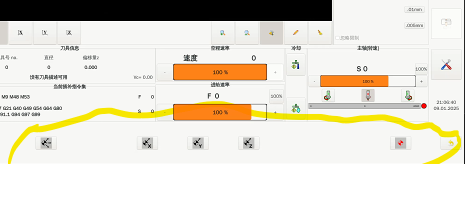

by dabiaoge6699
gmoccapy was created by dabiaoge6699
我修改了 GMCPCAPY 接口以适应 2K 显示器。我更改了大部分图标大小,但我无法更改这几个图标大小。谁能帮我

Replied by zz912 on topic gmoccapy
You should change glade file:
github.com/LinuxCNC/linuxcnc/blob/master...ccapy/gmoccapy.glade
in glade editor.
Or you can use:
User Command File
linuxcnc.org/docs/stable/html/gui/gmocca...l#_user_command_file
in glade editor.
Or you can use:
User Command File

by HansU
Replied by HansU on topic gmoccapy
In the glade file only the button sizes can be enlarged. But only those ones that are not being generated.
The icon sizes can only be enlarged in the code. So the easiest is to do that within a user command file. Simply increase the icon sizes in the file attached. But keep in mind that this works only from the start until you change the icon theme in the settings.
AND please write in English. You can't expect that the people you want to get help from are willing to do the extra work and copy your text into a translator.
Also this could be treated as spam and be simply deleted. Other languages are welcome in www.forum.linuxcnc.org/37-international-linuxcnc-users
