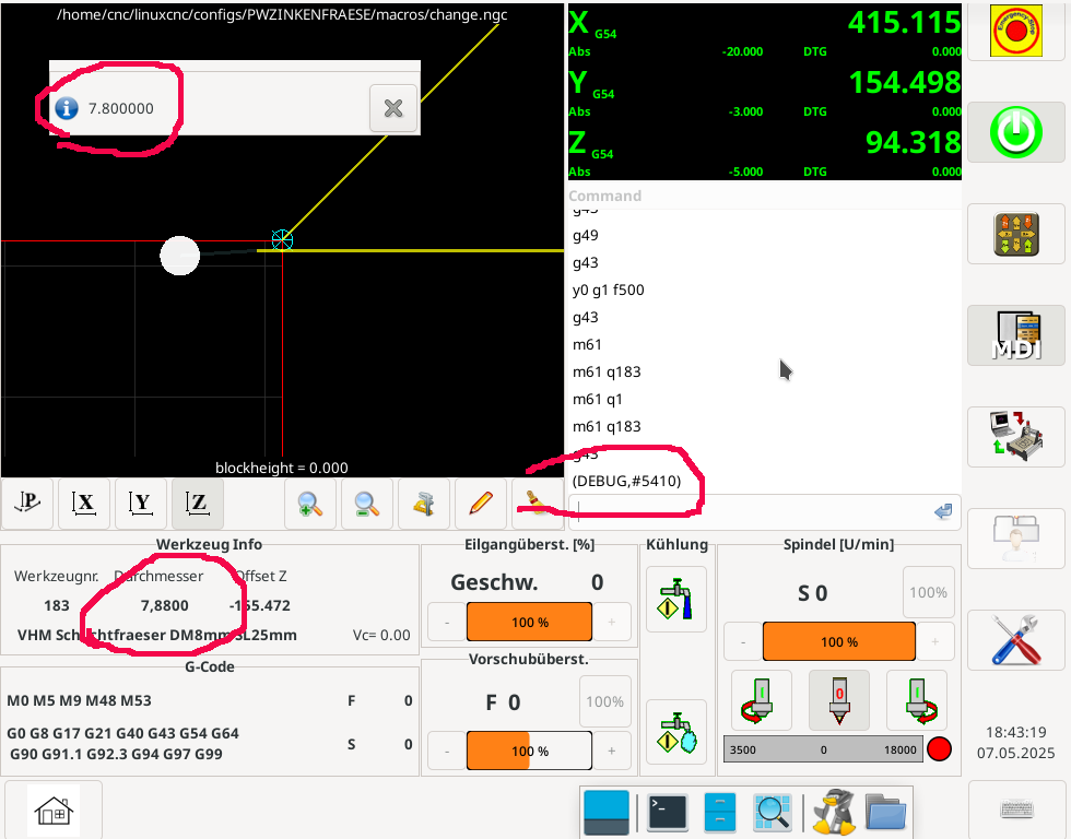

07 May 2025 16:50 - 07 May 2025 19:34 #327952 by hermann1976
Replied by hermann1976 on topic Change Tool Offsets after editing the Tool Table
Thanks for your answer. Attached the result.Linuxcnc works with the changed value. But the GUI doesn't recognize the change.

07 May 2025 21:55 #327961 by MaHa
Did you try, if the GUI updates changes in tooldata this way? Be aware it uses toolradius
G10 L1 P#5400 R
linuxcnc.org/docs/2.9/html/gcode/g-code.html#gcode:g10-l1
otherwise i have no idea
