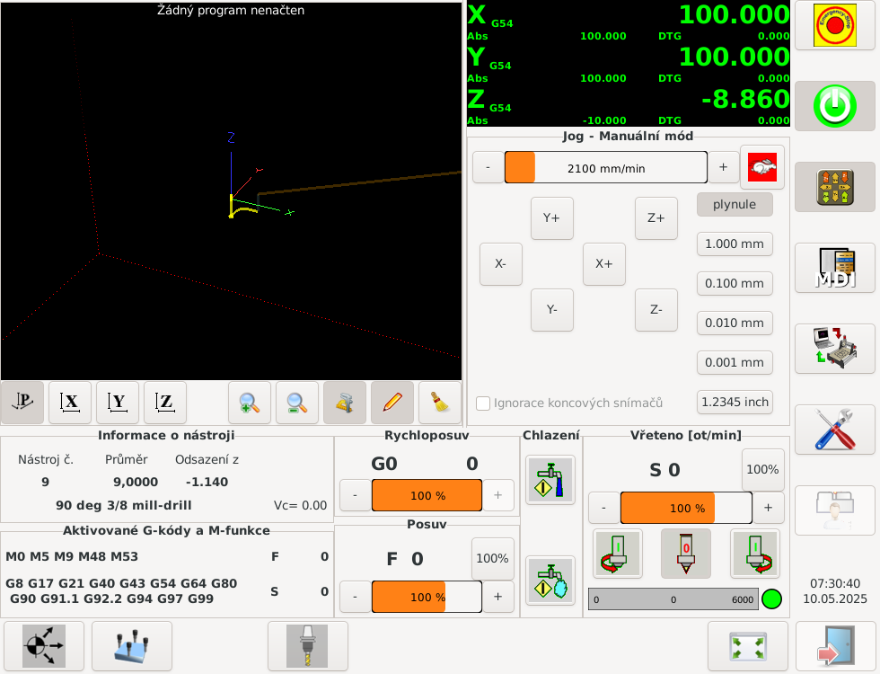

Leaving from TOOL page

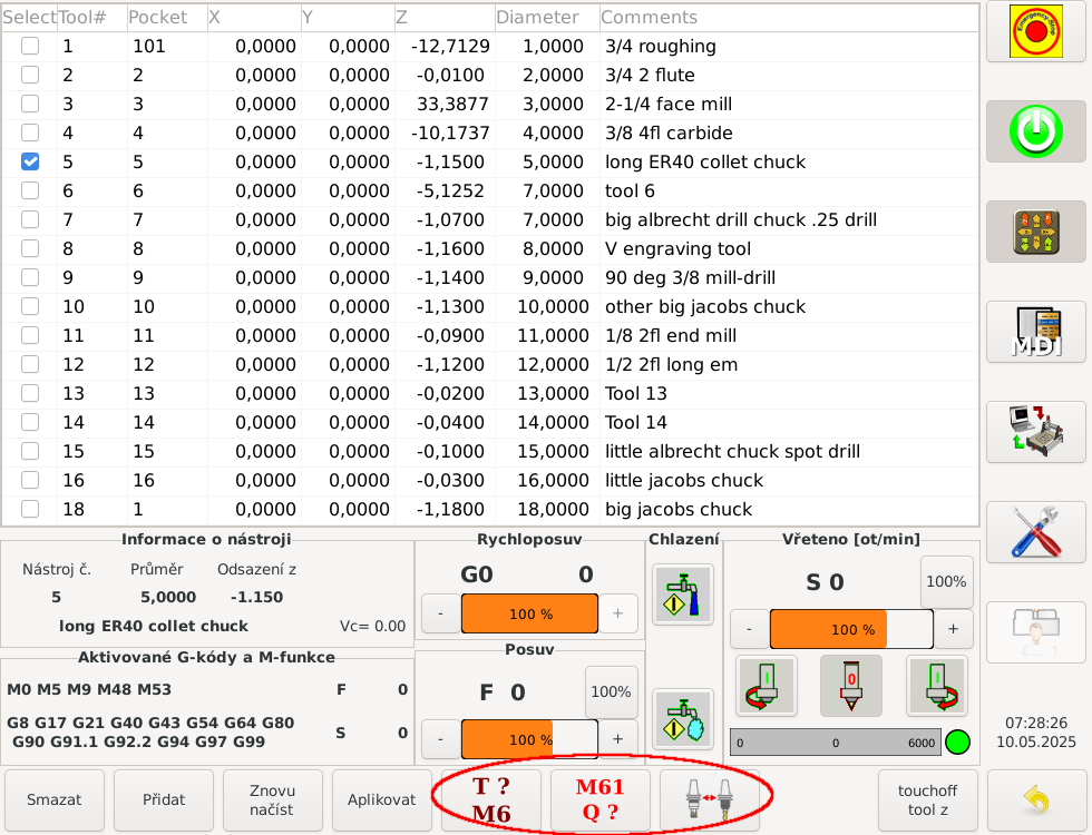

Replied by zz912 on topic Leaving from TOOL page
My English is bad. Could you explain your message easier?

Replied by Aciera on topic Leaving from TOOL page
I believe this is the intended behavior.
I would be interested in Norbert's opinion.

Replied by newbynobi on topic Leaving from TOOL page
Yes, that is a wanted behavior!
All the mentioned buttons leads to a tool change, so after that for sure you want to go on with your work, so why do you want to stay in tool table page?
Norbert
Norbert
Thanks for the answer.
I will respect that. It's just a matter of opinion.
I mostly work as an LCNC integrator, or teach someone. So I often need to switch between several tools and always have to go back.
Sometimes after using those three buttons I get stuck on the TOOL_PAGE page. Now I know that this is a bug. That's also why I opened this thread.
