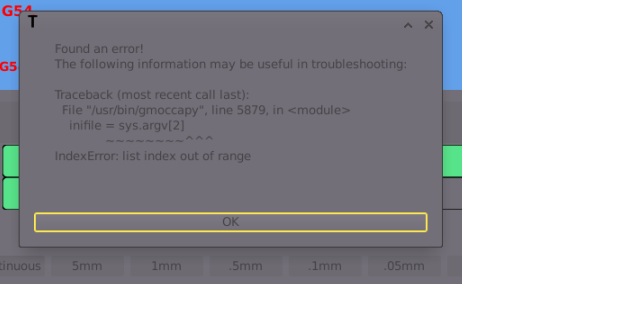

found an error
- Moutomation
- Posts: 154
- Thank you received: 11
07 Oct 2025 14:55 #336012
by Moutomation
found an error was created by Moutomation
- Moutomation
- Posts: 154
07 Oct 2025 15:27 #336016
by Moutomation
Replied by Moutomation on topic found an error
This error occurs when we select the automatic G code file at the first startup from the gmoccopy settings.
- Posts: 4819
- Thank you received: 2176
07 Oct 2025 16:13 #336023
Replied by Aciera on topic found an error
Are you using master? If so you might have to update as a fix for such an issue was merged here:
github.com/LinuxCNC/linuxcnc/pull/3516
- Moutomation
- Posts: 154
07 Oct 2025 16:24 #336026
by Moutomation
I use ethercat
- Moutomation
- Posts: 154
07 Oct 2025 16:43 #336031
by Moutomation
I am using pi5, I could not find this file python_plugin.cc
- Posts: 4819
07 Oct 2025 16:52 - 07 Oct 2025 17:01 #336032
I'm not familiar with pi installations but you could try these modifications to gmoccapy which also fixed the problem for me:
github.com/LinuxCNC/linuxcnc/pull/3511/files
[edit]
Without rebuilding you will need to modify 'gmoccapy' in the /bin folder.
[edit]
Last edit: 07 Oct 2025 17:01 by Aciera.
The following user(s) said Thank You: Moutomation
- Moutomation
- Posts: 154
07 Oct 2025 17:11 #336036
by Moutomation
self.logofile = str(args_passed[ index + 1 ]) gave an error on this line gmoccapy was not opened probably not a suitable solution for pi5
- Moutomation
- Posts: 154
07 Oct 2025 17:12 #336037
by Moutomation
Thanks for your reply. I guess I'll have to wait until a bug-free version is released.
