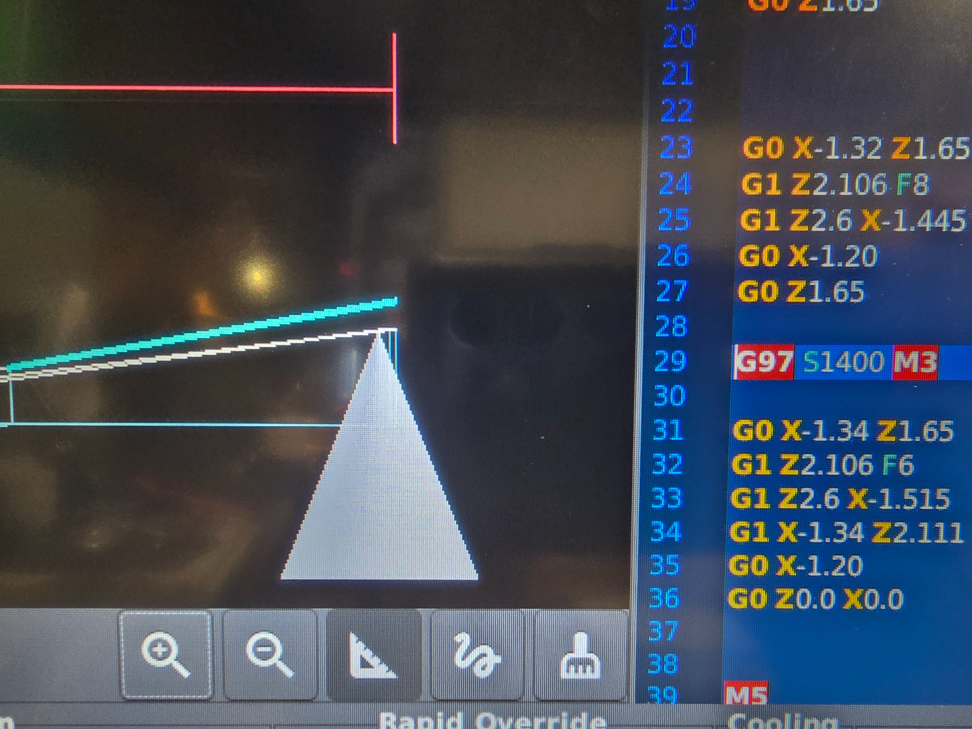

The is a minor thing that I hope is a simple fix.
The graphical display that follows the tool path is spot on with what the tool is doing. That's not a problem. What I noticed is the highlighted gcode shown isn't following the same position.
So if I tap a tool path line to highlight it in the grid of the graphic window it doesn't highlight that tool path in the gcode.
As you can see in the image I have the angled tool path highlighted which is supposed to be line 33, but in the gcode it's highlighting 29 which is the change in speed 5 lines prior.
A cursory search of the internet didn't reveal much other than recommendations to change g61,g64, but don't believe that has anything to do with this.
How do I correct this?
Thanks in advance.

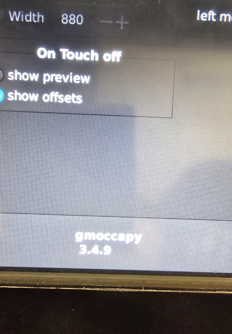

What user interface on screen?
It seems like GmoccaPy.
Upload a picture of the whole screen.
Replied by tommylight on topic Highlighted gcode doesn't follow current position.
That is most probably the kernel version, not the GUI.3.4.9

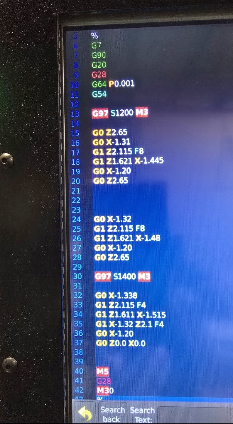

Also, please post the gcode

30 Jul 2026 17:53 #348228
by TheTinkeringMechanic1
Replied by TheTinkeringMechanic1 on topic Highlighted gcode doesn't follow current position.
This is it.
Thank you for reporting back.After posting that image of the g code I believe I see it now. The % symbol is on line 5. So that would explain everything being off set considering the line is starting at 1...
I knew it had to have been something silly.
Update: That was it....
