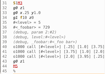

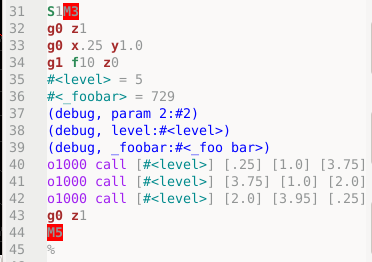

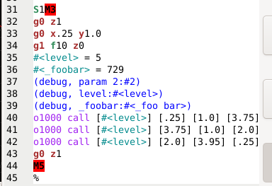

Well, I started configuring the milling machine with xyzab_tdr_kins kinematics (five-axis with switchable mode).
And I see something like this:
This is the code M428, not M4 28 (!!!)
I started searching and found nothing. As if the authors wanted to keep it a secret... But after some time I came to some conclusions.
The default Gmoccapy setting looks like this:
And it works like this:
The second image is in program execution mode. Why the hell do the parameters change from black to gray, I'll probably never know, I assume the "artist" who came up with it liked it so much...
I haven't found the file responsible for this display parameters anywhere, I must have been looking in the wrong place or wrong name, but I shouldn't be looking for it at all, because it should be in the documentation.
I found the gcode.lang file, which is probably the only one existing in LinuxCNC sources. If this is indeed the case, it is also the only file on which the authors of LinuxCNC as the only ones have influence and no one will mess anything up without their consent and knowledge. And if this is the case, why is the default g-code theme set to "classic" and not "gcode"?
As for the gcode.lang file, it is far from perfect, but it is there, so it can be improved. First of all, the user can map any g- or m-code using REMAP in the ini file and this must be kept in mind when creating matching patterns.
My suggestion is to work on the gcode.lang file and set it as the default one.

What of the classic G-code theme do you dislike in detail?
Replied by HansU on topic Themes
I wouldn't call an incorrect syntax highlighting a serious problem =)But today a serious problem arose and I had to look into it
It's because editing is disabled while the program is running.The second image is in program execution mode. Why the hell do the parameters change from black to gray,
