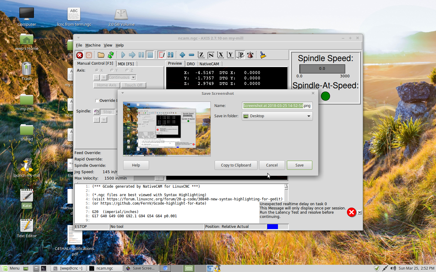

Hello,
I keep getting this error message when starting linuxcnc. Start from terminal attached with a screen shot of linuxcnc.
As always thanks for any and all help.
Bill

Hi Todd and thank you for the reply. I should have been more specific. This is the error which is the thorn in my side.
/usr/share/linuxcnc/aux_gladevcp/NativeCAM/ncam.py:2644: GtkWarning: IA__gtk_accel_label_set_accel_closure: assertion 'gtk_accel_group_from_accel_closure (accel_closure) != NULL' failed
mi = _action.create_menu_item()
It comes from starting linuxcnc from the terminal.
The realtime error happens no matter what I set the latency at. Once closed it doesn't seem to bother anything. In nativecam some subroutines work and others don't. Just trying to get things tuned so everything works as it should. Also my screen shot was not what I intended. My apologies.
I have deleted the custompanel.xml and the custompostgui.hal files and still experience the same error messge posted above. I'm stumped. Any Ideas?
Bill
