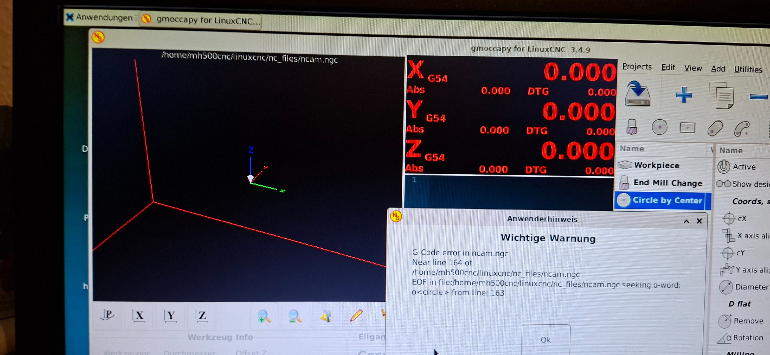

03 Mar 2026 09:33 #343778
by T_D
Replied by T_D on topic Probleme mit NativeCam
This is what i see and where the problem code accurs , could be something Wrangler with my linuxcnc or Couleur you give me some advise ?

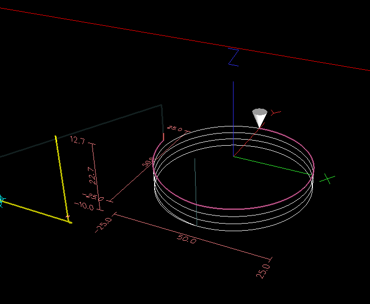

03 Mar 2026 09:52 - 03 Mar 2026 09:53 #343780
by Giovanni
Replied by Giovanni on topic Probleme mit NativeCam
It seems that's a missing piece at the end of the file.
Let's try the attached ngc file.
Load in LinuxCNC and see if it works.
It has been generated using your ncam xml project.
Maybe you could compare it with the file which gives you the error.
Regards
Giovanni
