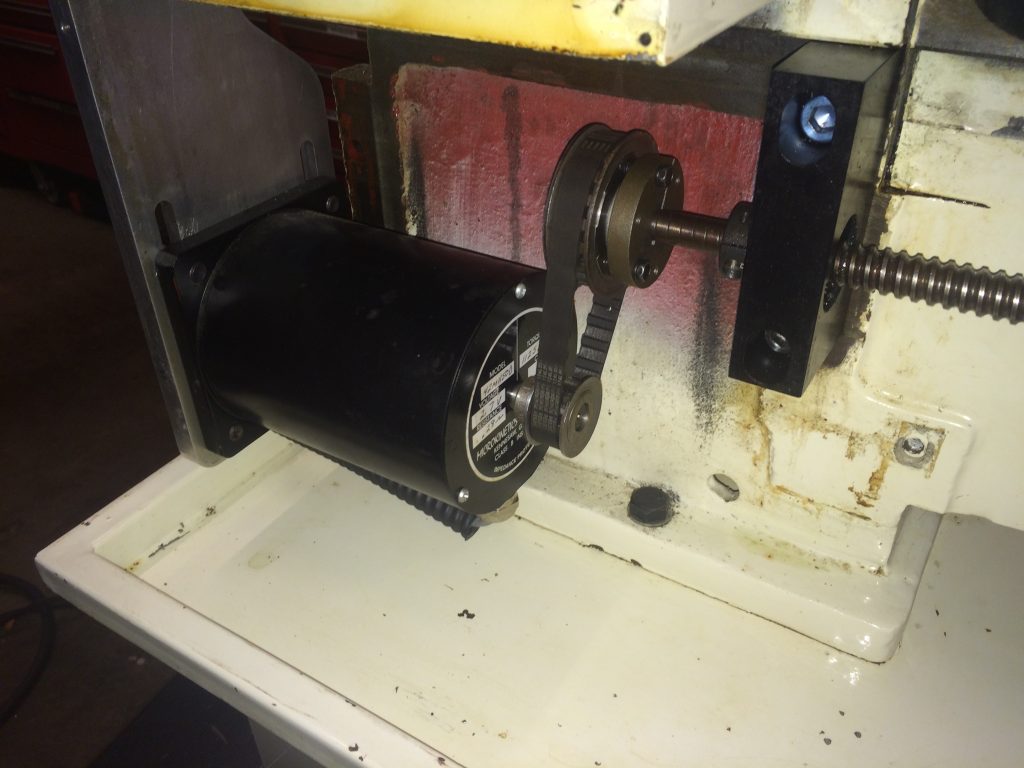

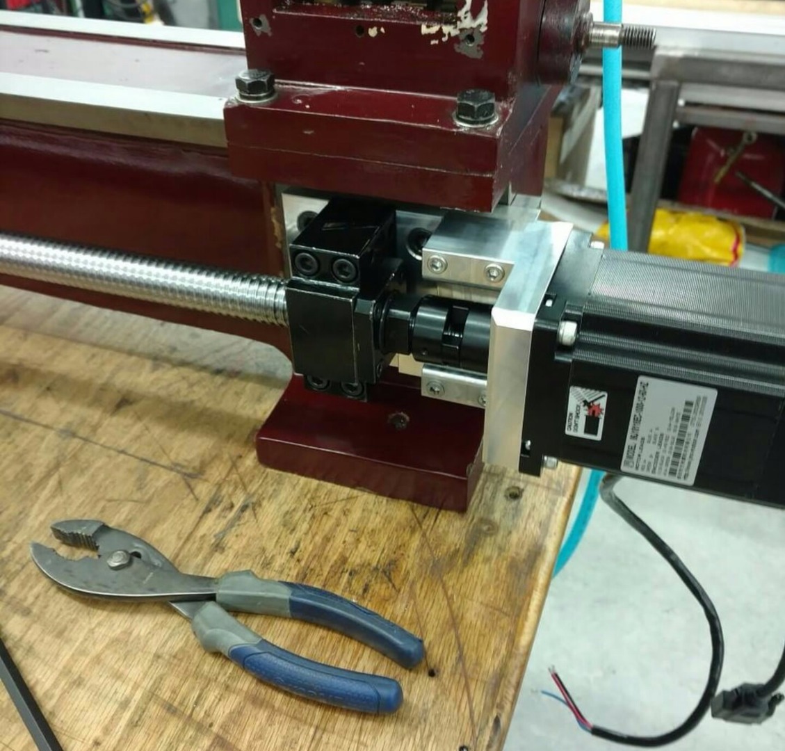

05 Nov 2016 03:07 - 05 Nov 2016 03:29 #82477 by Rhine_Labs
Replied by Rhine_Labs on topic Path Pilot Configs 5i25/7i76
12X36
Z is I think 1,600oz and X is 400oz
How the Z Stepper is Mounted.
Data Sheet On Z Motor Looked for replacements other than the retro kit Nema 42 Dual Shaft is hard to find that long.
How the X Stepper is Mounted
Data Sheet On X Motor
Last edit: 05 Nov 2016 03:29 by Rhine_Labs.

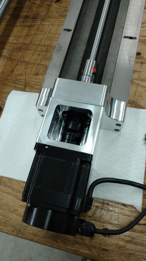

05 Nov 2016 03:12 #82478 by Lcvette
Replied by Lcvette on topic Path Pilot Configs 5i25/7i76
Have pictures of the motor setups on the machine? Those are fairly small motors for their frame size, I have Nena 34 1200ozin for my Z and 640ozin nema34 on X, (to keep it short rather than really long and skinny). Guessing you were after the same thing?

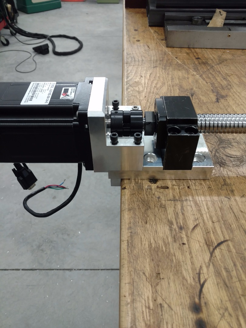

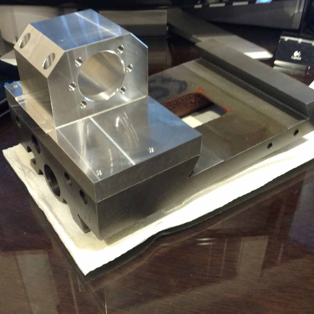

05 Nov 2016 04:04 #82481 by Lcvette
I had to design my own kit as there wasn't one that I found available, but it is similar except I direct drive both my axis. I have attached some pictures. I bet the z axis could be made similar to avoid the need for such a specialized motor like you have had to use. Some pictures below.

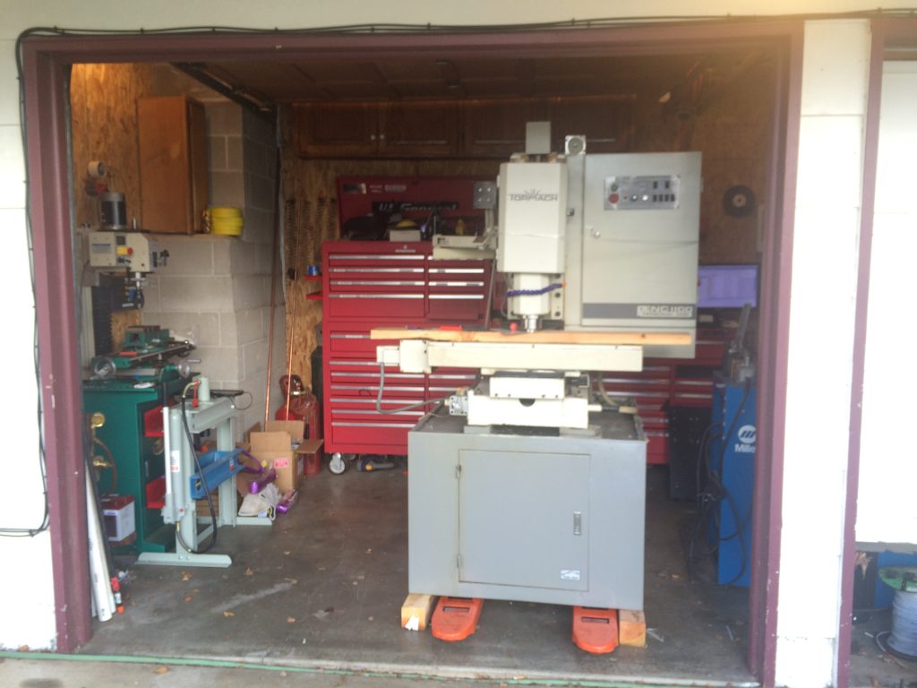

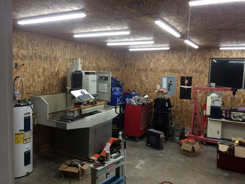

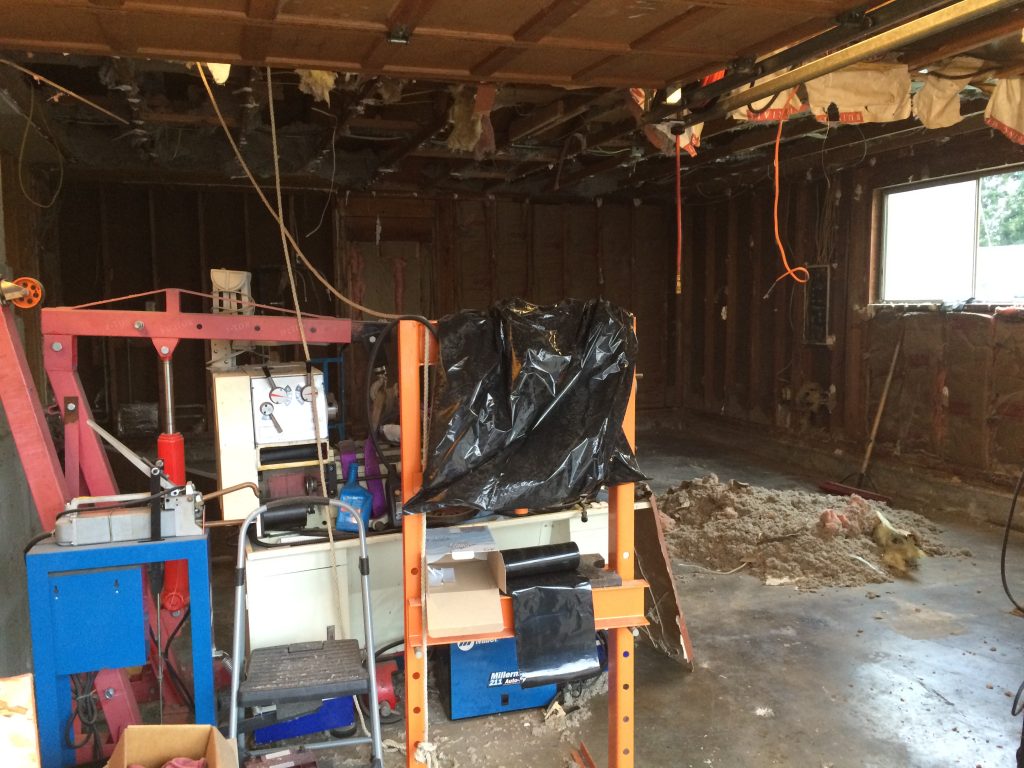

09 Apr 2017 17:33 - 09 Apr 2017 17:46 #91090 by Rhine_Labs
Still Keeping the Lathe I took a Break from it due to a PCNC 1100 Arrival and Construction (Expanding Garage) Still Waiting on Cabinetry... Have the lighting installed 15 LED Fixtures. I gave in to temptation and booted up the 1100 and had to draw my name with a sharpie...
