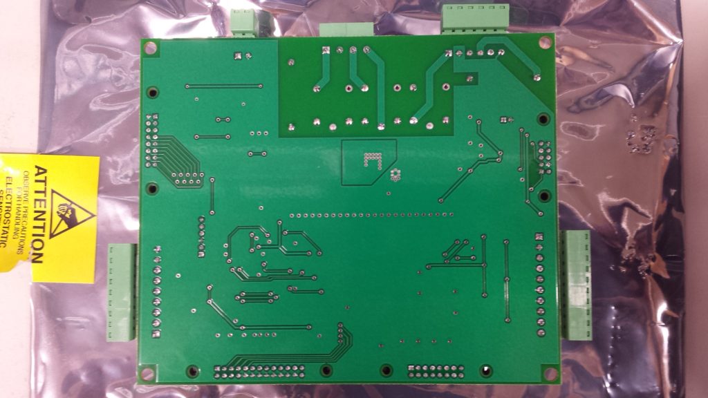

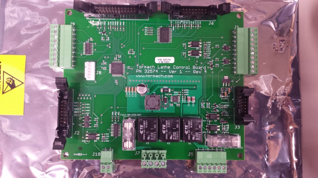

Yea, I am done fighting it on my lathe... I was some how able to obtain a Tormach Lathe Breakout Board!
In theory I should be able to just edit the INI file to my hardware and limit specs and be done making the updates rather painless.
Tormach Seems to be using the PIC16F1947 to handle the limit switches and tool change and a few other functions.

But now you will be limited to all the problems the slant has. I have to ask... what did that run you and how did you get them to sell you one?

Well you are limited to steppers, tool changer is good for their design and wont really translate over well. Limits / home are on the same pin (no encoders including index home). Debounce required due to electrical noise issues. Just a few off the top of my head. Then if you wanna add stuff like a real cycle start button and feed hold and maybe a MPG you are still modding the files anyways.

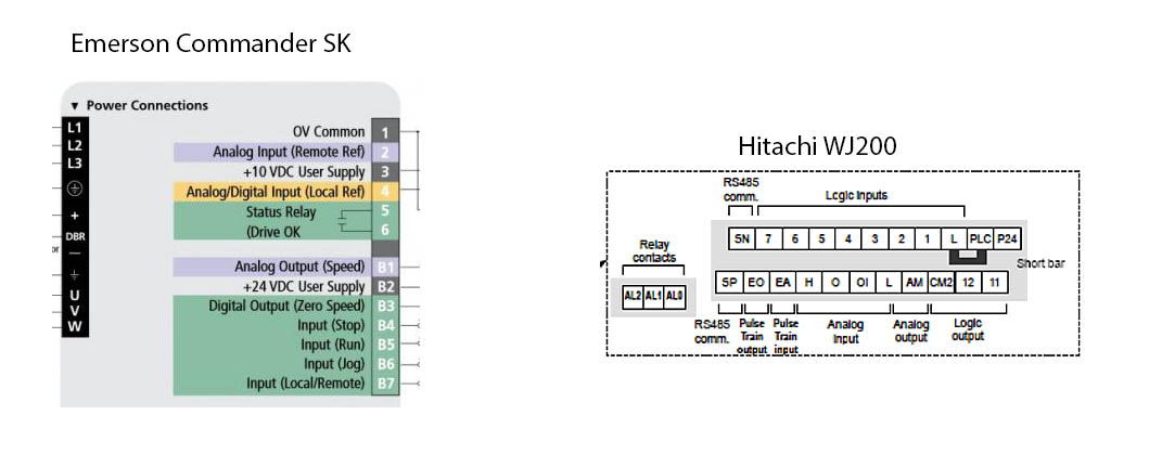

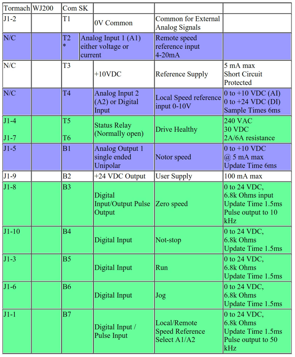

Right now I am on big pharma due to surgery (cut my bacon) prob another 2 or 3 weeks and I cannot think well/clear enough on on the VFD crossover wiring ie going from the Emerson SK to the WJ200.
I made a Post on my blog Prior to going to the meat mechanic, But I will ask here. Maybe get someone to lend a helping hand. I do get a few hours of somewhat of a clear head and could prob get it wired and some programmign done and tested. Otherwise I am at another stand still for a few more weeks.
Any help would be grateful.

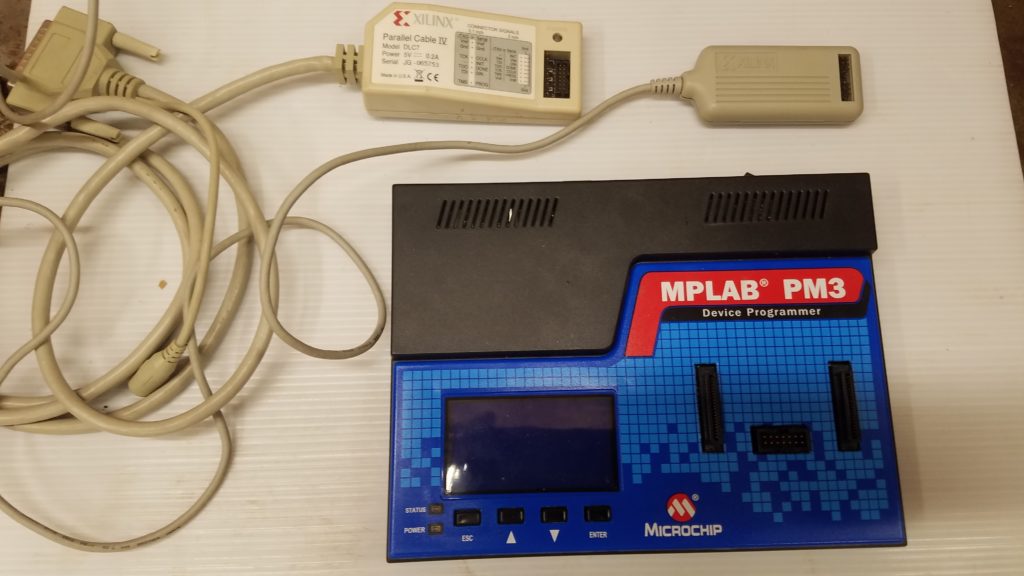

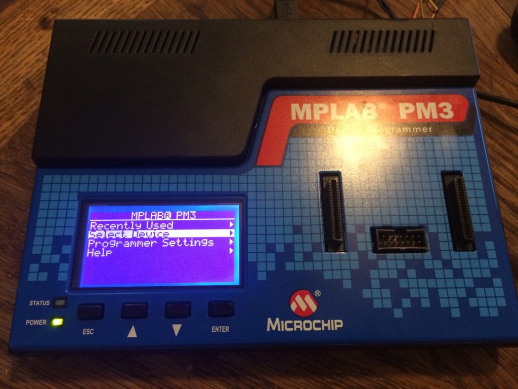

smgvbest did you get my private e-mail i sent you? With this
This Link
? Xilinx most users can do with a basic JTAG and an LPT Port.
I have.. a Couple J-Tag Readers + PIC.. Only reason i keep an old P4 pc with a LPT port around.
I am not going to try an plug in to J8 dump the 16F1947 on the t-bob till I get it up 100% and if it is not read protected not sure if I would release the code as I have significant time and monetary investment in this board and obtaining it.
+ Cannot find the power supply for the PIC reader had to jump it form a ATX power supply for the photos.
